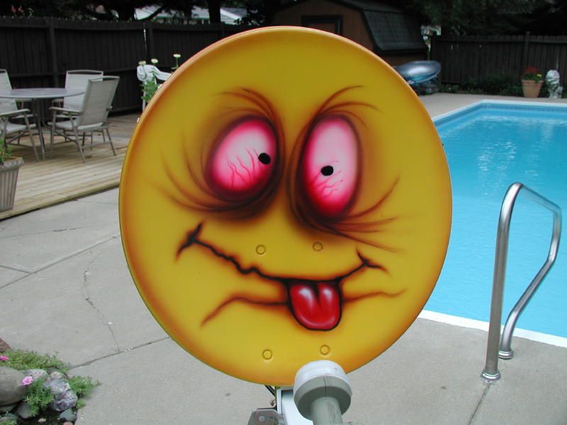

Go for it !! :D

If you do put on some unusual color or artwork like Doug did above, and use glossy paints,...
Just do a final layer of flat clear, and you'll be good to go.
