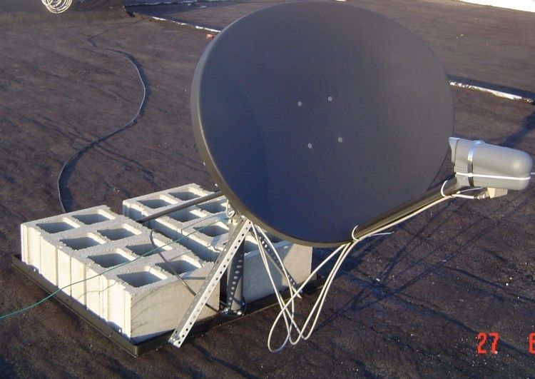

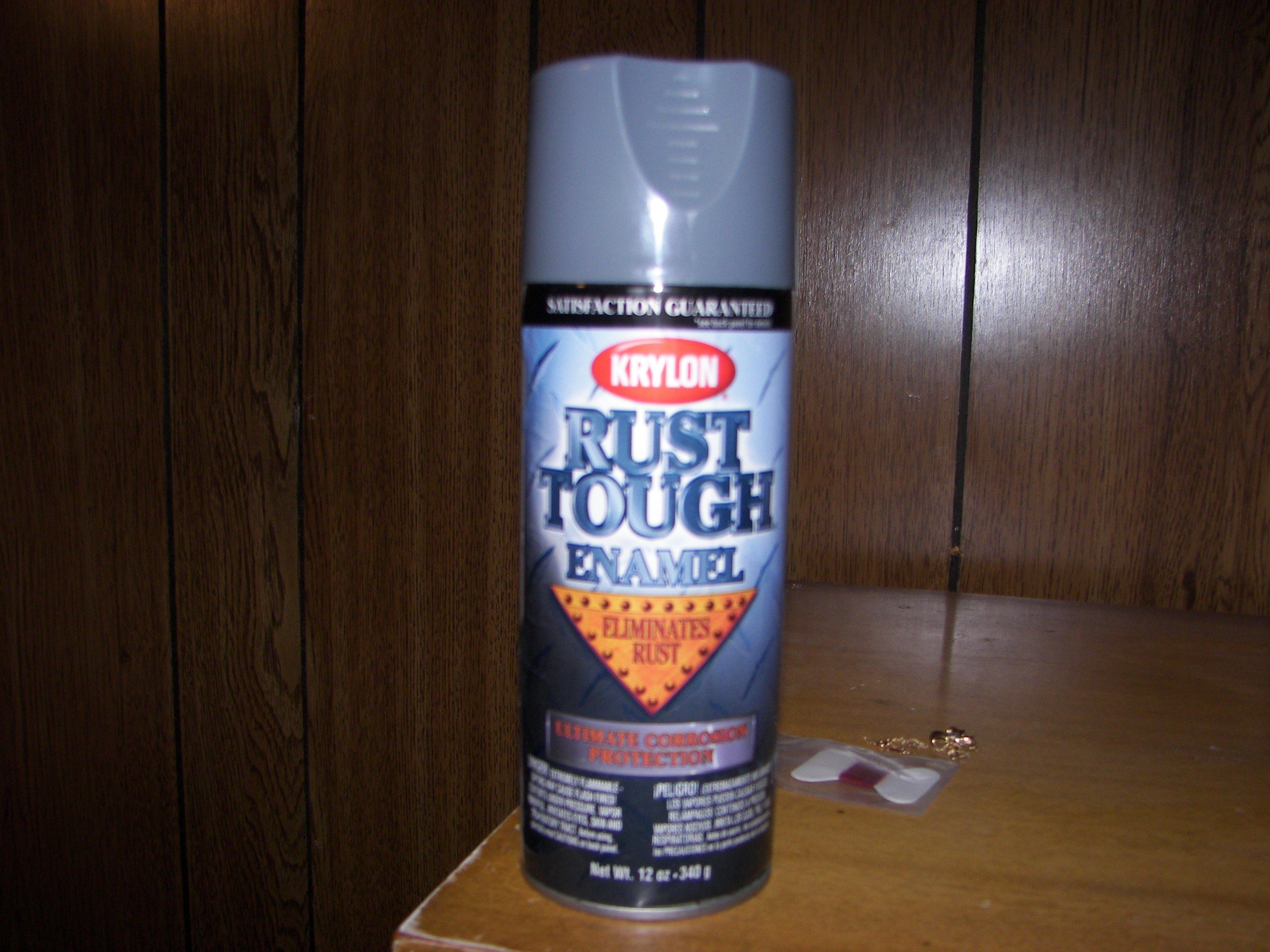

The one I used for my Primestar is a dead ringer for the original color(although my avatar pic doesnt do it justice because of direct sunlight), Krylon Battleship Gray. I found mine online.
