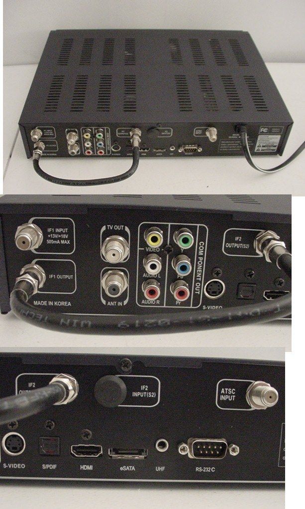

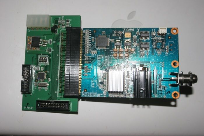

I bought a used Pansat 9200 HD and it came with this S2 card installed. Here are photos. I can not get it to work connected like it is shown as it came. So I replaced it with a Pansat card that I have and everything is fine.. I have never seen this double tiered card before. Anyone seen this before?
The jumper cable is hooked up output to output..There is no Input on the card...
I want to know if this card can work or should I toss it? Thanks for your help in advance.

Yes, thats the old illuminatti Turbo 8psk used to hack HD channels from Charlie. Not use at all on true FTA. This module make works the Pansat real hot. Once you remove it you will see the unit working in a normal temperature. Here is a pic of the real DVB-S2 from Pansat. By the way still real expensives!!

Thanks Magic and Carlos. I googled turbo 8psk and it showed the blue card is the Turbo..
I found another one on my shelf from like 2007 or 8 maybe for a Viewsat? can't remember, and it was similar just the left coax single output only..
Anyway, it is the turbo card for sure and not useful for my set..

Even if it was the right card for true fta, it won't work with the output connected to another output.
