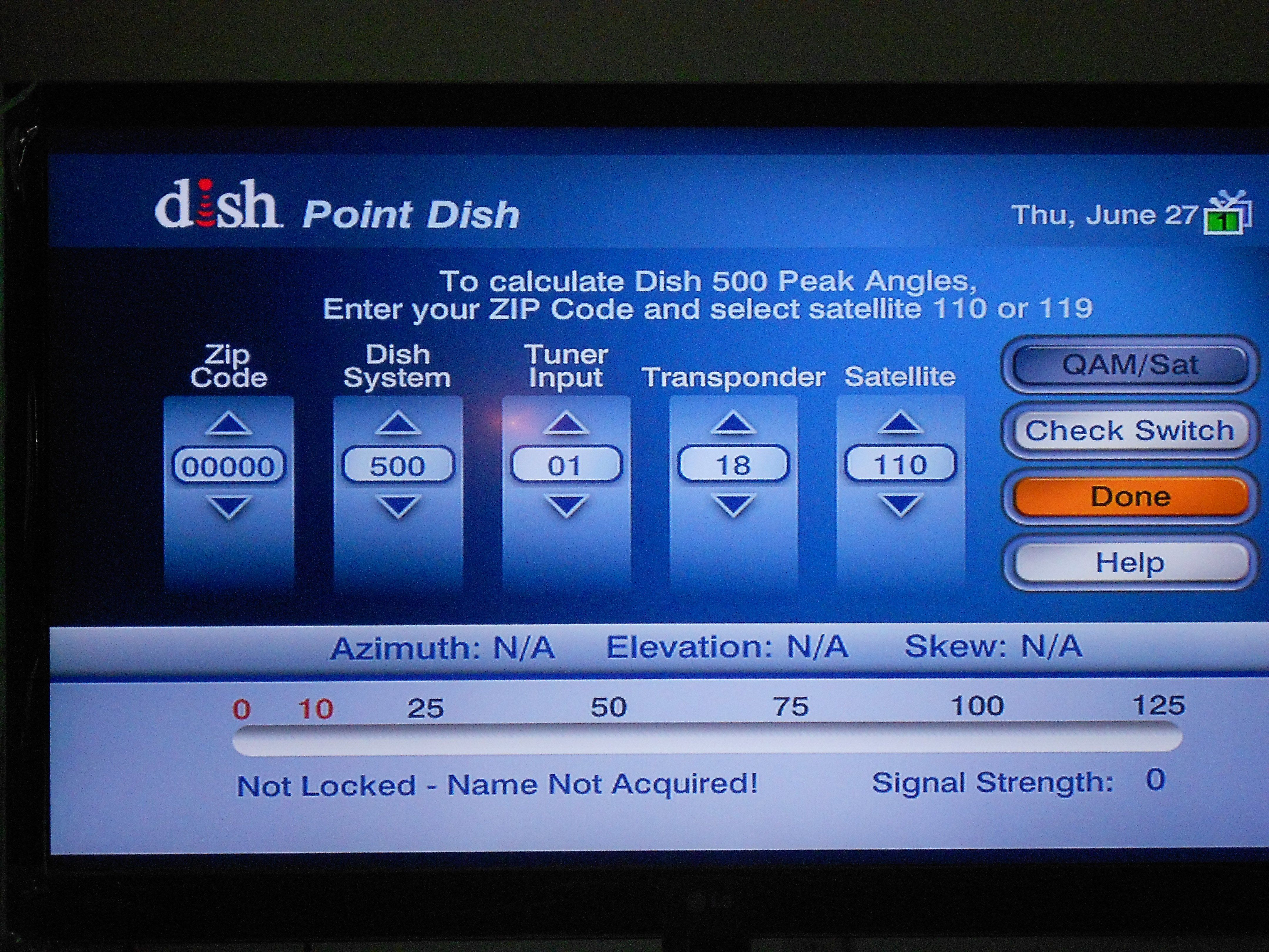

Yeah for some reason, even when the locals were working correctly, I could never get the signal meter to work on them. I would do Menu 6-1-1 and it wouldn't return any signal strength. Like it would say at "0" but I know that isn't the case because the locals worked fine on my TV.
You would need to check the signal strength on the 110 Satellite Transponder 18, as that is where your HD locals are. Please let us know, thank you!
Yeah I still get 0 for signal strength for this and it won't lock on.
But it was like that when my locals worked fine so I thought that was normal.

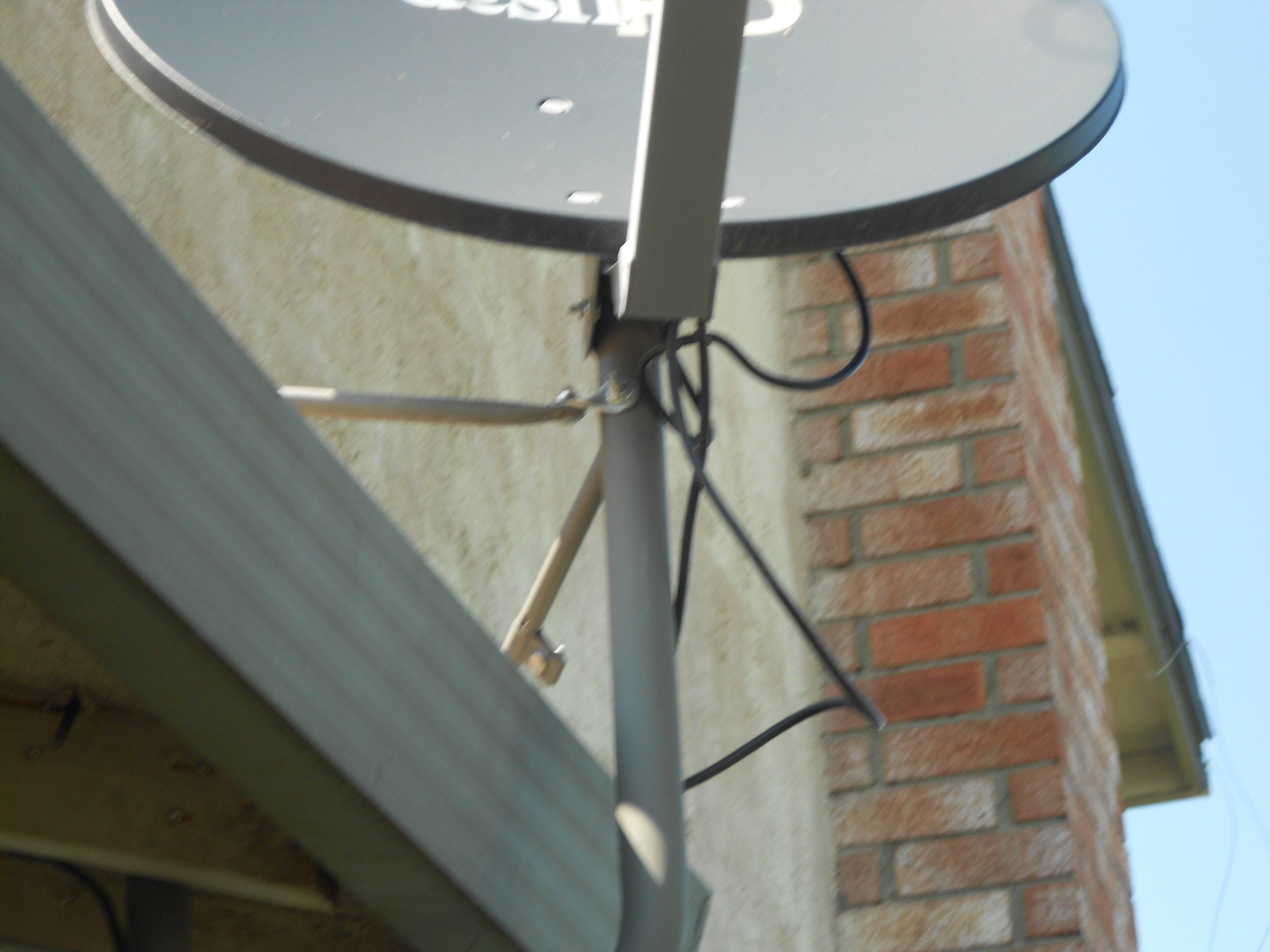

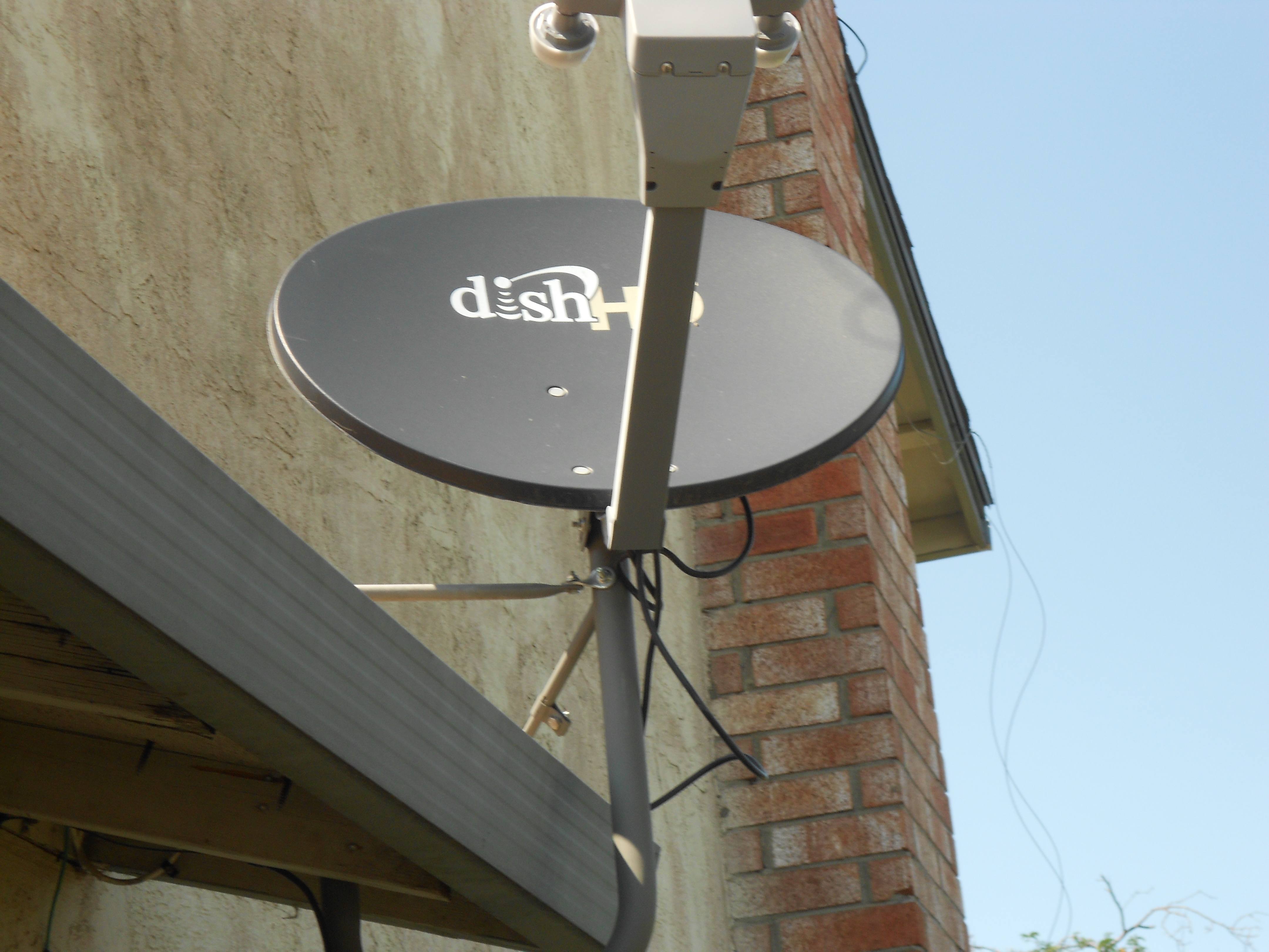

Anyways, first things first, I just noticed the technician who replaced the LNBF left these 2 black wires hanging around the dish:
I didn't notice them before. I think they were tucked in somewhere before. What do you guys think? Is that okay, that those wires are out like that?
Whenever you're on a local press MENU - 6 - 1 - 1 and it will tell you which sat and TP your local is on. It'll also tell you your signal strength for the channel.
Not sure what's going on with the cables from that angle, but most dishes typically have two cables coming from the dish for 1-2 dual-tuner installations. Other than looking messy, as long as the cables are in good shape it shouldn't be an issue.

I tried this when I'm having the signal loss problems. I tried transponder 14 on the 110 and I noticed the signal strength fluctuates from 70 to 30.

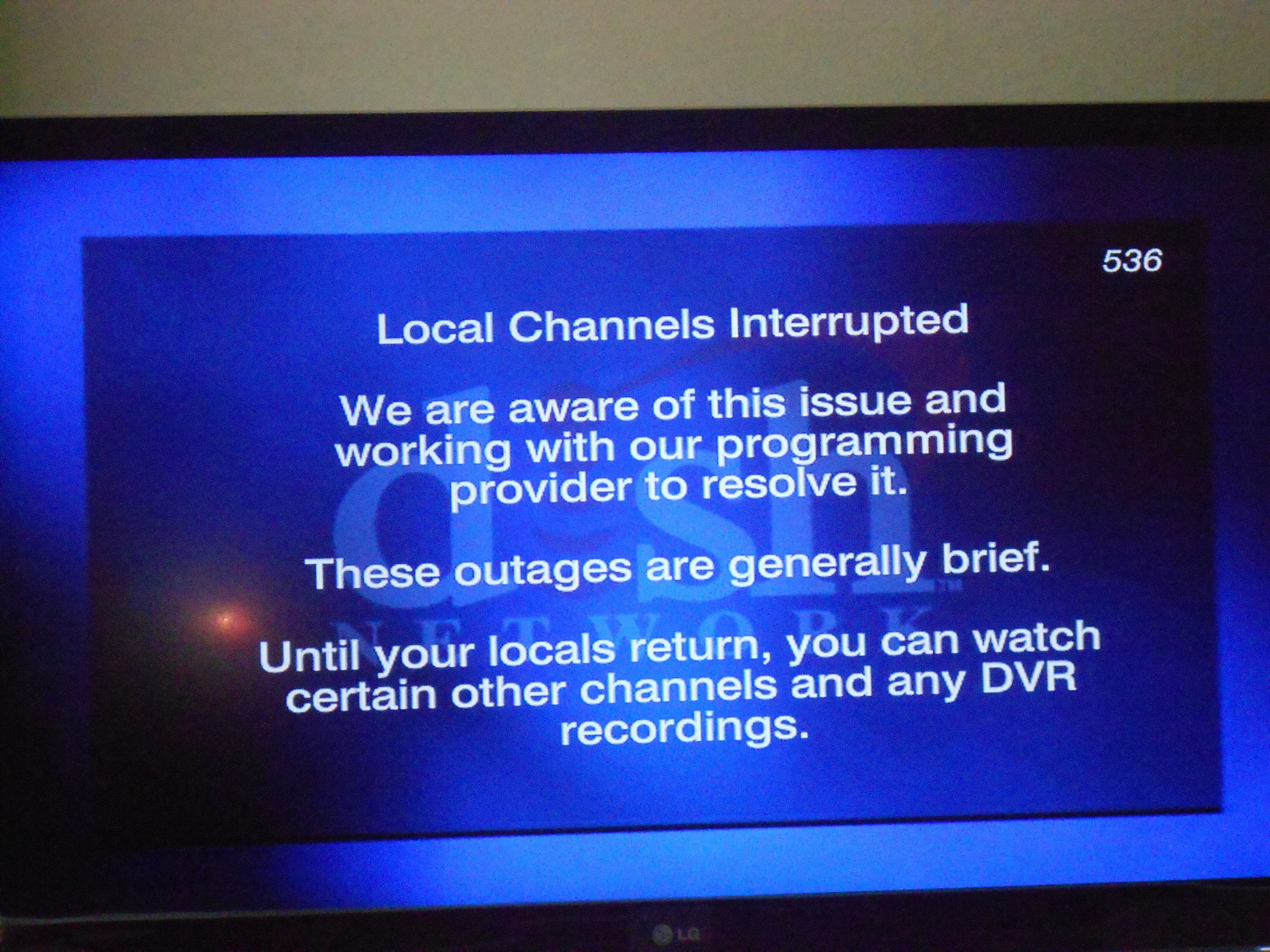

Also I get this message a lot when I'm in live TV:
[TABLE="width: 100%"]
[TR]
[TD]I used to think that's true and Dish Network knew about the problem, that's why I waited so long before getting help. But Mary looked into it and said nothing's wrong on their end.[/TD]
