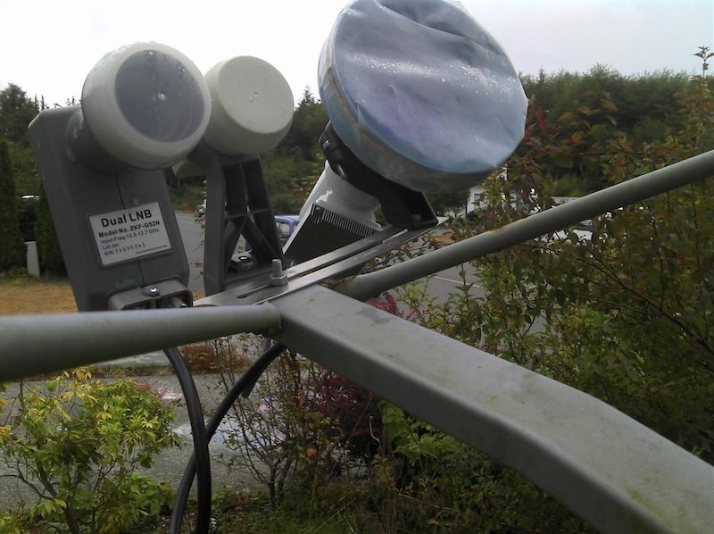

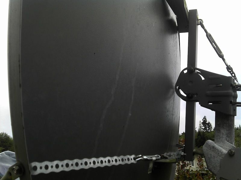

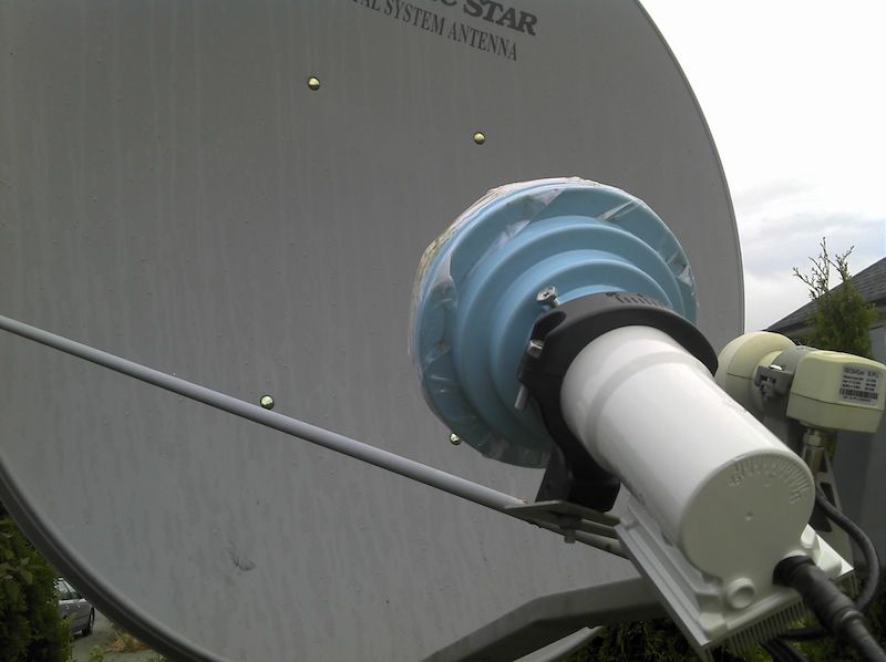

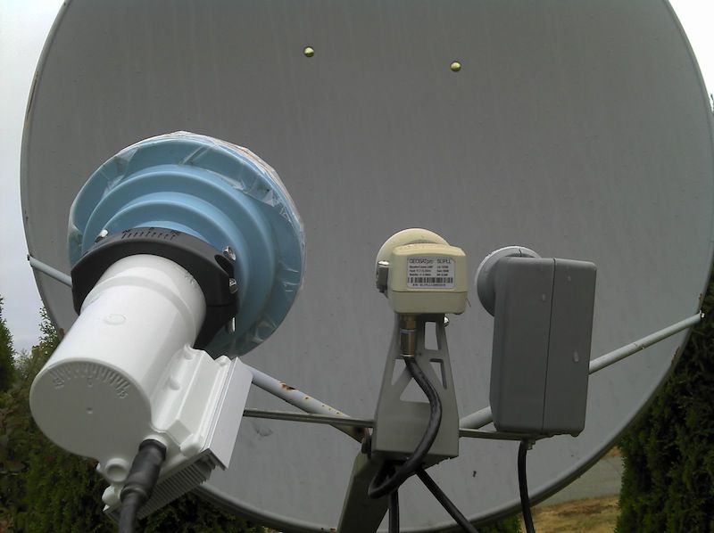

Here are a couple of pics I took this morning. I am about to change my Ku SL1PLL to a SL2PLL today.
Pacific rim nice job on that setup I get about the same results or a little bit more. 99w has the best signal c band also use a butter lid for your scaler.
I had a margarine lid on it originally but wanted a clear view of condensation if there was any - which I've never seen.

Thanks Ray. It is motorized with a STAB HH120, but in those pics I was pointed to my due south at 125w on the Linear Ku. Yes, the Cband is a sidecar as is the Circular Ku on the other side.
The Cband sidecar is my longitude +8 degrees and the Circular Ku is -5 degrees. I found that the Cband made no difference as a sidecar whereas the Linear Ku really performed best in the centre. Circular Ku is also super strong as a sidecar, but I don't get any FTA channels except a few barkers.
Having 3 LNBs on the Fortec 1.2m has me thankful that I put the horizontal strapping and turnbuckles across the back to reinforce the strength of the sidearms. Previously it was sagging from its own weight.
