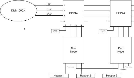

This problem started after I just recently changed from 2 Hoppers & 2 Joeys to 3 Hoppers & 1 Joey. I added 2 DPP44s and another Duo Node. My 1 unused client port and 1 unused host port are terminated. I wanted to check for ideas before I start looking at everything. Is grounding all the DPP44s and Duo Nodes together and to a building ground necessary? I can do that fairly easily. My only ground currently is a ground block outside. The only thing I've eliminated so far is it's happening off both Duo Nodes, so I believe it has to be the first DPP44 if it's not a grounding issue. Running a status check immediately after rebooting looks good. I do have a spare DPP44 but not a spare power inserter. All connections are tight. Hope someone has some ideas as I'm losing man points here.

Can you show us a diagram of how everything is connected? It very well may be the DPP44 Switch power supply. Also, and this is just from memory from quite awhile ago, make sure the 44 power coax is plugged into the 1st port.
Chad, here's a quick diagram. All the coax is 3GHz. Only the 10 coax jumpers in the closet are new
