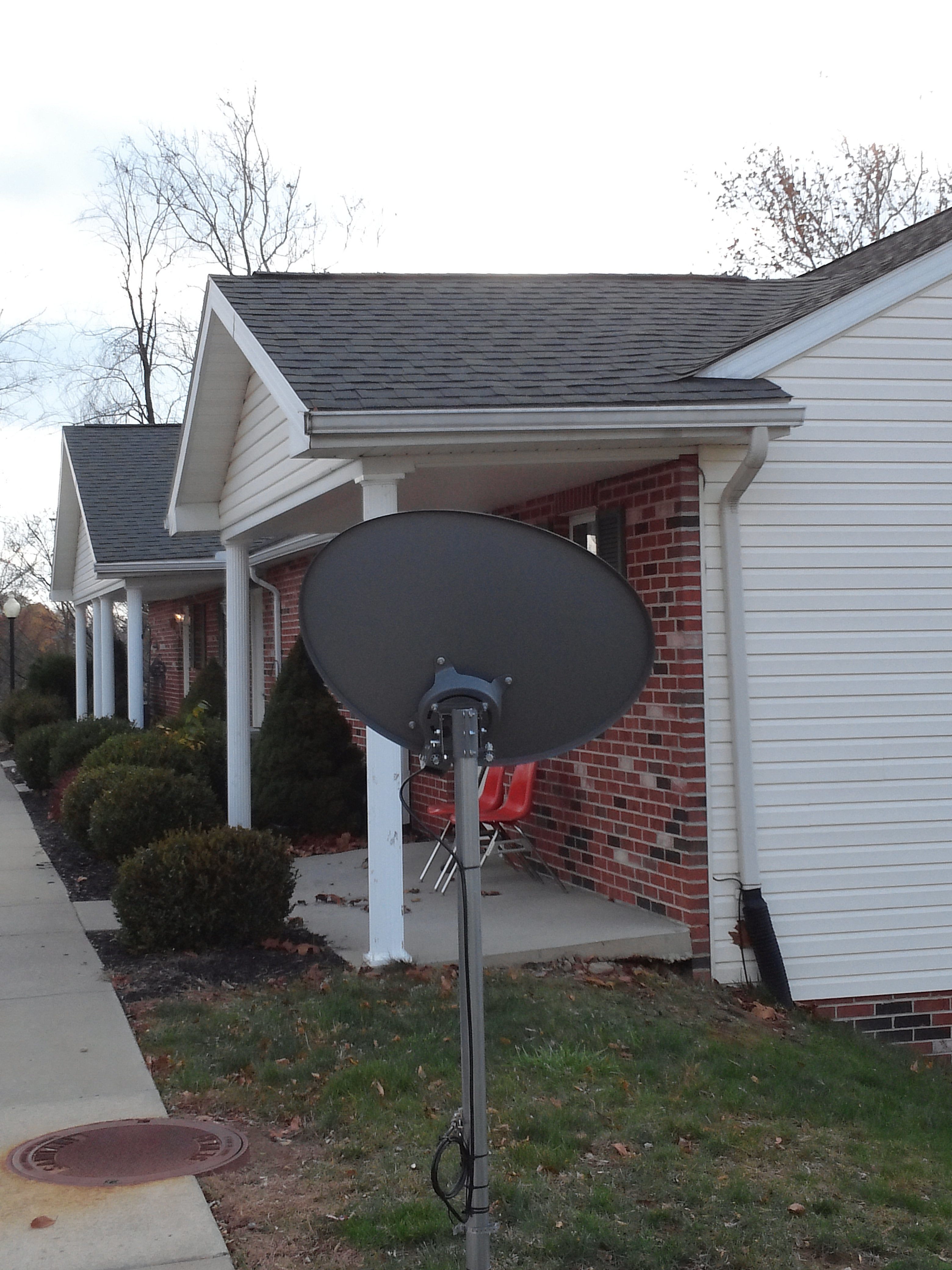

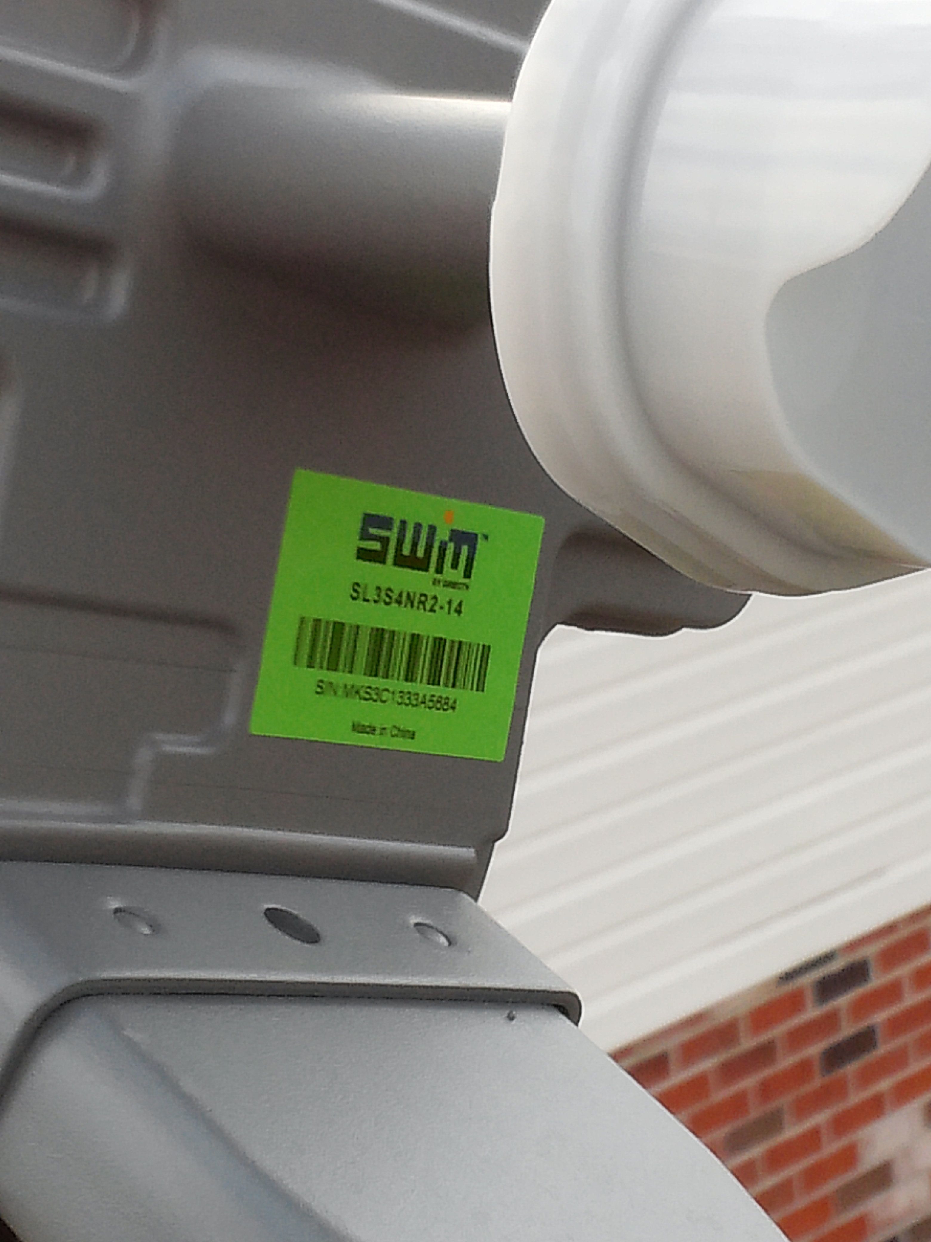

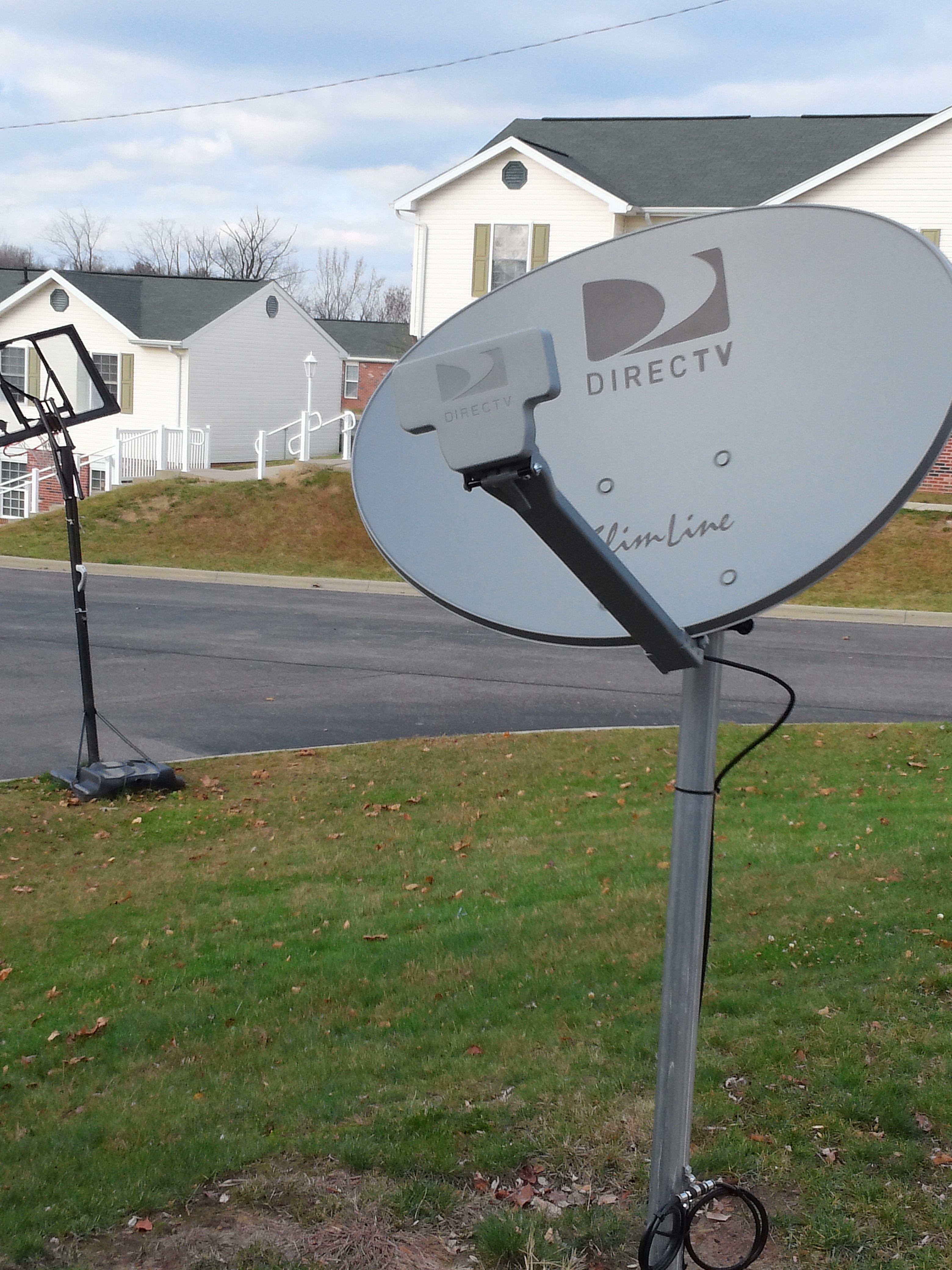

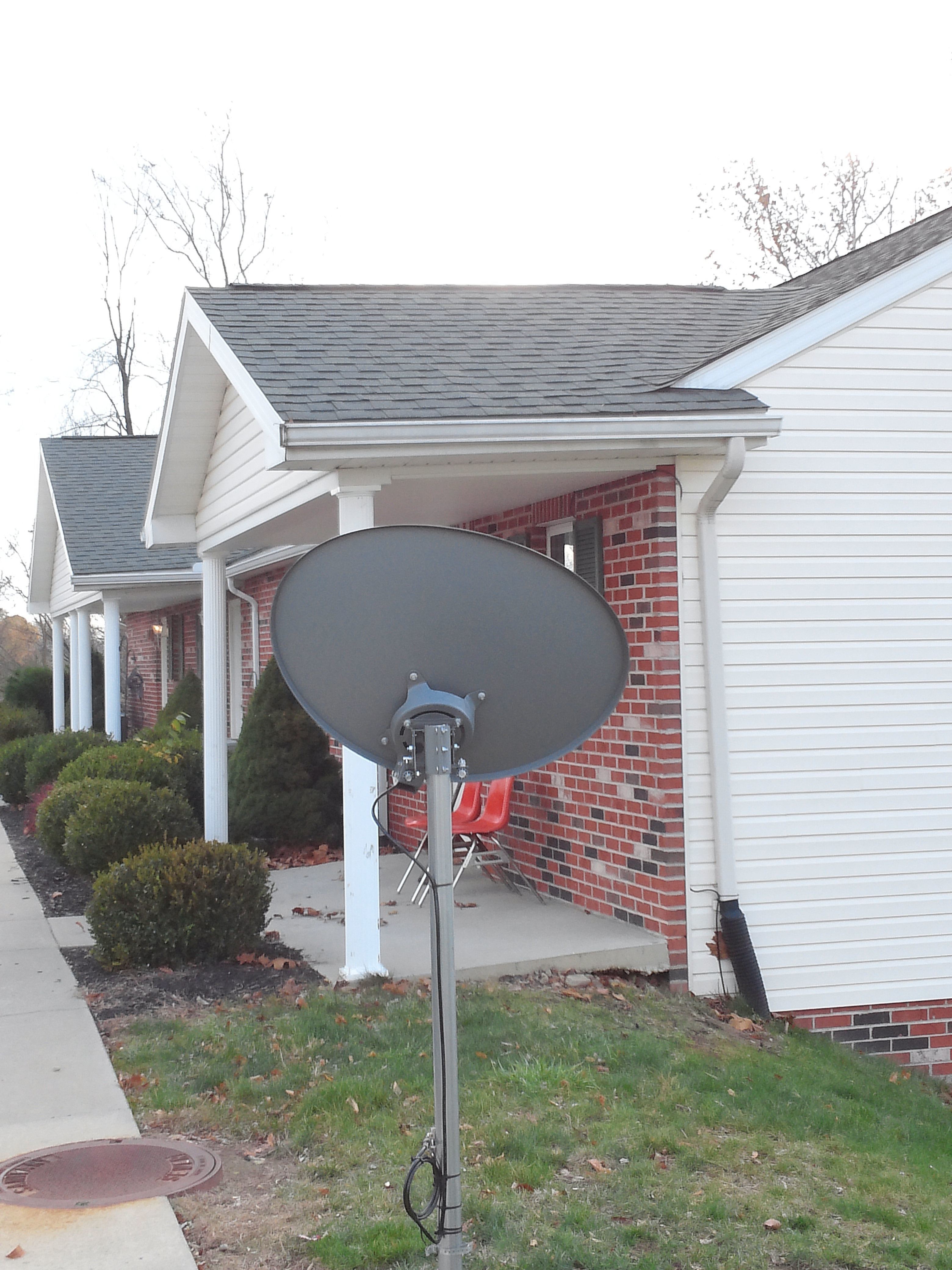

here are some pictures of my setup of my dish.

Your signal strengths are as good as they can reasonably be. Your dish is aligned beautifully. You may have an intermittently bad lnb, or maybe the receiver/dvr is sketchy.
Mikedz4, what is your zip code or physical city & state? We have mine in he most optimal location, that all birds are in clear line of site, with how y dish is mounted.
When we had that massive front roll in from Kansas City, into Central IL., the numbers for mine dropped down into the thirties across the board. My numbers are like yours 99.99% of the time.
