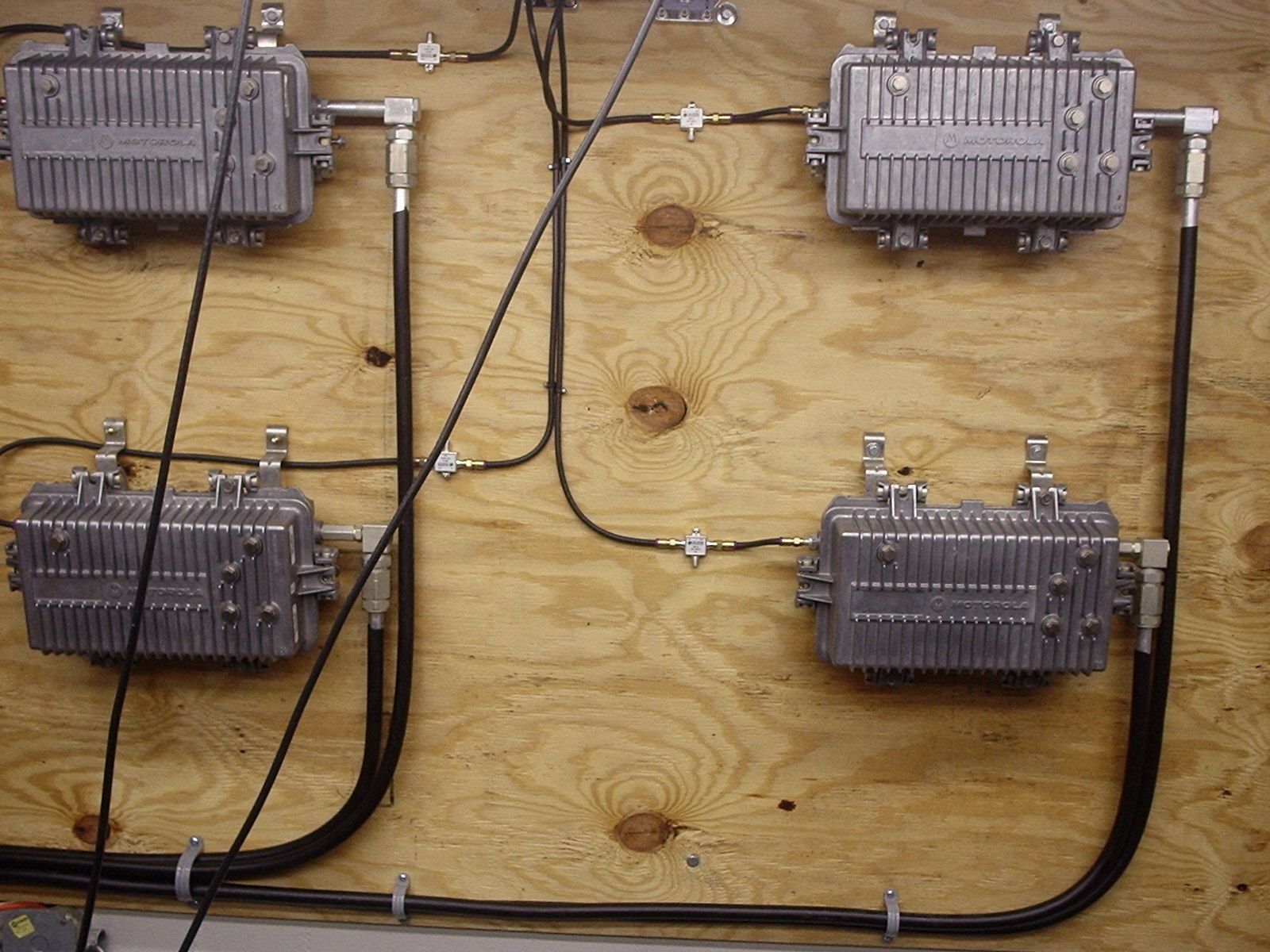

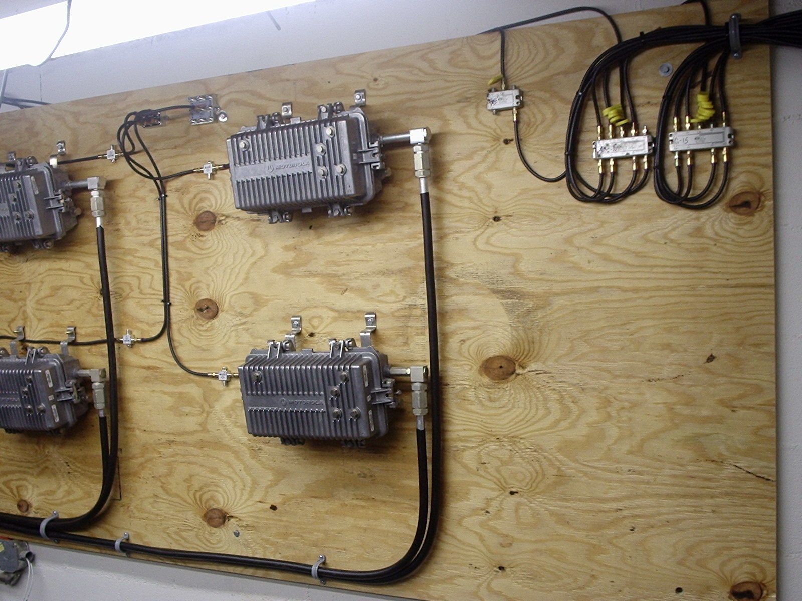

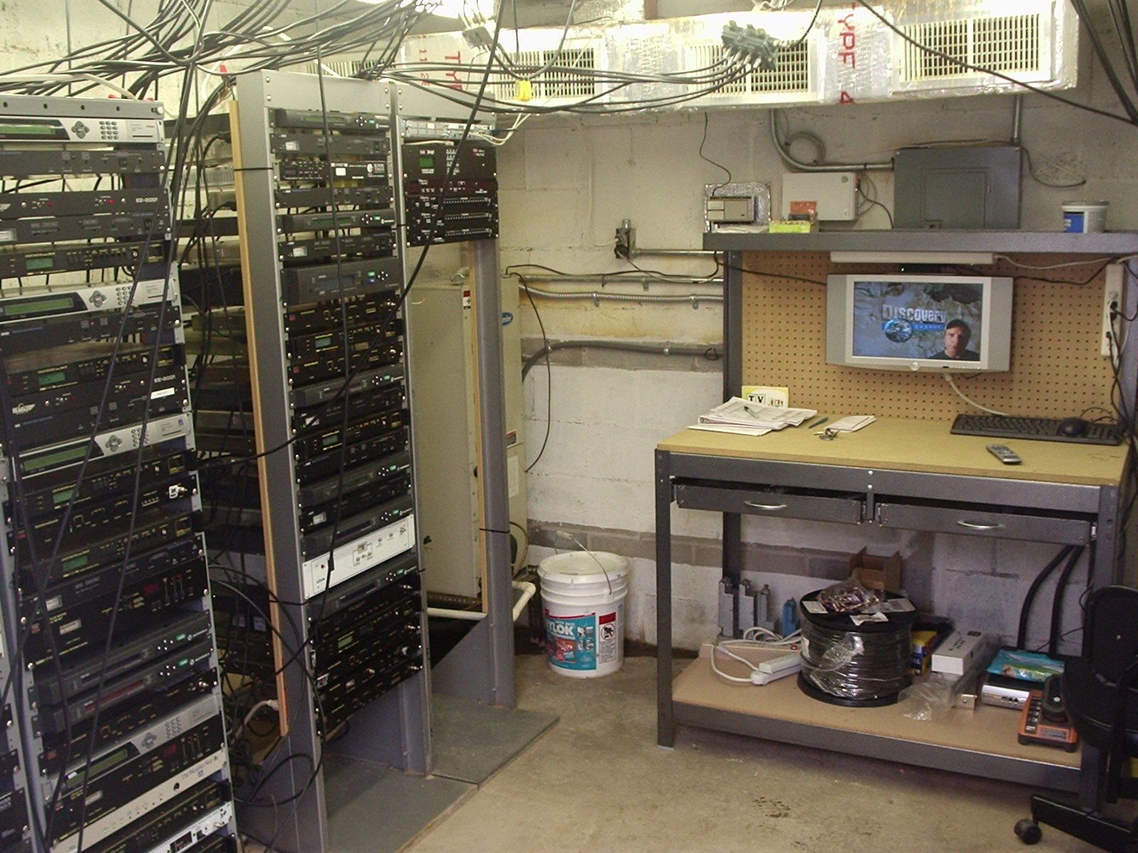

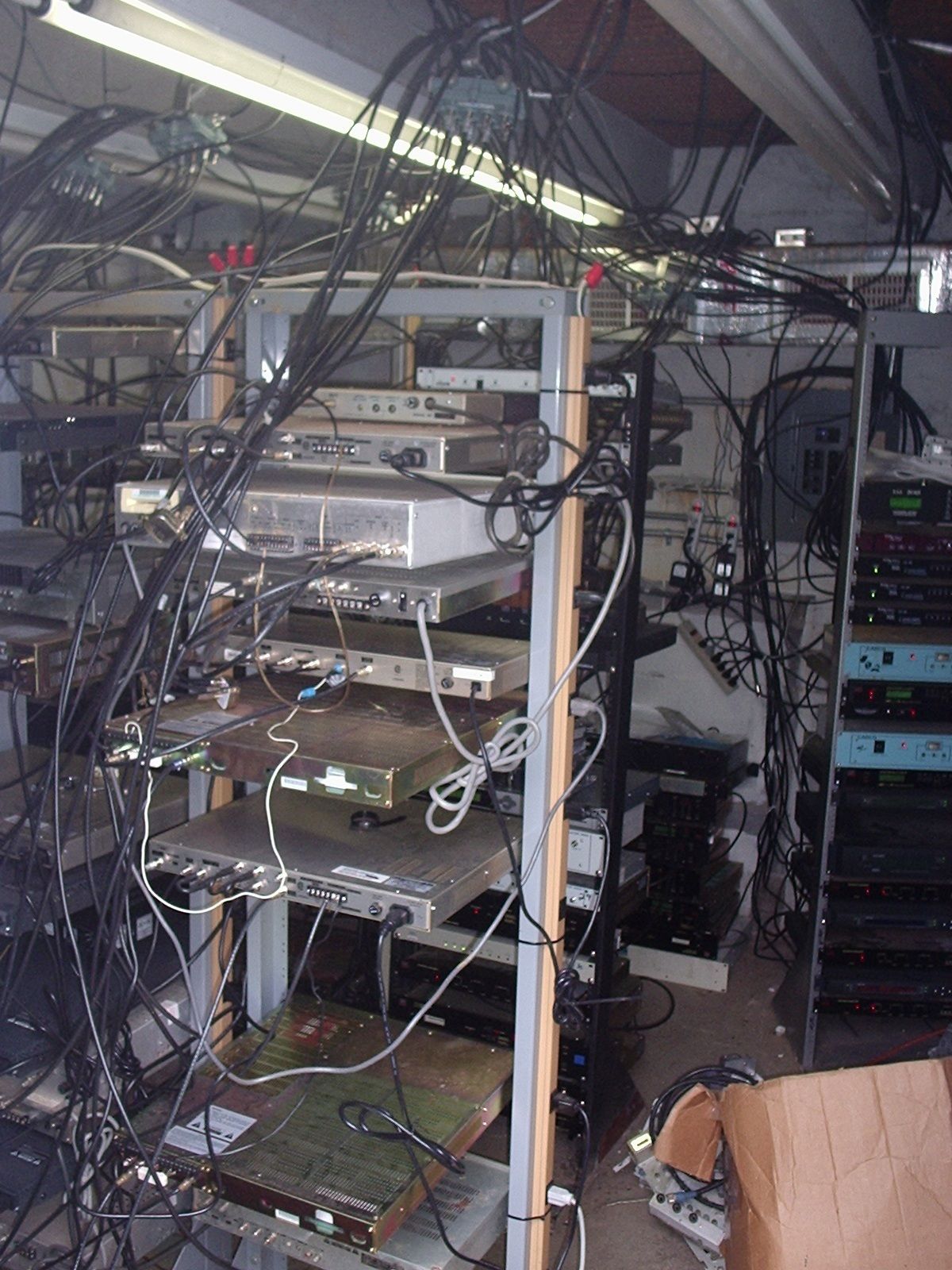

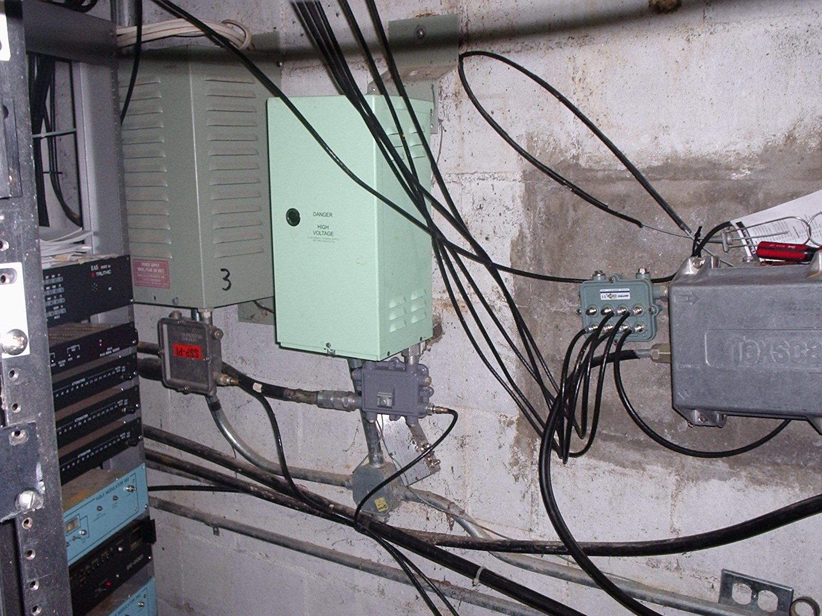

First 2 pix are of the way it was when I got there...The last 3 are when I was in the process of revamping and had already cut over the new launch amps.
Sorry it took so long:o...Actually it has surpassed even the revamping but I have not gotten pictures of that stage.
