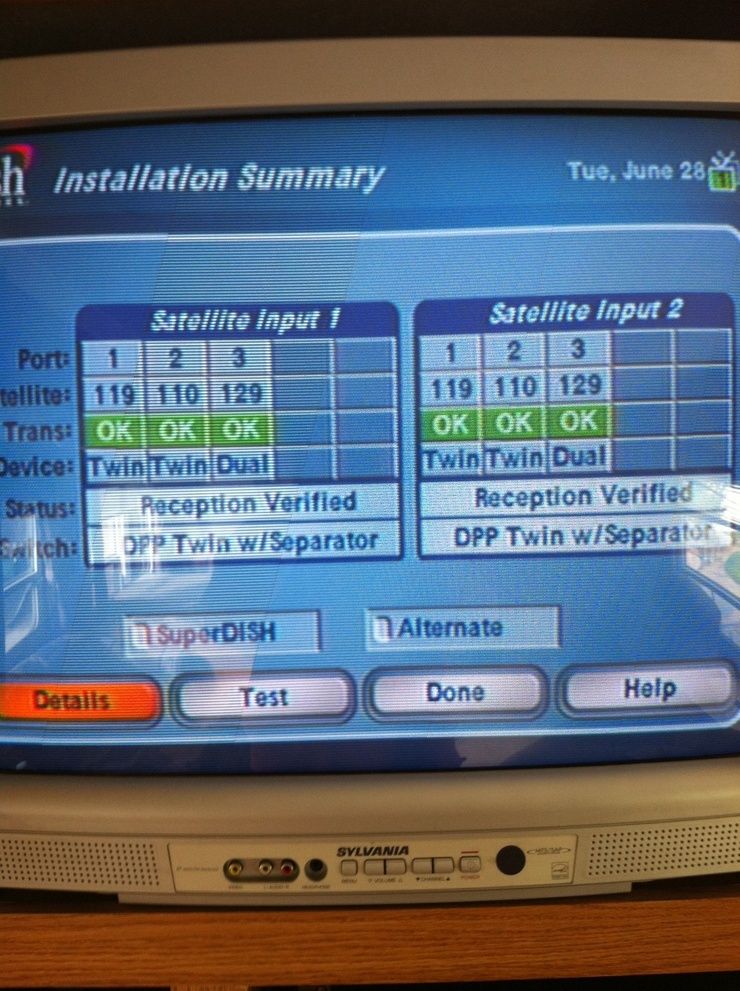

I aimed the dish with the menu set to 119 and got a lock on 110 as well. It seems that I have not gotten 129 but my receiver is only SD so not sure if that matter.
I ran the check switch again and got this:
Then click on details and got this:
Here are my sat settings:
and to answer an earlier question, here are my lnb's

By looking at the pictures it appears that everything is correct. Silly question but is this your normal receiver or another you had around? May need a hit sent. Is this receiver activated?
That's what I'm leaning towards as well.
