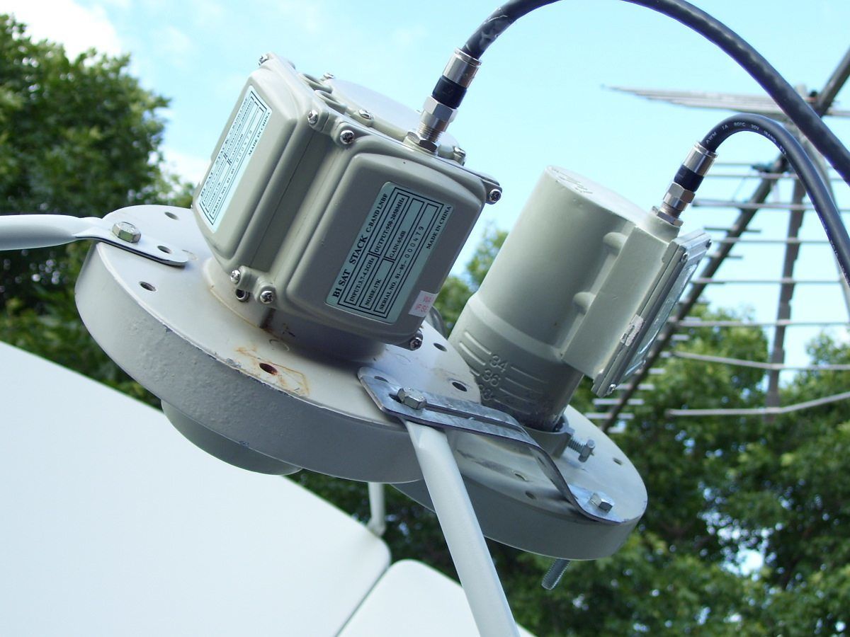

Here is an old pic of 2 LNB's on a 6 footer
left one...stacked
right one...looks the same as the OP's
Yeah, you're right. [Brainfart on my part] Gotta have isolation between the polarities. Can't do that 'in the same can'. But still think the proper place for it is 'in the bin' (trash)
