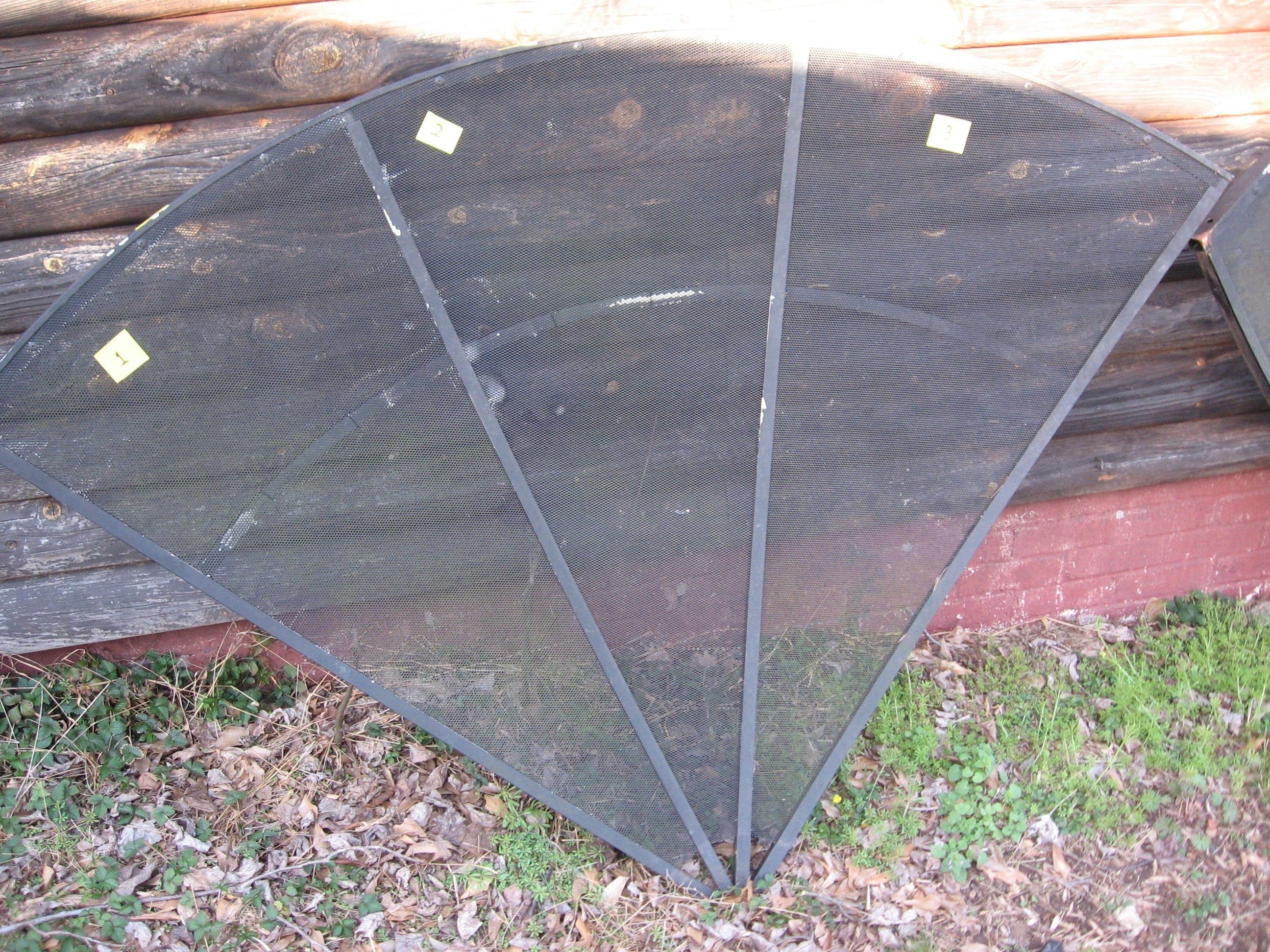

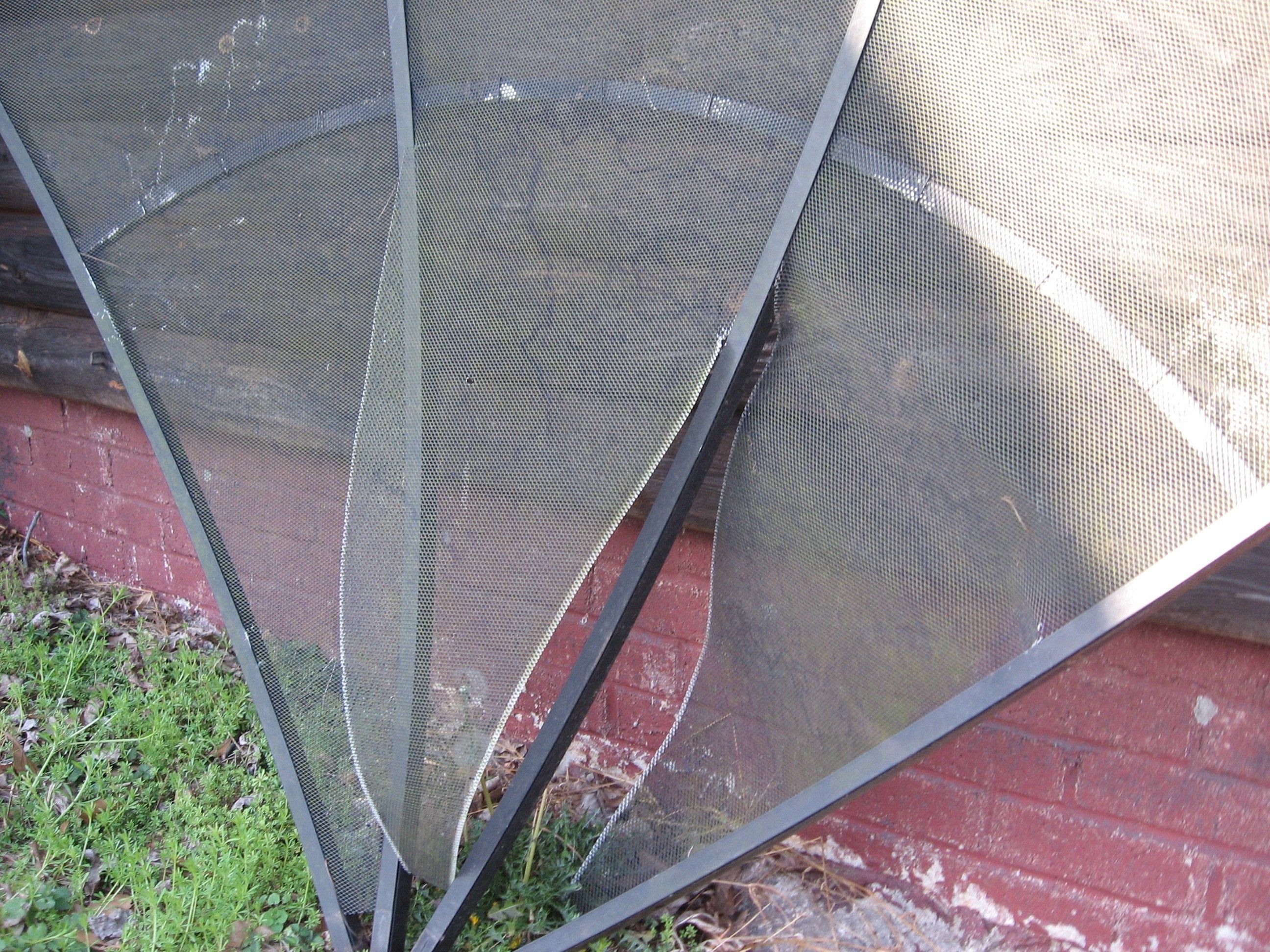

This is what my dish looked like when I got it. It was laying at somebody's backyard in pieces for about 10 years or better.
I hand formed it using my hands. On the edges and hail damages I used the back of a hatchet. I used a torch to get the tension out of it, but I think a heat gun is way better. It is easy to burn holes in it.
I numbered each panel so I could put it back where it came from.
Also, I turned the screen up-side-down (flipped it over) and this also helped with warpage.

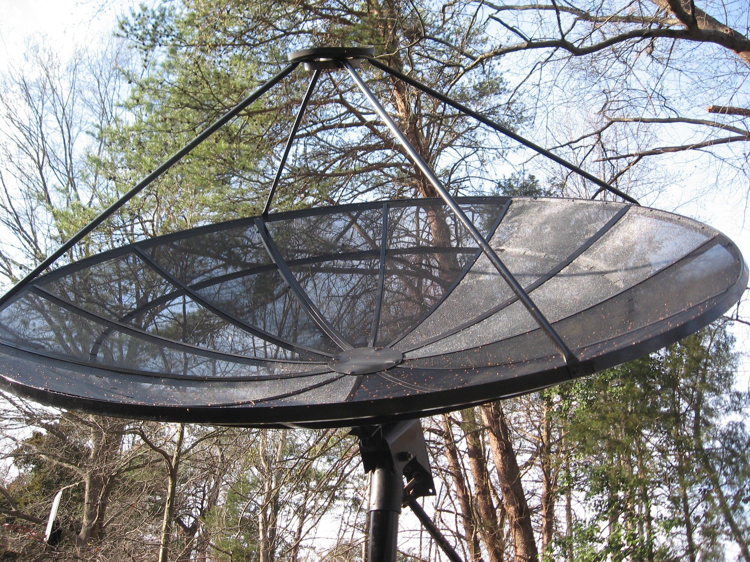

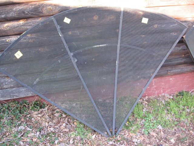

If you have patience and take your time you can be rewarded like I did.
The result.

It was way easier than I thought it would be.
I spend 2 evenings on it. I done it at my front steps which is concrete and very smooth.
I made the screen flat, since the webbing on the dish will give it the curved form.
And I forgot to mention that I took the screen off the webbing while straighten it up.
After I was done I cleaned it and painted it with high heat paint which has ceramic in it and it should hold up for a longer time.
Also I replaced all nuts and bolts on it which added only a few dollars.
Out of 12 sections, 10 where dammaged and only 2 where good.
1 day after I had the dish assembled and mounted on the pole, a branch from a oak tree fell on the dish.
You can see it on the finished dish photo if you zomm it in. The ding is at about the 5 o'clock section.
