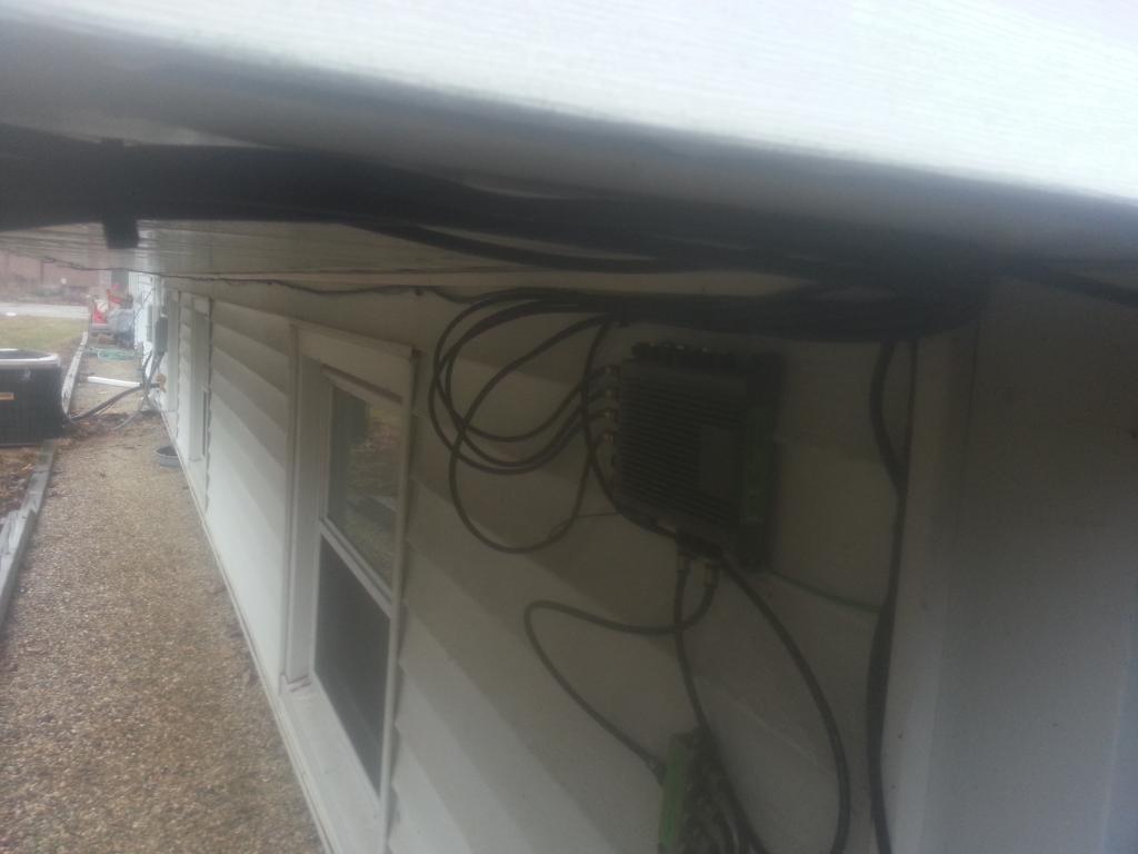

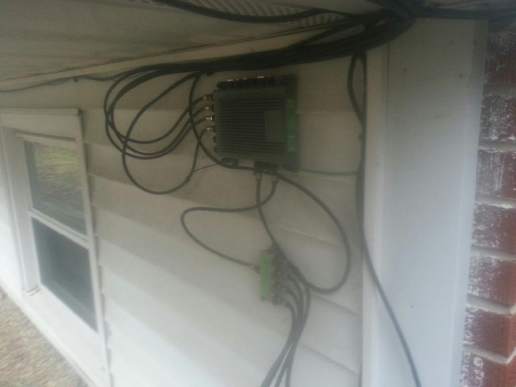

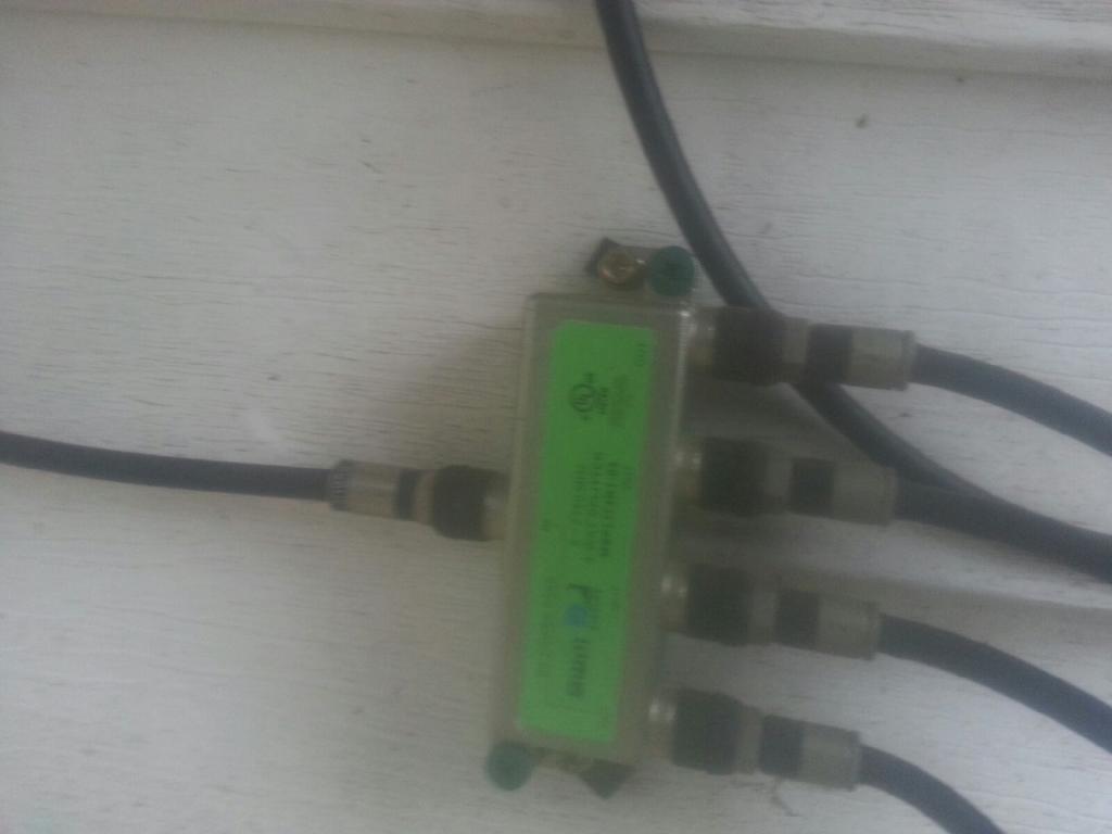

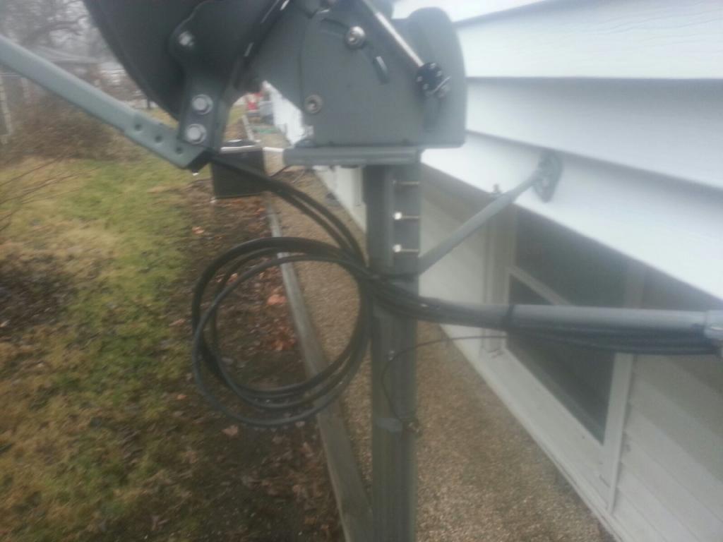

Here's a look at the setup outside:
Sorry about the quality...cell pictures early on a cloudy day aren't the greatest. Looking through them I realized that I didn't see the PI splitter over by the dish. Is this normal? I'm guessing it's near/on the outside of the wall where the wire comes in. From the dish to where it enters it's roughly 25 ft. to the wall plate and another 5 ft of wire from the plate to the PI.
Well since your running a SWM16 and you have no gray wire coming from the 16 but the 2-way in the cable box has a gray wore attached as a feed line is odd. Somewhere you have barrel which isn't a good idea. As for the power inserter. It should be inside. It is connected to the 4-way you have underneath the 16. So which ever line is connected to the top of that 4-way is going to have your power inserter on it somewhere. Ill read up on this thread and see if anything pops out to me and I write another post
Ok, I would see which receivers are on which splitter to start. Once you determine that try switching the receivers to different splitter. Also, I'm thinking a barrel is beyond corroded and needs replaced somewhere. That 16 and cabling look horrible. I'd want a tech out to just clean that up and while they're there, have them replace the wire running to that second splitter.
