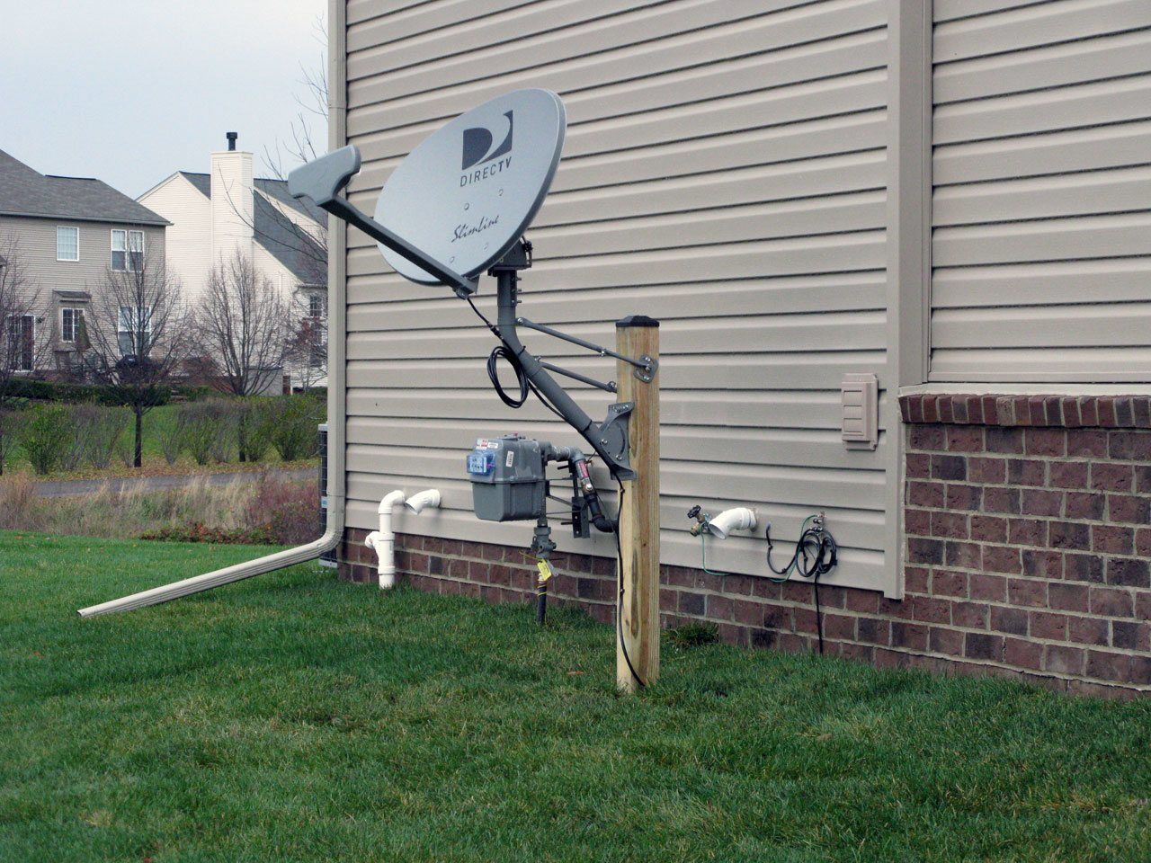

Why don't you just put a 4x4 treated post into cement, then mount the dish on it?
I had thought of that, but I need to get the dish and pole as close to my house to clear the neighbor's garage. I only have a small swatch that I have LOS (other than in the middle of my front yard - would not look good). I also want to stay off the roof. :)

As far as the 4x4, I've seen several dishes mounted to them with no issue. I've never in my life seen a 4x4 warp.

I love seeing them on a 4X4! "I haven't had a problem but now I can get my locals" walk around and BOOM! There's the 4X4! I see it all too much, you're best bet is to stick with a pole. I'm not sure if it warps or what exactly happens but it always seems to be loose and the dish begins to wiggle itself after a year or so. I wish I could explain how it happens but i can't, as far as the siding goes you'd be safe to do it just make sure you're far enough up for when you're mowing or walking next to the house or something. Of you're trying to stick with a pole make sure the rain doesn't run off the roof exactly where that dish sits, just more rain fade you can prevent
