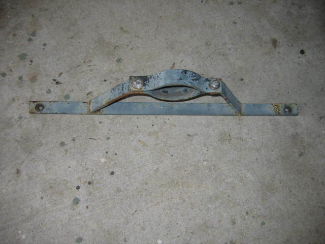

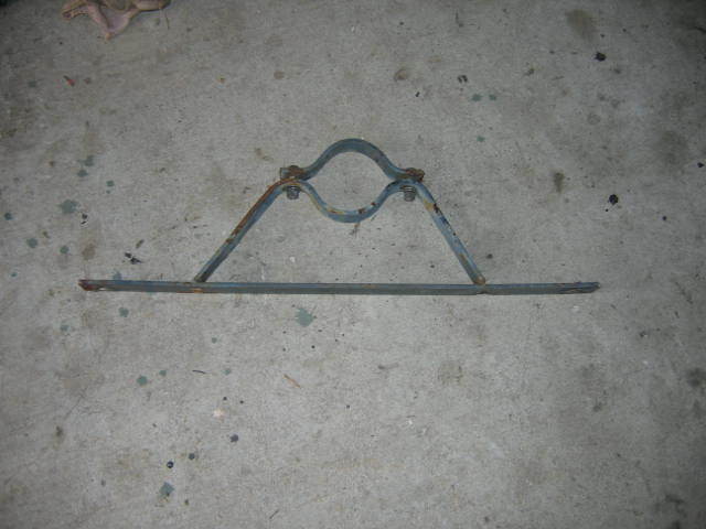

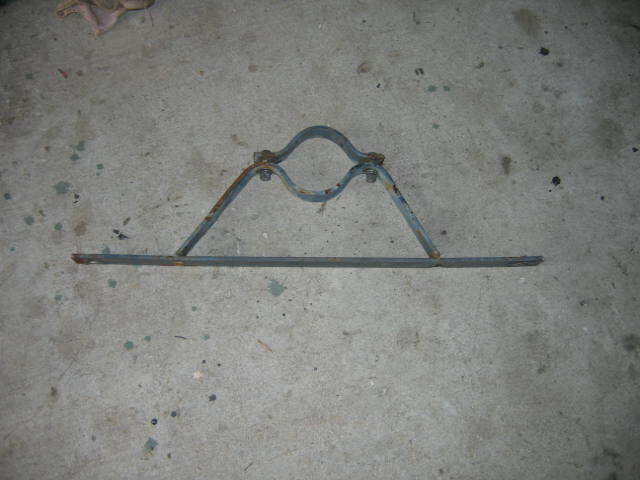

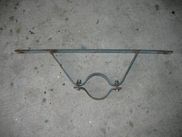

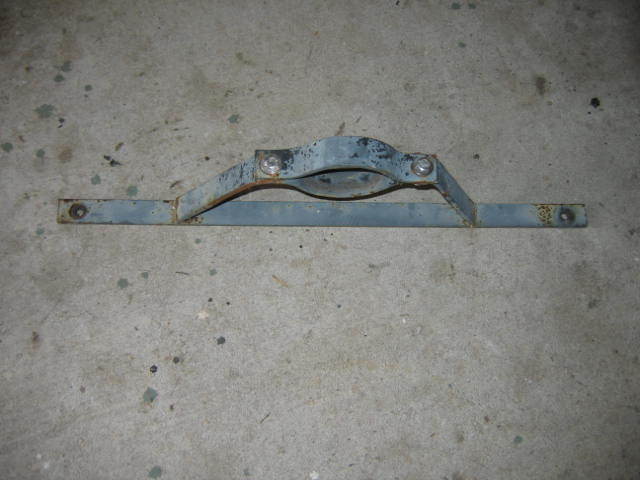

My 7.5 came off the side of a house that had it mounted about 5 foot above the facia. The pole was planted in a hole about a foot wide, I have no idea how deep it was. I have the 3 1/2" facia mount bracket, if you want it, pay shipping and its yours. :D

Stogie, you recommend this being mounted against the wooden fascia? Just wanna be sure. I'd rather get it into the concrete but if this can work, let me know. Remember, just like you, I'm in a hurricane prone area.
I think you misunderstood. The bracket in my pics was used IN ADDITION to the bottom of the pipe buried in the ground next to the house. The bracket is screwed to the facia and the pipe is put in the bracket to hold the pipe plumb because it it so high off the ground.
In other words, dig a hole in the ground next to the house, concrete the pipe in, and use my bracket screwed to the house to hold the pipe plumb. :)

Stogie, what I meant was IN ADDITION with the concrete on the ground. The concrete I was talking about was the concrete against the house. Shouldn't that bracket go into the side of house against concrete? OR is it ok with going into the wooden fascia board.

I'm not trying to answer for stogie here but, what I understand is that bracket is used to hold the UPPER part of the pole. There is no concrete that high on your house to mount to. If you screw that securely into the wooden fascia it should hold the top of the pole plumb just fine. Hope this helps
You did fine. That's exactly how it was on the house it came off of, lag screwed into the facia. I have no idea how they kept it plumb that high.. :D
