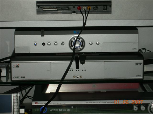

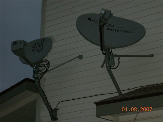

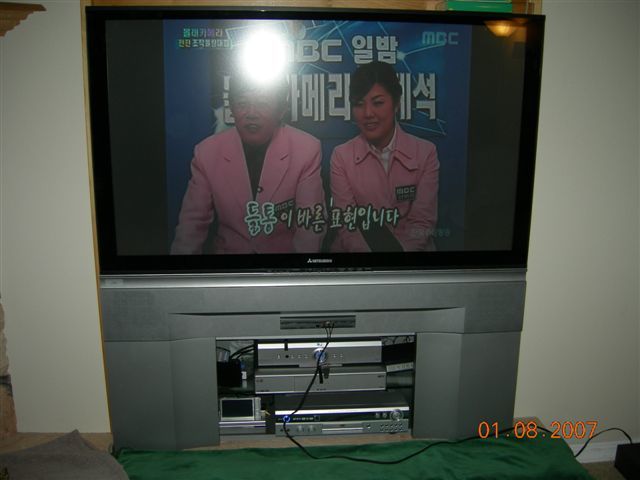

Well, got it done last week.
Urgh, how ridiculous... 2 of each... ARGH!!! :mad:
And tomorrow, upgrade from dish 1000 to dish 1000+... This is all too messed up, just to pickup Korean programmings... Urgh!!! Damn Dish, why did you loose SBS...
