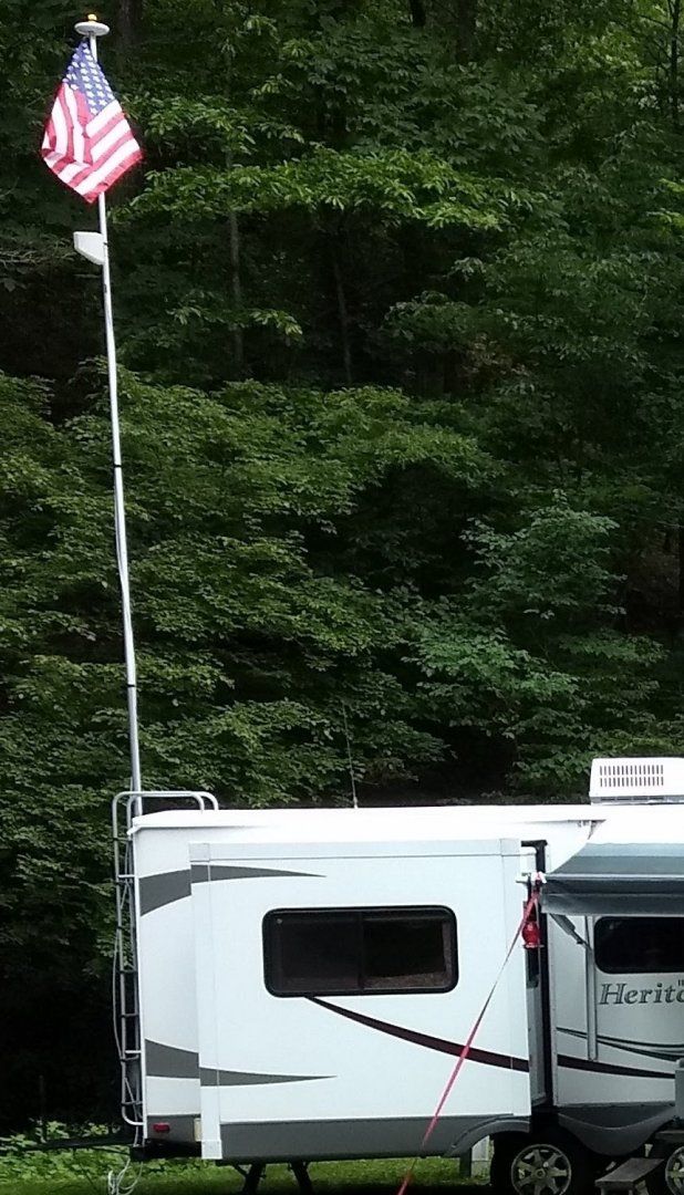

The amplified OTA antenna that's on my RV is pretty much useless unless I'm camping in Walmart parking lot..I currently have a 30ft flagpole mounted on the rear that I'm upgrading to a Rohn 9h50 telescopic mast and want to add a decent lightweight antenna with a Pre-Amp..I would like to use the current booster power switch that's in the camper but I'm not sure what pre-amps will work with 12volt power..I know the CM-7777and 78 use 15volt..Winegard is 5volt power supply..Will the Channel Master work with 12.8 volts?Any ideas?

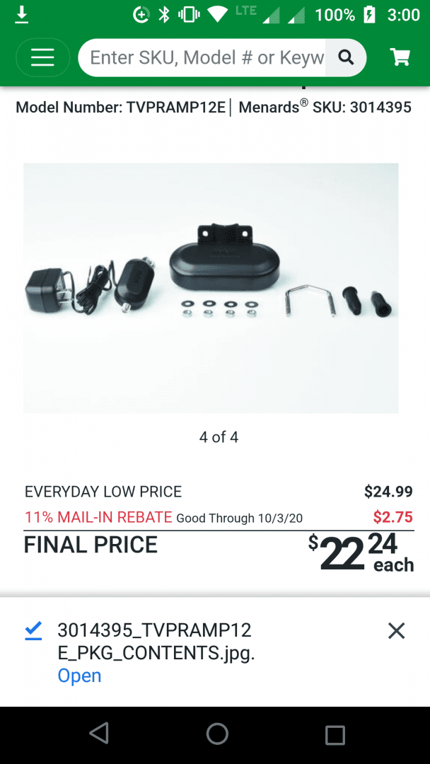

When I searched for the power supply on CM7777 it shows the replacement as a 15volt.. Good to know that they are using the 12volt..I actually was at Menard's today picking up some antifreeze and found they had the RCA TVPRAMP12E for $25 and it's 12volt inserter... I'm thinking that I should be able to put the amp at the antenna and unhook the coax at the factory antenna on the roof I won't be using and add cable from there to the new amp and antenna.Then I will still have the original Booster power switch..I'll give it a try and see how it works once I get the mast..I also have 2 of the Little Orby OTA antennas that are very lightweight so I'm going to try them

I use the RCA TVPRAMP12Z model with separate VHF/UHF inputs and it works very well for our home antenna setup. I believe the only difference is the E has a combined VHF/UHF input so it should work fine too. :)

I didn't really pay much attention to that until now..The one I got was the TVPREAMP1E..It also has the separate VHF and UHF inputs..The ad shows 12E model.They had 3 in stock all the same

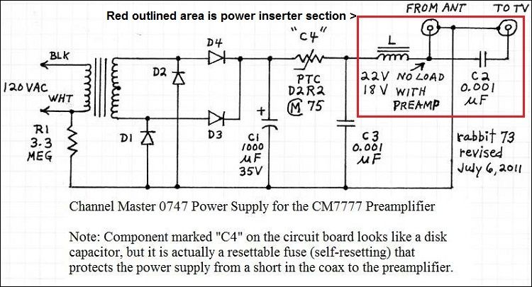

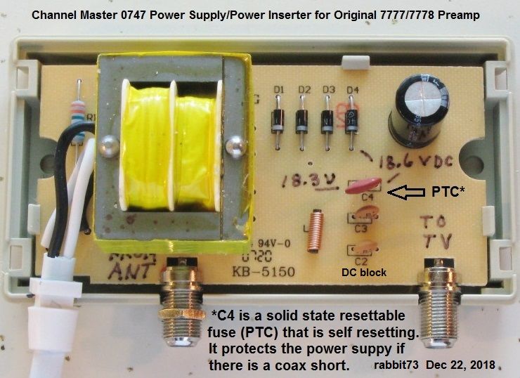

My Cm7777 has a bone white box for a power suooly.
That sounds like the CM0747 power supply/power inserter for the original CM7777.

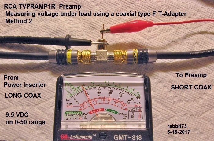

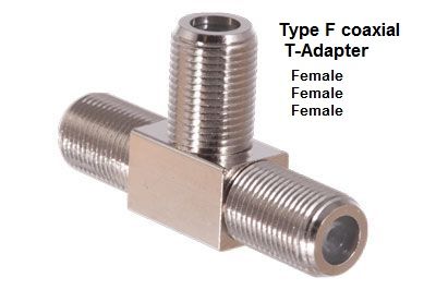

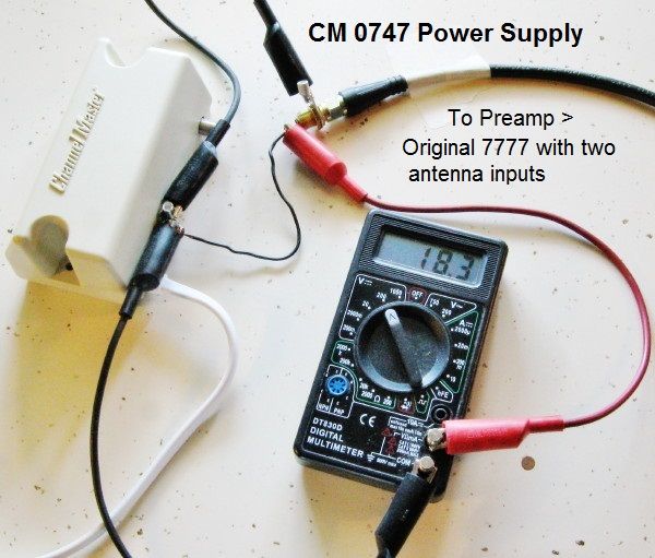

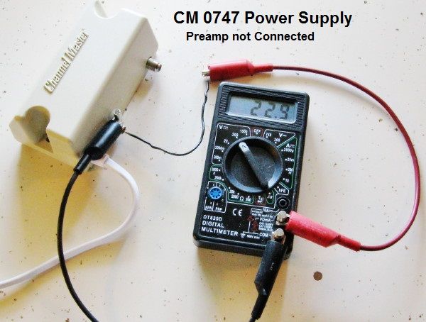

When testing a preaamp, it is often necessary to measure the voltage to the preamp at the preamp. This creates a problem, because you need access to the center conductor when the coax is connected to the preamp. I use a T-Adapter.

Reactions: Tvland1

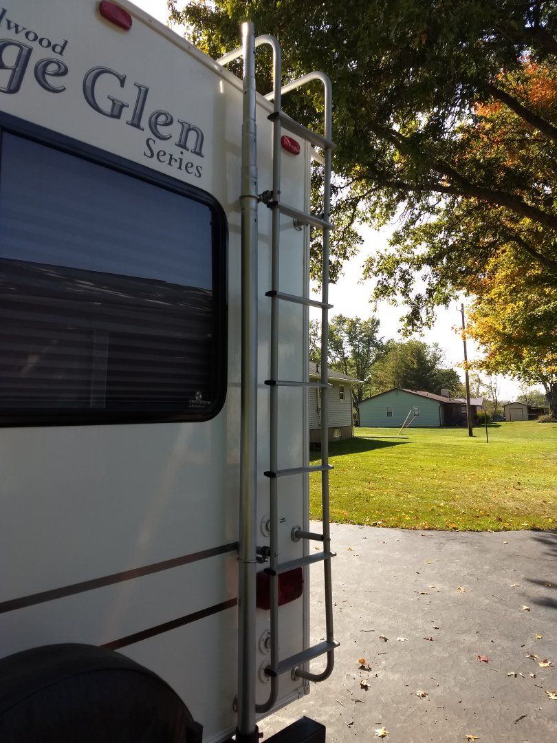

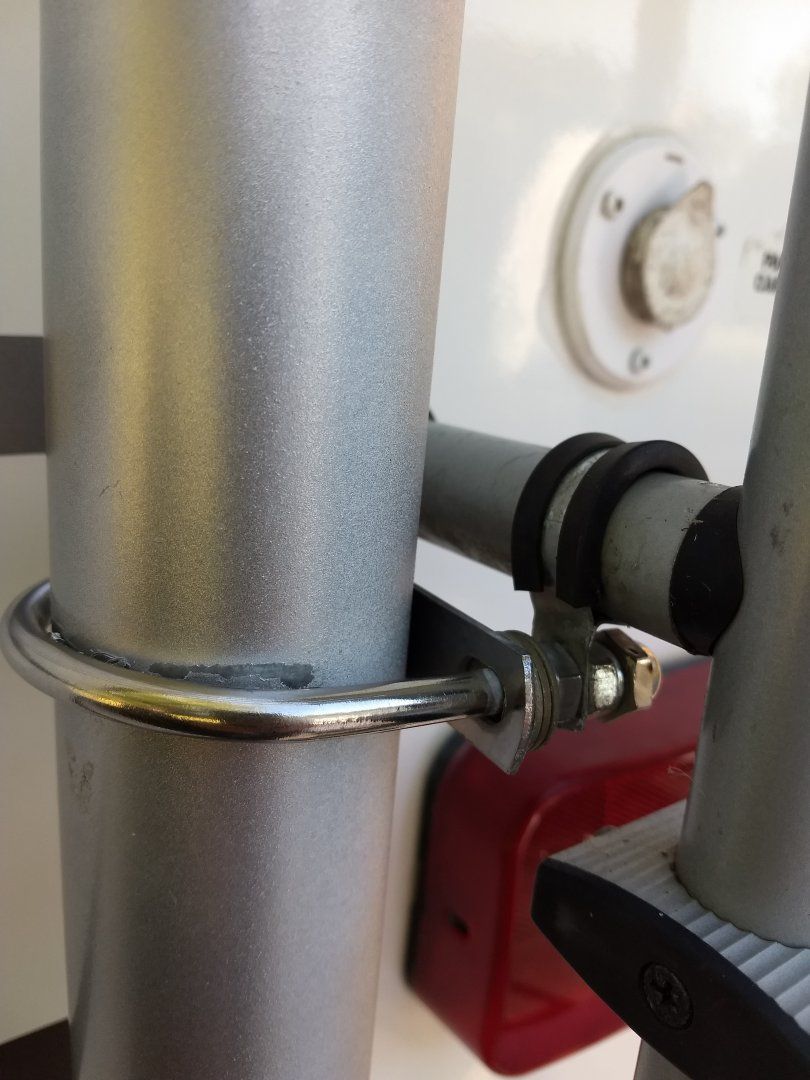

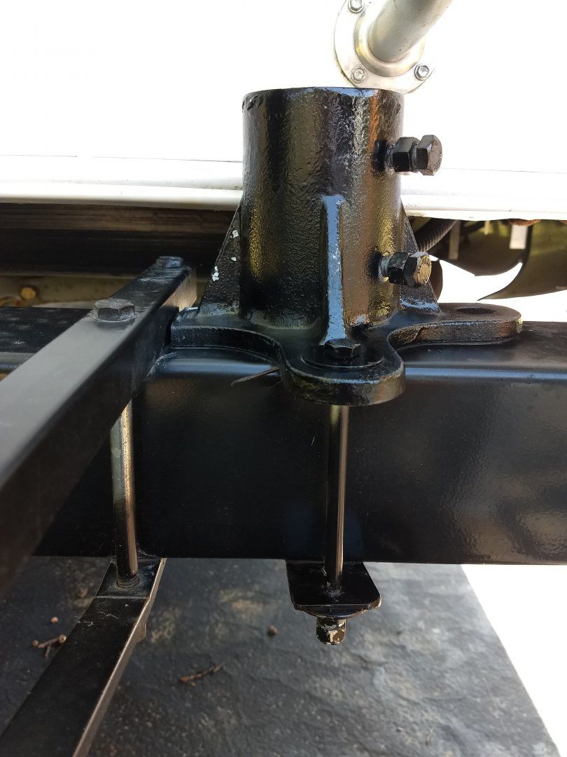

I received the antenna directly from Televes friday.Nice that buying from Lowes gets you the direct from manufacturer..I knew that I wouldn't need the RCA pre-amp once I decided on the antenna..I haven't had much time to test it on the mast yet.I did lay the antenna on the roof of the camper and unhook the cable from the original camper antenna and hook it up to the Televes..The camper booster power supply does work on the Televes antenna.Received a very strong signal even with it only on the roof..Can watch the signal meter with the booster on and off..The Televes power supply is 110volt but it's 12volt output to the pre-amp so I don't need to use it since the original Booster is 12volt.. I'm planning on working on it this week..I will have more pics.. It's a fun project
