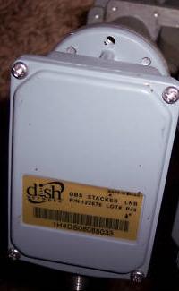

You need a dish dbs stacked lnb which was used for the superdish 121 and you can connect that to the waveguide throat of a big dish circular ku band feedhorn, but don't bother because the 119 footprint has been tightened up. dish PN/ 122676
