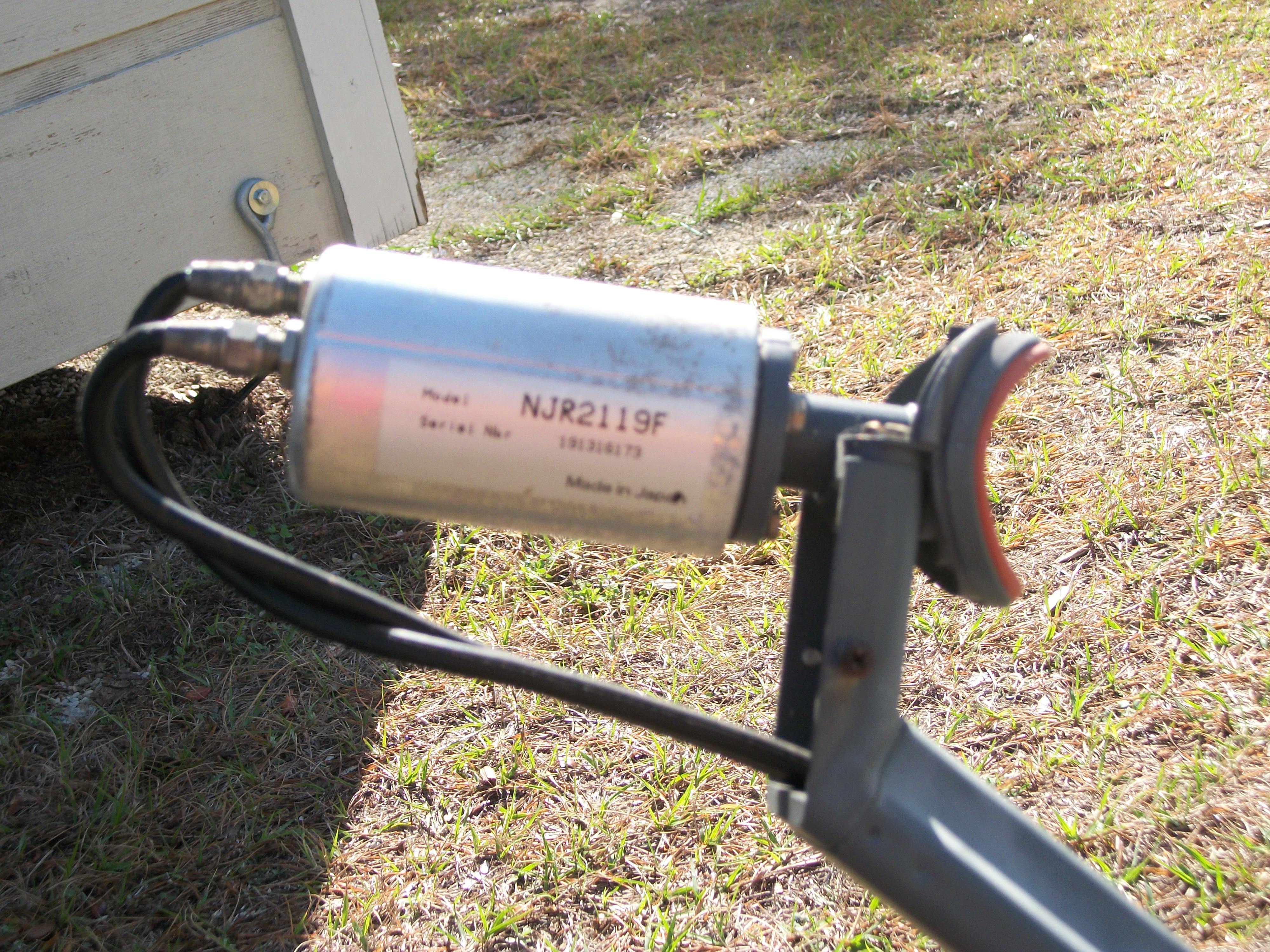

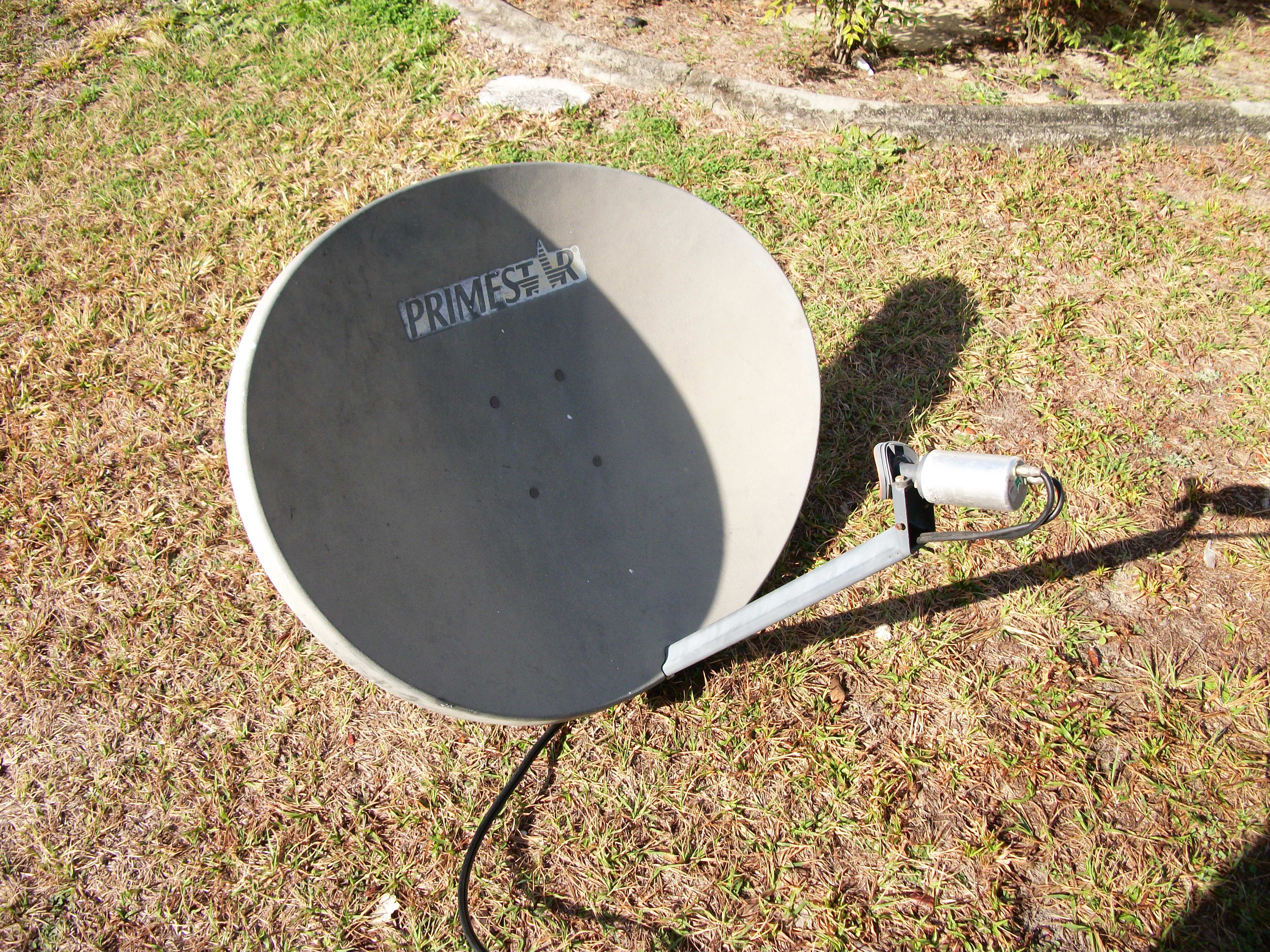

hi,
i have an old primestar dish 40'' x 29 1/2 '' with lnb NJR2119F
it is possible make it work with true fta???
if it's possible do i have to buy a better lnb or a motor?
i live in florida usa and i have two recivers vs ultra and vs platinum
please any help

You should be able to pick something up if i remember primestar was pointed at AMC5.
That dish will work fine as is for FTA (all FTA is "true") :rolleyes:
I have one set up and one in storage (same size)
The LNB is odd as one port only does vertical and one does horizontal only. Its stamped on the LNB. You can get a DIrectv 3x4 multiswitch and combine the 2 ports together (or switch out the LNB)

That dish/LNB is specific for Ku band. so forget about c-band for the moment. On your STB, Signal means there is noise from the LNB, just an indication that it is working. Quality is what you're looking for, and you'll peak that while adjusting the dish. Finding and peaking a satellite for the first time is somewhat time consuming. The azimuth and elevation you get from dishpointer programs are starting points. I usually set an elevation, then sweep azimuth SLOWLY until I find a signal. If no signal, adjust elevation up or down a degree and resweep. Having the STB and TV at the dish is by far the easiest way to go for those without a Birdog or equivalent. There are lots of posts regarding this procedure. Read, read, read, read.

the dish is really too small. Yes some folks have been able to get a few signals with a 40x30 Primestar (including yours truly) but it takes precision aiming and lots of patience :)
The dish is a ku dish, its too small for c-band. You want a 8-10' dish for reliable c-band reception. Are you using an active transponder frequency in the satellite receiver, from the satellite you are trying to aim toward? If you don't have an active freq in the receiver, you will not have much luck trying to find a satellite. Use the List, top of page to find active frequencies.
