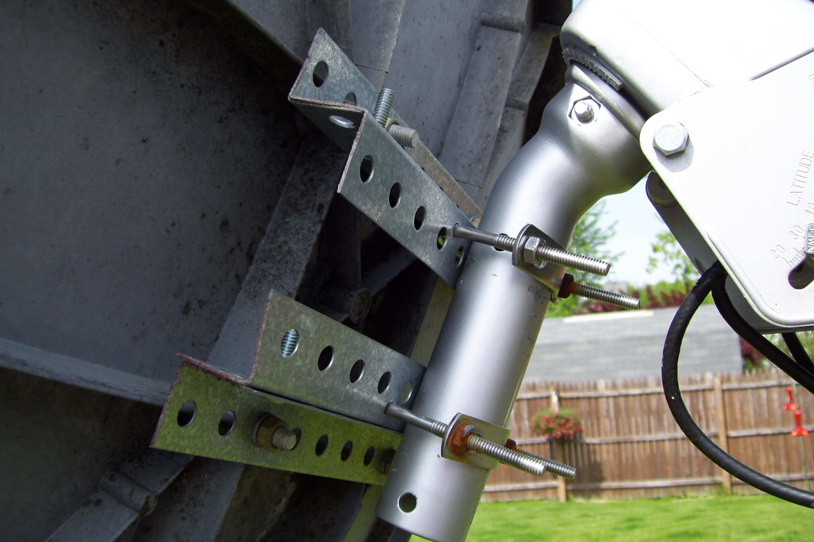

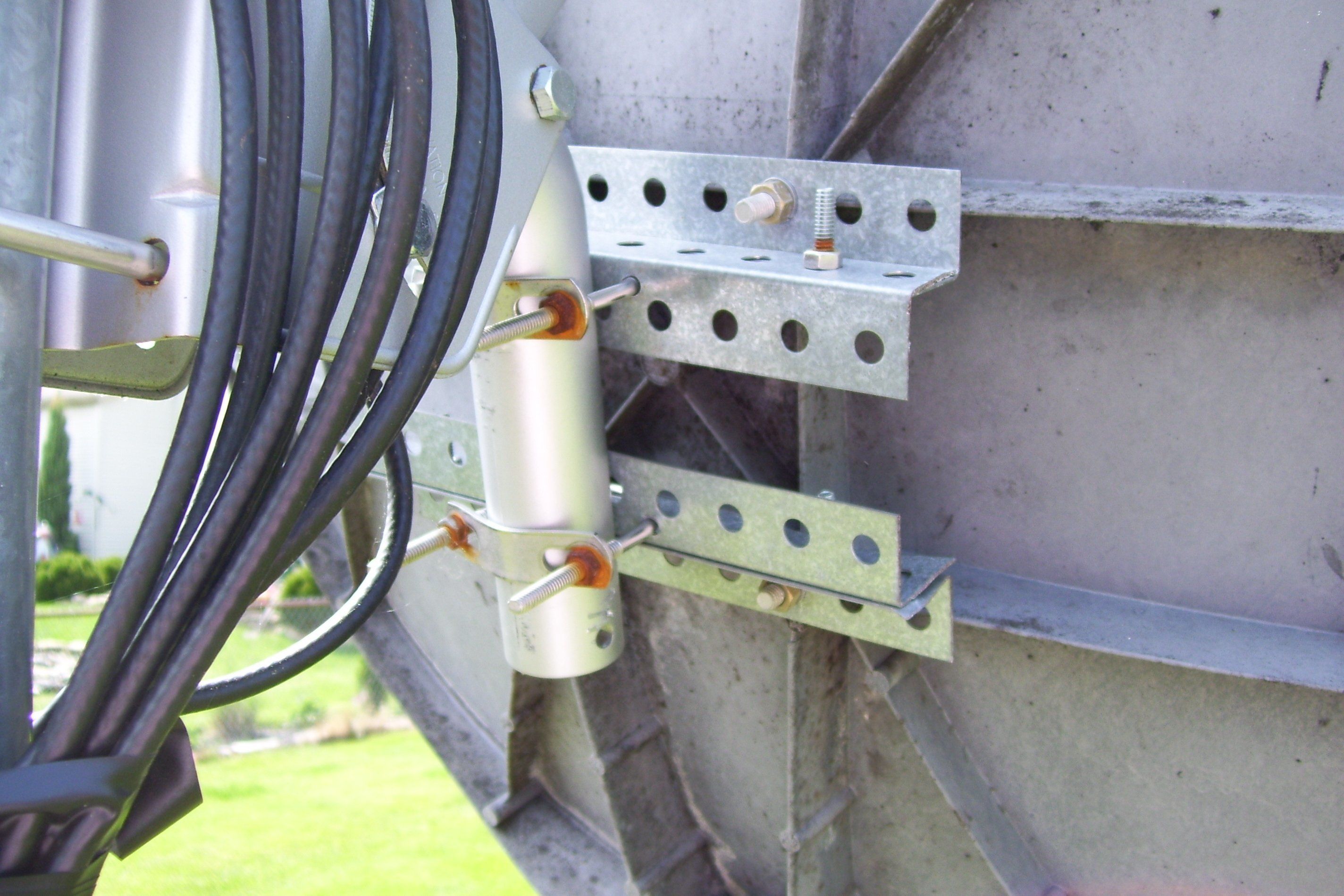

Hope this works, you can see I did away with the heavy primestar mounting brackets and used the angle iron so I could attach the C clamps to it. Was cheap and its been about a year now and works fine

I certainly don't have the knowledge and experience of BarneyBean and I learned a lot from his earlier posts---my 2 cents: I found that this design added a little too much extra weight to my dish and strained my motor. I have a 1.2 m CM dish on an HH motor so needed to get rid of as much weight as possible.

I bought the lighter angle iron so I don't think theres 3lbs at the most on there. I know the original mounting hardware on the primestars are about 9lbs. It also depends on which dish you have.
Yea useing the modified mount, the weight is signifgantly reduced. I know in a few years down the line I will most likely have to redue the mount due to deteration of the wood, I think I will move on to angle iron to make it last. :)
