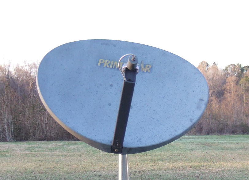

People call a lot of things, "Primestar" dishes.
And they come in several sizes and configurations (round and elliptical [wide])
But as a general rule, I'd bet on the molded commercial dish (the one you call a Primestar)

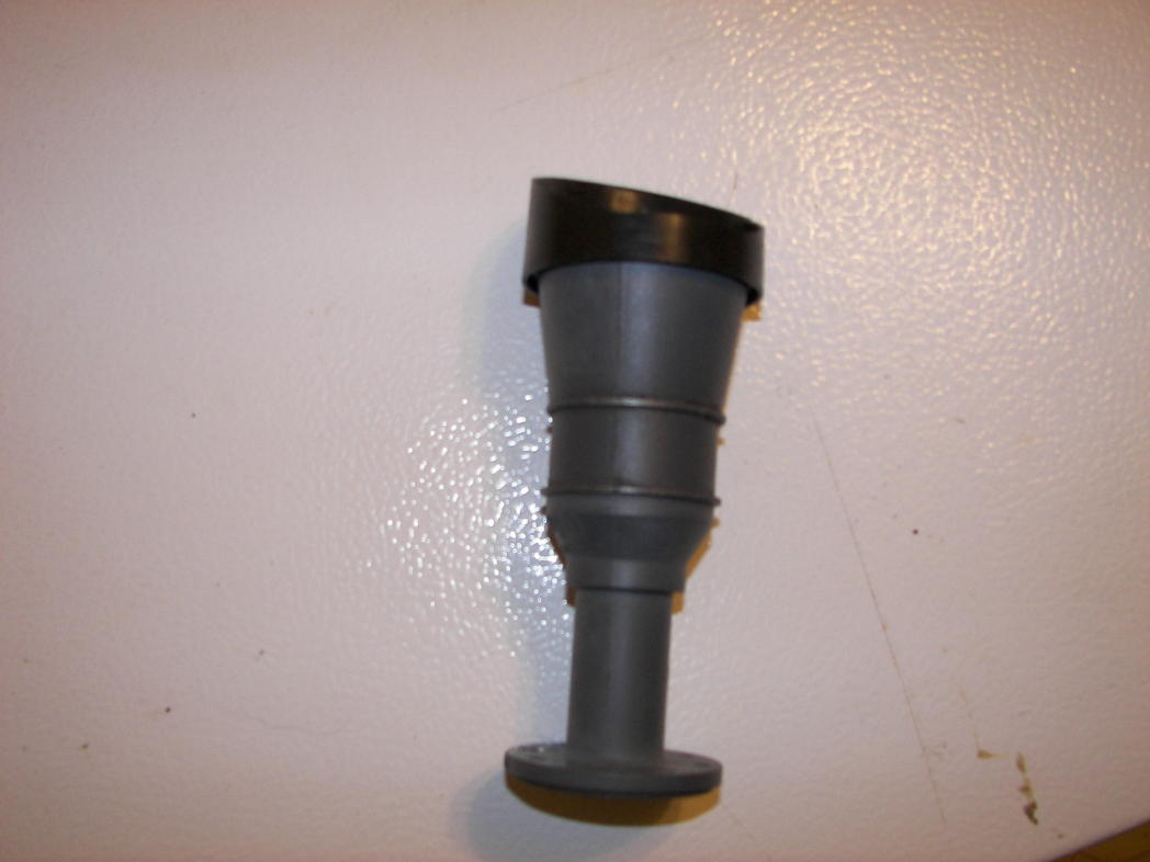

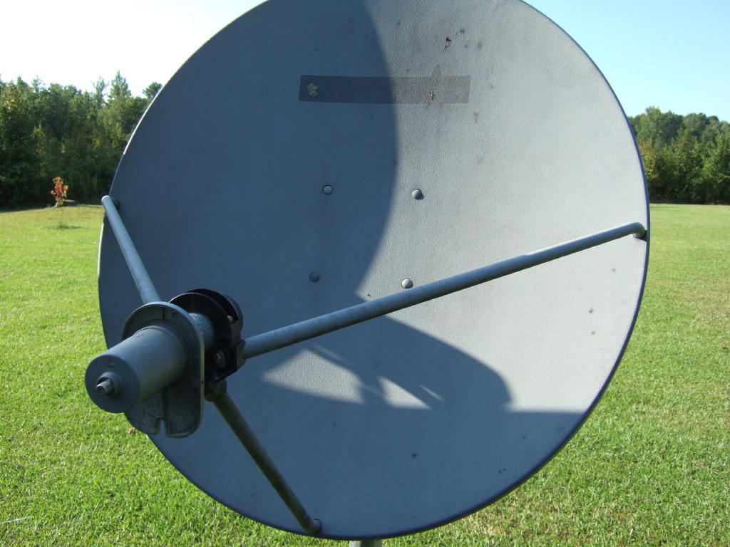

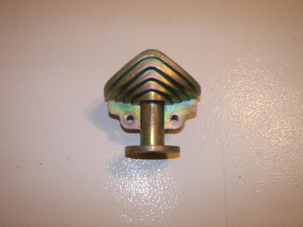

which primestar dish do you have?
which feedhorn are you using with it ?
below are some pictures of a 84e dish & feedhorn and a 1 meter dish & feedhorn

yeah he's using a ku lnb that will fit a corotor type feedhorn also so it should work for one polarity .
i was wanting to know what feedhorn he was hooking it to the one for the 84e which is most likely .
the adapter i mailed out today should fix the gap problem.
