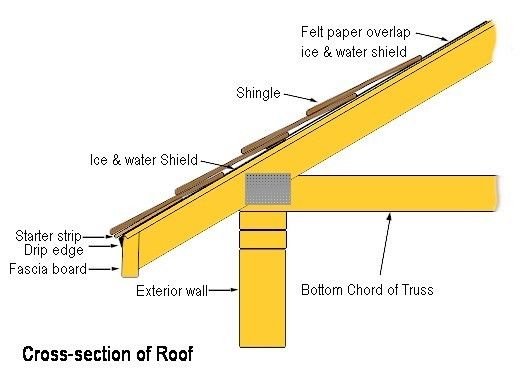

I ll see if I can take some pictures tomorrow during the day, and I ll post them here, it's hard for me to explain it too cause my English is limited lol I think the post is really needed cause the whole roof edge is too skinny for the new dish arm to hold properly, I was told they could only get 2 of the screws to hold and they have to leave the other ones un-tighten.
If by edge they mean the fascia board as opposed to the actual roof, then it should really be mounted there anyway. It can go on the roof itself.

Familiar with the area, see tons of houses with shingles; assumed tiles would have been mentioned up front. I would never assume that although you are likely correct. Here in AZ I would would always assume tile, BUT I still see the 3 & 5 LNB dishes mounted on the roof and chimney.
I am sure either way he will likely get a post but probably should get it installed on his own in the same general area of the PhaseIII; correct?
