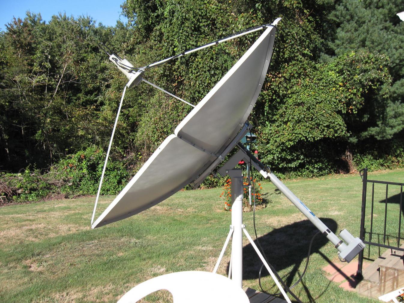

Hope i dont get water in mine!hasnt gotten real cold here yet! this mouning was the coldest so far at 24 deg F.Heres a pic of my actulator.

And BTW, that actuator looks just like the SuperJack I got with my SAMI and yours is mounted correctly. I've seen a few lately that were mounted up side down, which is a no no!
