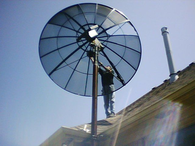

Here's my dish ( the mesh missing on it blew couple of weeks ago ), have spare one sitting in my garage for next time I need work to be done on it :).
