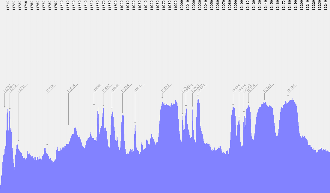

my blsa app needs a little tweeking as you can see, it gets confused by odd shaped tp's.
12106 is there though, you can see why so many people have issue with it, its very close to another tp, no buffer space there eh, and weaker then many too.
