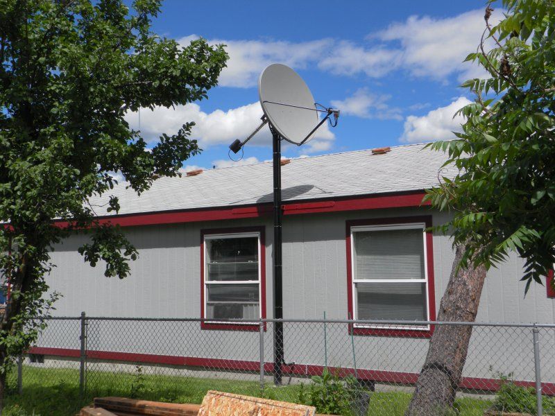

I found a 1.2 meter offset dish over the weekend I'm going to look at Saturday. Do they make a motor heavy enough to motorize one of those. Not sure what size pole it takes. Will know more when I go look at it.
Maybe this would make servicing the dishes more convenient and double duty for blocking interference? LOL
Reactions: wvman
Sure they do. ;) I have a VonWeise moving mine. The stock fixed mount for a 1.2M Channel Master fits a 3"O.D. pole. There are polar mounts made in EU. I modded a c-band mount for mine.

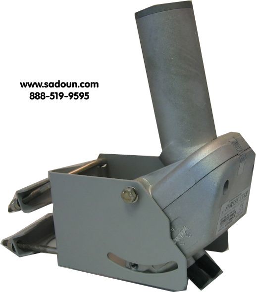

I'm almost certain this one doesn't have a polar mount. Nice job. Never tried building one before. Could possibly use the mount off a 7.5 foot Unimesh that's got the screen trashed out and make it fit. :) When I said motor, I was thinking of something like this.

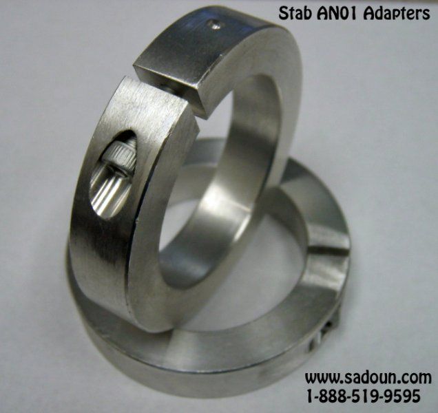

You might get away with a STAB HH120 and some mast adapters But I wouldn't be happy with it.
