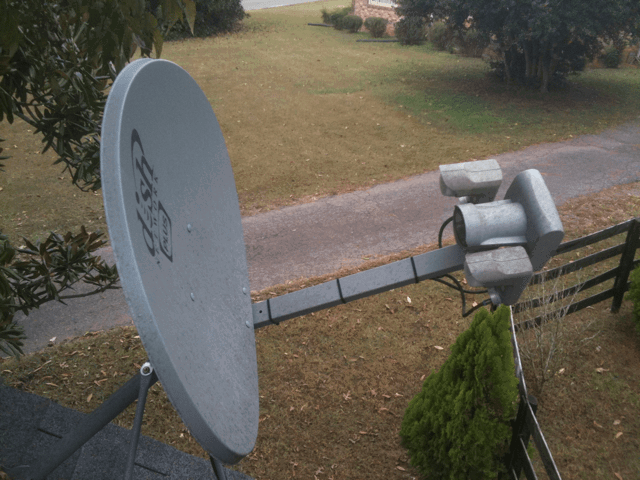

It's a 3 lnb E* dish. Photo attached. 4 lines from dish.
The rcvr is a Nuvenio
If the center lnb is linear, you might get some G19Ku. Can't say for sure. Did you get the LNBF's model numbers? IF they are circular polarization LNBF's, they are no good for FTA.

That is a Dish 1000+ dish....the LNB's are pretty much useless for free to air since they are all circular. FTA uses linear
What it sounds like he wants to do is steal Dish Network using a free to air receiver and downloading software into it which isnt tolerated here.
If he wants German channels he would need to subscribe to Dish Network :)

I will vote with Iceberg on his assesment of the situation. The fellow (your customer) is either naive, or he believes that you are.
First of all, FTA reception is totally unique from Dish Network and DirectTV broadcasts. Most of their stuff is circular polarized (maybe not all) but it is certainly all encypted, or at least everything that an ordinary person would desire to watch is. You could detect their signals with the proper LNBF and if they offered any "In The Clear" channels. You could actually view them. Most were the test cards for alignment purposes for DN techs.
It used to be nice for some of us FTA'ers to use DN's test card signals to help locate our position in the sky for aligning our dish and motors. The DN signals were boomers and that made it very convenient when aligning a FTA dish. FTA uses a much larger dish pan (reflector) because the signals are weaker and either vertically or horizontally polarized.
With the stronger, circular polarity signals, you didn't have to fret much over the polarization angle of your LNBF and you could scan or pan the sky pretty quickly and pick up a signal on the move.
This allowed you to get into the ball park area quickly. With just linear FTA signals, you have to sweep your dish much slower since you are trying to detect a much weaker signal. Not only that, but if you don't have the V / H polarization of the linear LNBF spot on, you'll miss it just on that account alone. Compared to setting up DN or DirecTV, FTA is more challenging.
