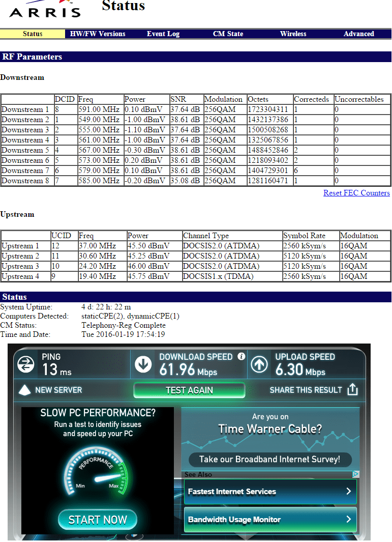

For your slow connection, what speeds are you paying for, and what do you get when you go to speedtest.net? When you go here, http://192.168.100.1/ what are your signal levels?

If your cable gateway is 4 to 5 years old, then it probably only bonds 4 downstream channels. Most if not all of TWCs systems in NY State should be doing 8 channel boding, and 16 channel bonding downstate in NYC since they have Maxx. So if you're connected to a congested node, a new modem that bonds 8 channels (or to future proof 16 channels) may help.
For the signal levels on the modem GUI there are three power levels to keep an eye on. Downstream Power, Downstream SNR and Upstream Power. If these levels are out of wack, you may completely lose bonding on one or multiple channels.
Downstream Power: The closer to 0 the better. -15 to +15 is within spec. TWC likes to keep it inbetween -12 to +12
Downstream SNR: 33 or higher is recommended. The higher the better. Under 30 will certainly cause issues
Upstream Power: 37 to 53 should provide a stable connection. Techs try to aim for 42 to 44
All, four, eight or sixteen downstream channels, and all four upstream channels should be pretty close in their respective levels across the board. There could be interference, water in the line, a bad connection, knicked conductor or something else causing problems with a particular frequency resulting in a complete loss of a channel and impacting your performance.
