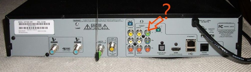

There is actually a separate set for channel 1 but these only produce a corrupted image and buzzing sound I'm not sure what they are for?

BTW, concerning the question mark on the pic, the green is part of the component video (red/green/blue), and the red/white/ yellow to the left is composite connection.

I think he's saying component where he means to say composite. If he hooks his composite input to the component output, he'd get a mono picture and garbage for audio like he said. But maybe he doesn't even know what component is, because he doesn't seem to care that he's not getting HD out of the composite output.
If the OP doesn't know the difference between composite and component, he may not have component cables.
To the OP. to use component output, you must have cables that match the color of the outputs. So a component output would have cables with red/green/blue ends. You would also need a seperate red/white analog audio connection.
