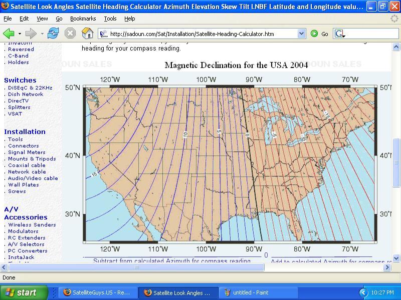

you have to take magnetic into account. So if your mag declination is +10, then you have to add 10 to most readings unless they take it into account
I ran the numbers for 101 for your area and I get
42.7 elevation
217.7 geographic azimuth
227.7 magnetic azimuth
See the below pictures. The number for azimuth is geographic so you have to add 10 to all your numbers for your location. For me (45N 93.5W) I have to subtract 2 to my numbers so for me its at 215. On your inclometer, you have to take into consideration magnetic. So you need to look at 227
