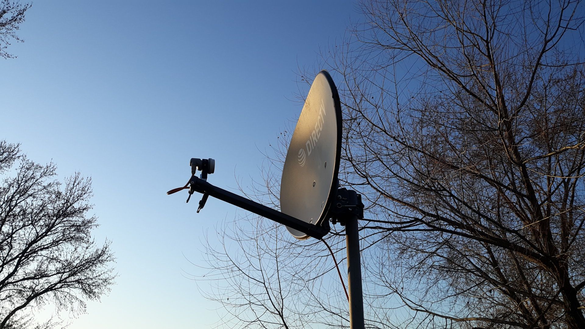

Looking South.View attachment 142730
The dish does have slight damage on the edge of the left side, also the pole, that I am temporarily using, is actually a (Approximately.) 10ft long PVC conduit pipe. The pipe was wanting to lean a little bit due to the weight of the dish & also because the pipe doesn't fit properly into the stand I am using (I had to shove part of a stick down in the hole between the pipe & the stand to make it not lean so much.
Another picture showing, somewhat, the position of the LNB on the mount.
I did read, on another site, that somebody that had a similar dish & LNB that I have was able to get their setup working by adjusting the dish tilt, instead of the LNB skew.
Your skew is a lot easier to tweak by turning the lnb instead of the whole dish.

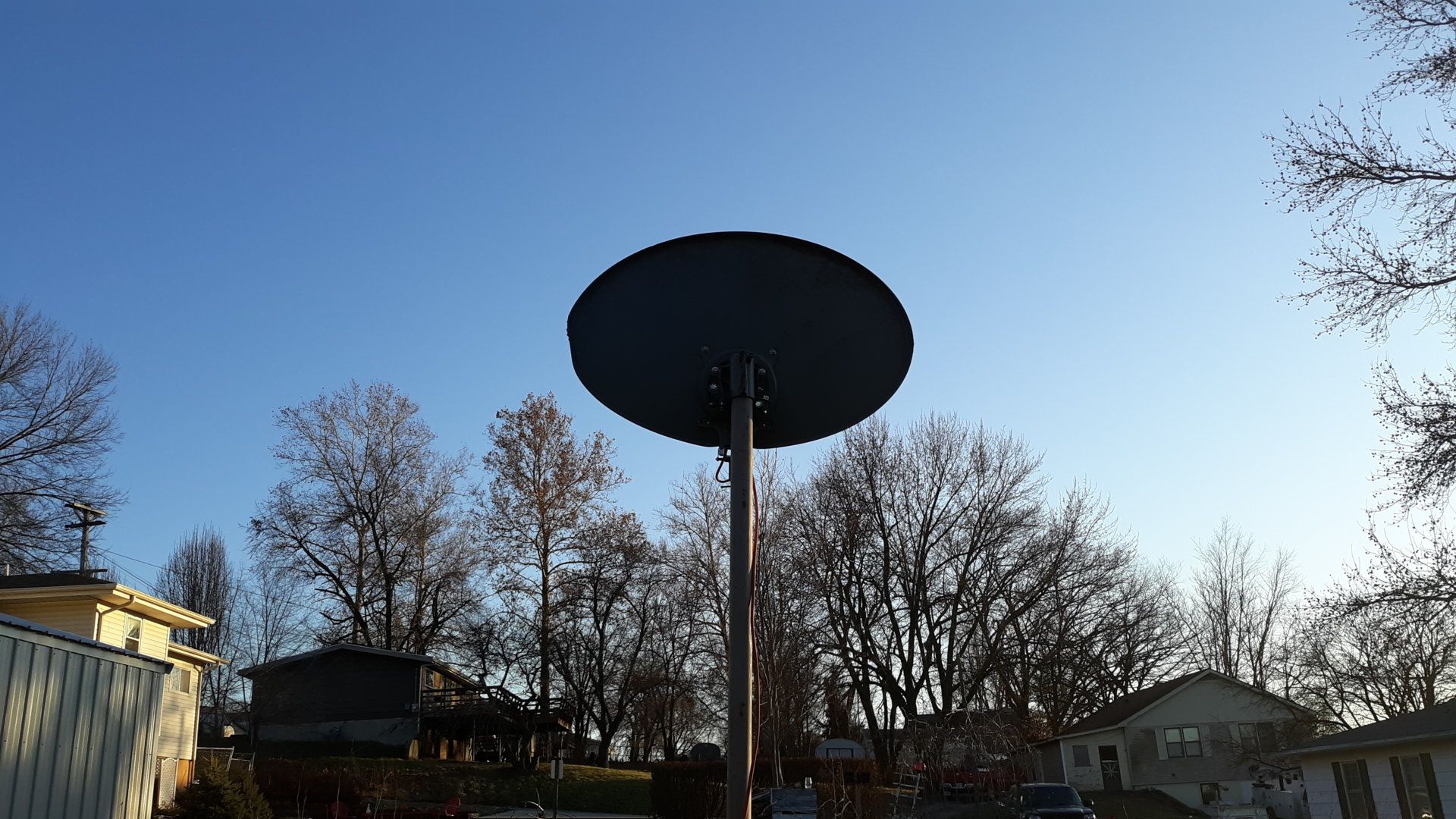

Your dish is 100 times more in the clear than my 1.2 meter and I get a strong 92% signal on most transponders on Galaxy 97. I would definitely verify your focal point. Without it being correct, you aren't going nowhere. Maybe it's the camera angle, but also, your elevation looks too low.
Being up on the pole makes it harder to tweak. If you focal point was known to be right and your skew right, you should be able to tilt and turn the dish until you got a strong tone on your meter.. Your pole needs to be solid and stable though... then do a blind scan and see which satellite you are on. That way you would know which way to go to find your target satellite. That's how us amateurs do it anyway. This method has always worked to get me in the ballpark. Keep at it and verify your focal point. You will find a signal sooner or later.

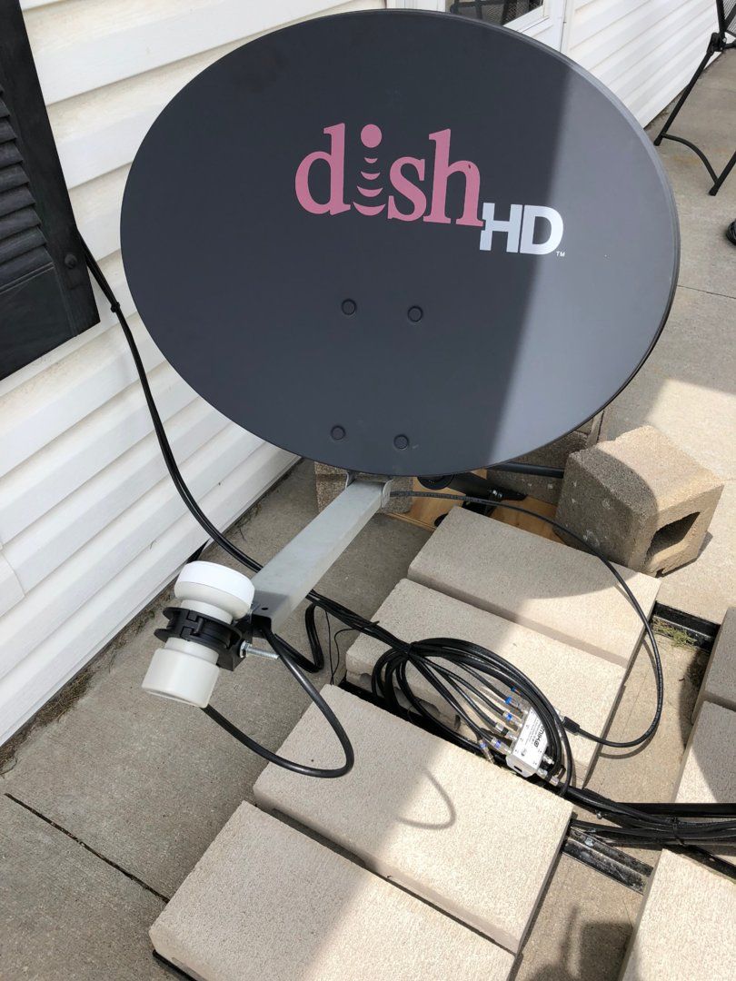

On my Slimline dishes I stuck a board into the LNBF arm and then mounted a bracket like the one FTA4PA posted a link to earlier. On mine, the bracket ended up having to be about a 1/2" out from the end of the arm, yours could be different.
One thing to remember with a offset dish like yours is that the signal doesn't come straight at the dish like a prime focus dish, it comes in at an angle, so the dish can look like it's pointed at something and still not have the signal blocked, because on a offset dish it comes in at an angle above the dish, not straight at the dish.
Reactions: FTA4PA
It also seems to me that the LNBF is mounted a bit too close to the reflector. I have a Slimline but not in use now, but if I remember correctly, the clamp holding the LNBF was closer to the end of the arm. But more importantly, it looks like your dish is aiming way too low.
Now, with just a receiver as a mean of detecting signal, with a PVC pipe as a mount and a questionable LNB location, it's a bit like looking for a needle in a haystack. Too many factors at play, and the limited accuracy of the scale on the dish mount is invalidated by the bent PVC pipe.

That dish looks bent to me. That's not good.
Also, in my previous experience using a DBS dish for FTA, the dish doesn't need to be rotated like it is when used for Directv. Should look like this:

Looks to me that your lnb is way to close to the dish. Double check the distance with the original lnb.
I was thinking the same thing. It seems that post #45 (along with the YouTube video where he talks about taking the measurements) hasn't received its due.
Precision isn't optional.

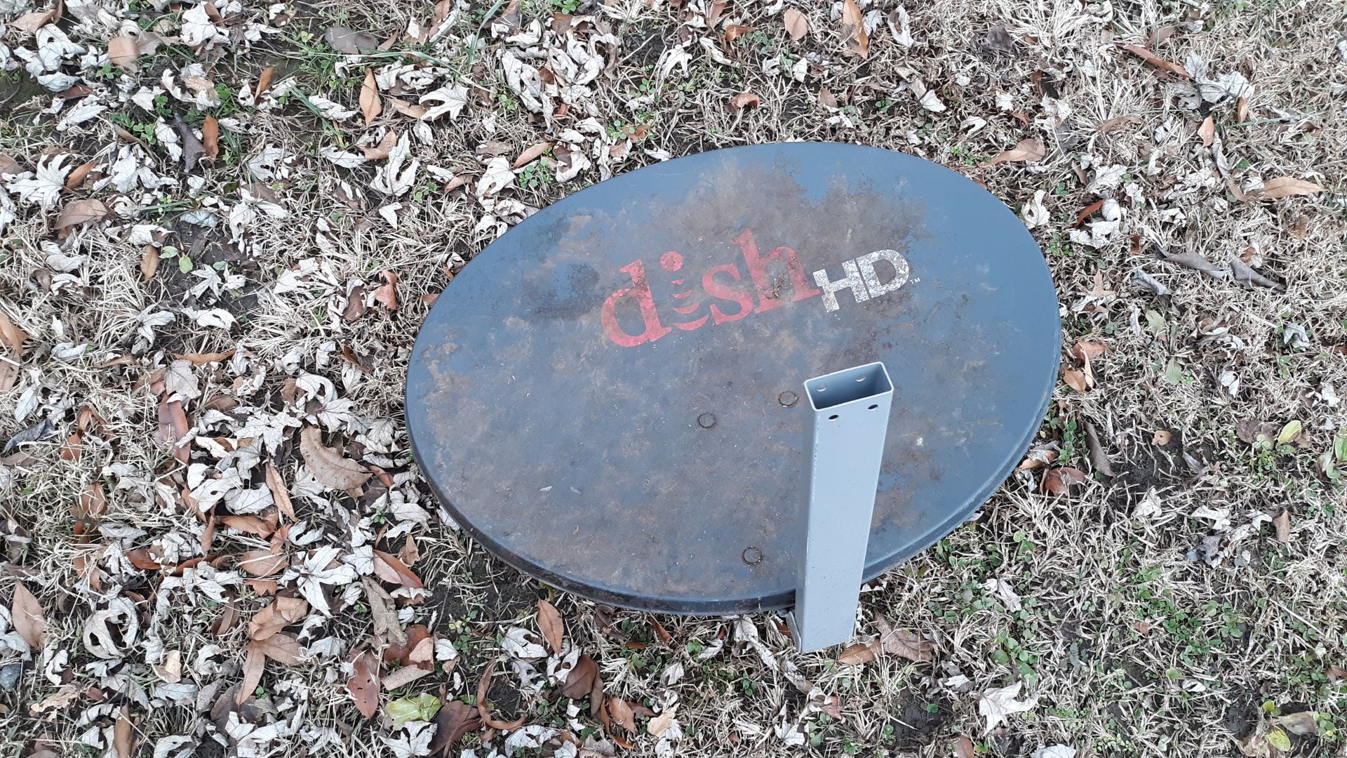

I do, also, have a Dish Network satellite dish, but it's missing it's original LNB. Could I still use it with the LNB I have.
You need the DISH LNB and bracket adapter (two distinct pieces) to measure where to put the FTA LNB. The DIRECTV SL3 LNB won't fit on the DISH 1000.
Yes. I just drilled holes in the support arm to retrofit a Geosat bracket for my LNB. Not difficult at all.
Keep in mind a dish of that size will only pull in some feeds on 95, 97 and maybe 103. That's it.
Do you know how many inches from the dish on the support arm you drilled the holes?
