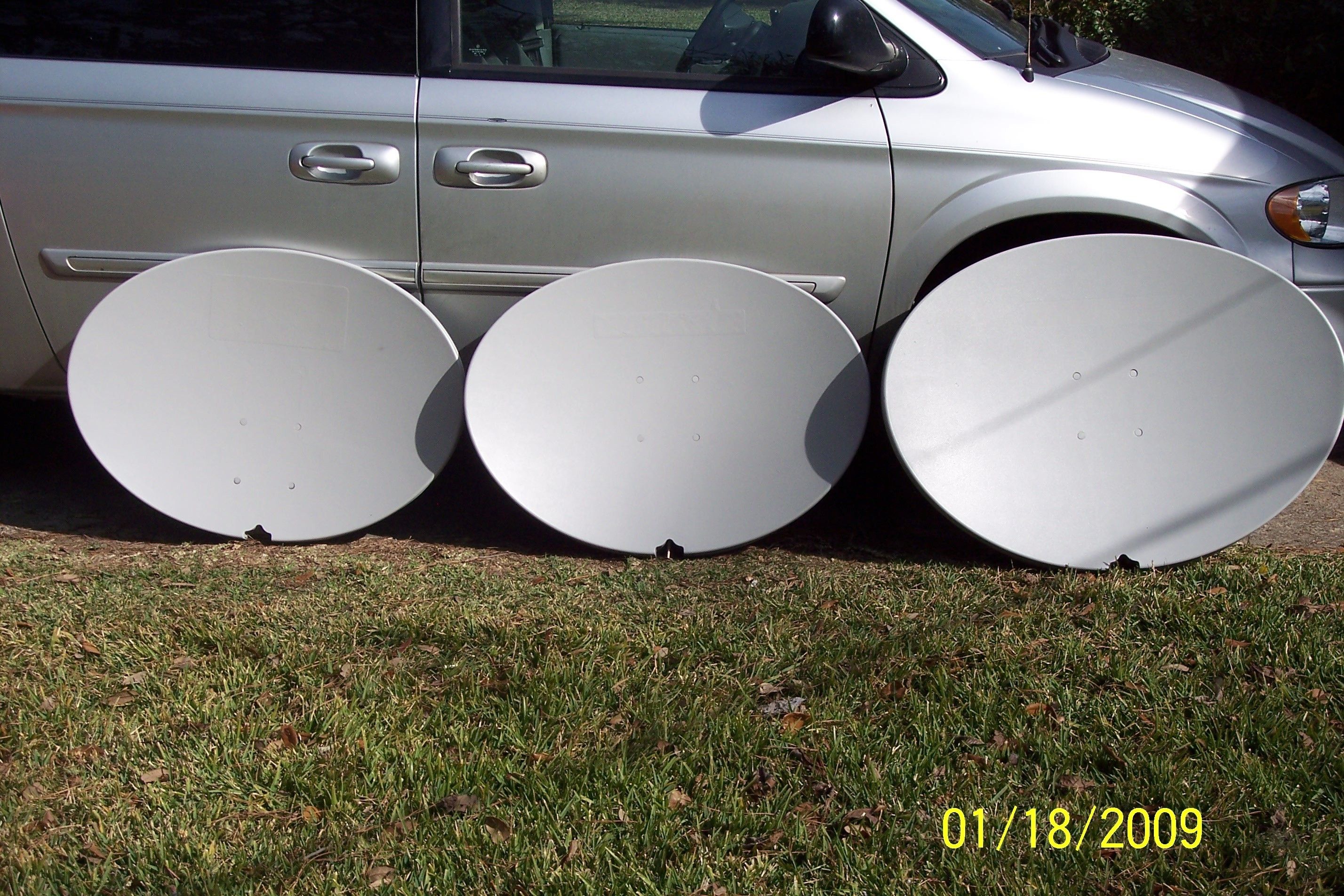

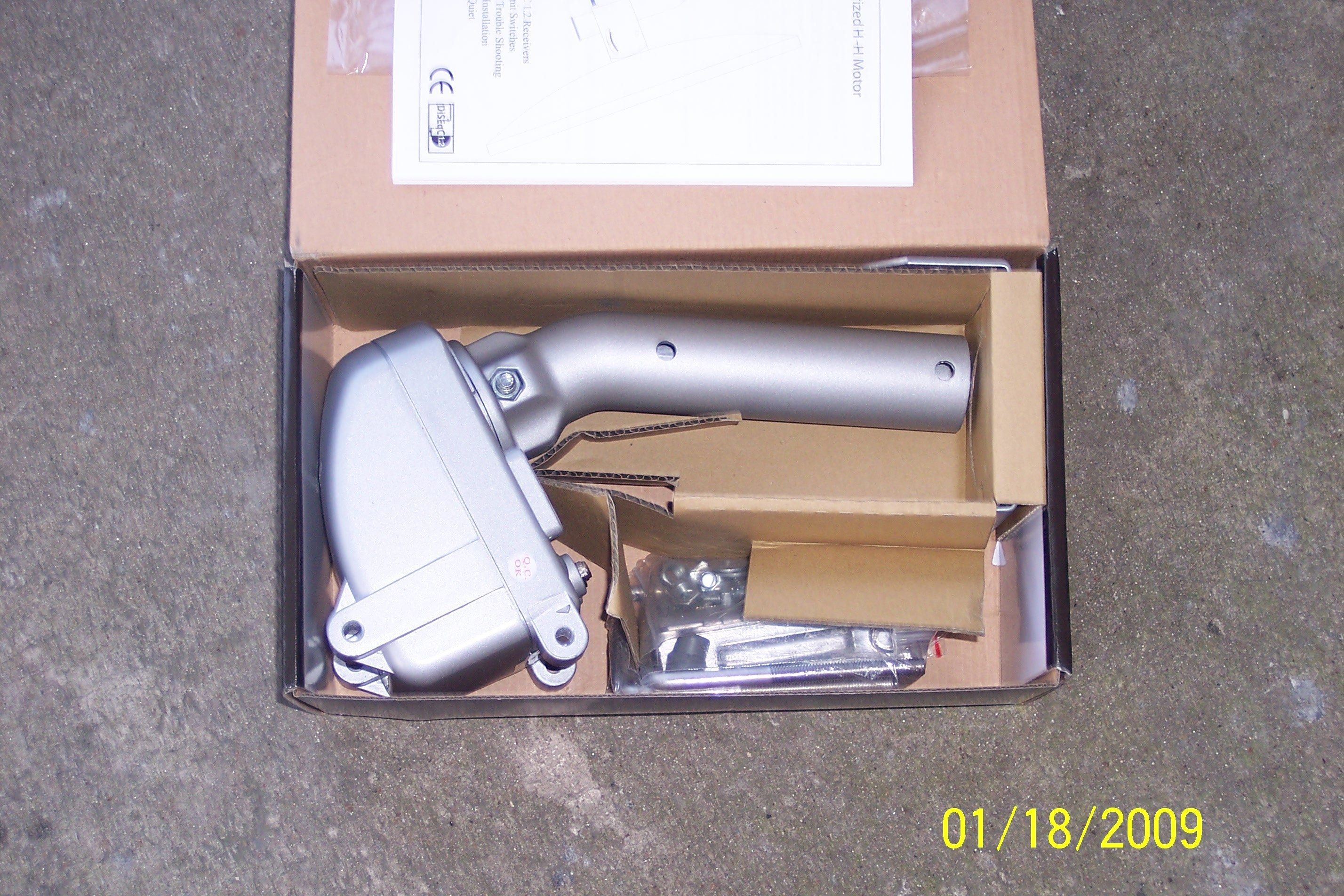

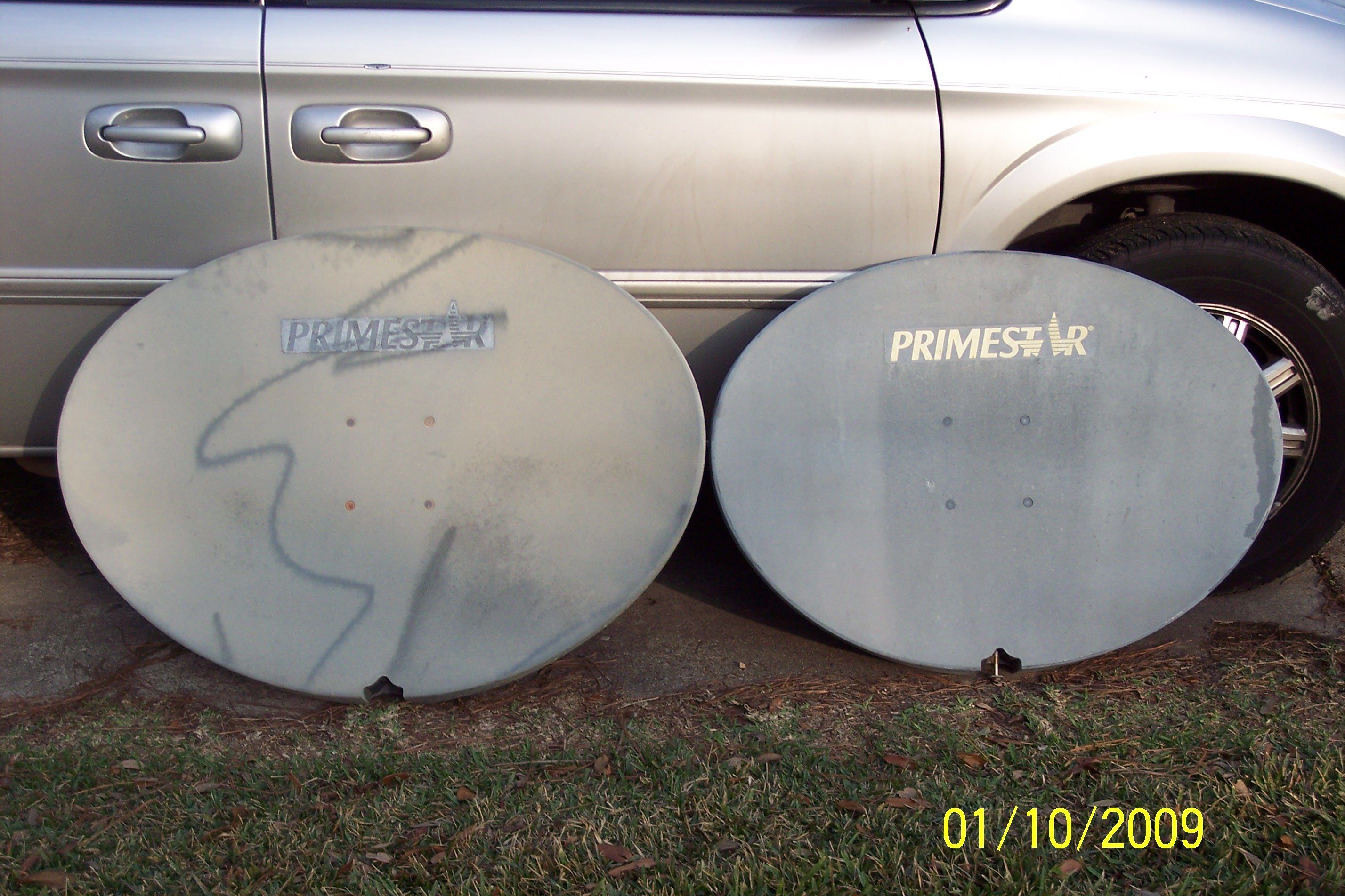

I read post awhile back talking about your motorized 84e. After a hour of shearching the forum I can find it. I am going to try the same thing. My question is the dish has a offset in it but I can not remember what it is can you help me. Here are some pic's so for of my project I just started before paint and after paint. I found one more 84e but can not ever find anyone home.

To motorize an 84e you have to have a couple of items before you start.
You need the 55mm tube for your motor above, and you need a length of 2" pvc to be cut down the middle for the shim. You also have to turn the mount upside down on the 84e to make it fit on the motor.
Take a read at that thread, and it will help you a lot. :)
smith, p I just got done painting them when I took that pic so they were dring, but I do have them.

I looking at some mods from a few ago and think I am going to try one of them. I guy cut the mount and mounted a foot off of a small dish to it and then had to make a jack bolt for elevation. It looked easier and I have all the stuff here already just have to fine time to do it.
