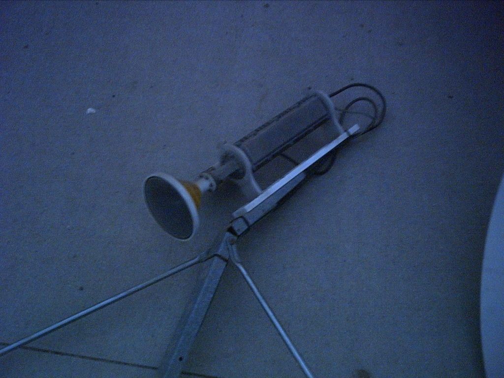

Mine must be different type of lnb holder arm. The dish is a round 39 inch dish. with a large heavy channel arm on the bottom holding the transmit portion and the receive lnb is on the side with a angle 90deg holder going into the transmit feedhorn. I just thought if he wanted to motorize it would be better to get rid of the weight of that large bottom arm. If he could find out where to measure from what part of the feedhorn.
I know I have read somewhere where you start the measurement from the feedhorn to setup focal depth at but can not find it again. Unless he could find a adapter for the feedhorn as the transmit part has about 10 allen bolts holding it to the feedhorn and the receive lnb only has 4 allan bolts holding it on.

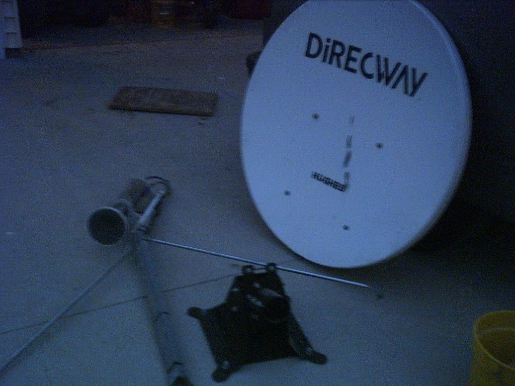

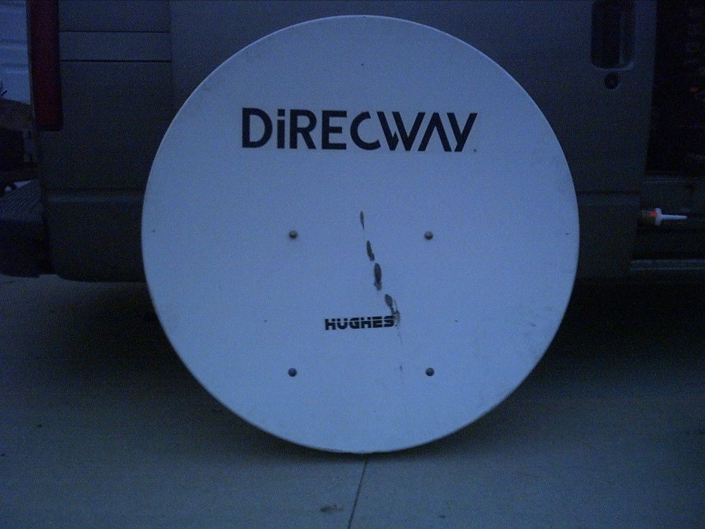

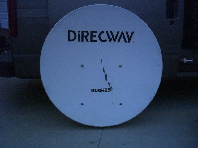

The dish looks like that but the transmit and receive set up is a bit different. see pictures. sorry for poor quality of pictures as night was coming on. I had removed mount and arms so I could get it down from the rafters in my pole barn. Your type dish would be alot easier for using for fta. The lnb arm and transmit section is quite heavy and the mount weighs in very heavy. dish is fairly light. good candidate for motor

is there 2 cables coming out of that LNB?
I do not think so, I took the dish and all down to a friends house so I can not go check. On my question on where you start measuring for focal depth I was wanting to know where you measure the f/d from. The beginning of the feedhorn cover or back where the lnb is bolted to the feedhorn. I measured my 1.2 dishes I have pictures posted of and both of my focal depths are different. The one with store bought lnbs is 31 1/2 from deepest part of dish and the commercial lnb that came with the muzak dish (both dishes identical) is 32 1/2 at the beginning of the feed horn and 35" back where the lnb bolts to the feedhorn. So the feedhorn is 2 1/2 " long.
I found a formula for f/d and I will see what it tells me if I can do the math proper. Been a long time since school. BOth of my dishes are 48 1/4 wide at widest part and 52 1/2 tall. and I laid a 6 ft flat bar top to bottom in the middle and found just over 4 9/16 deep at the deepest part of dish which looks like where the commercial lnb points to.
Ok, I found a web site that will figure f/d so I plugged in all my equations and it looks like you start your measurement at the front of the feedhorn. question solved. I am 1/10 of a inch off in my placement of the lnb using the commercial lnb. the store bought ones are a different breed and must be you have to guess at them!
