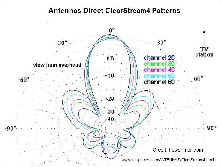

I talked to the engineer at one of the stations and we came to the same conclusion - it's slightly off and we'll re-aim it this week.
That is worth trying. The beamwidth of that antenna is very narrow, so aim is critical.
