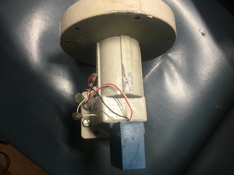

The dish's reflective surface is a wire mesh in the fiberglass. Don't be afraid to scrub it clean. Sounds like you have a Co-rotor feed horn with both a C-Band LNB and a KU band LNB. :) Very nice :)
Modern receivers do not have dish control systems built in. They do use DiSEqC to communicate with DiSEqC devices, switches and motor controllers. There also are no connections to control a polar-rotor motor in an old style feed horn.
There is one dish controller that can do it all and that is the Titanium ASC1. No others have polar-rotor control. But there are plans for simple electrical circuits you can build to control a polar-rotor motor. I have built a few of those :) An Arduino may be a little bit of overkill for the project ;)

I managed to get a few pictures, so here goes...
This is the dish, on its mount - half-way disassembled. The brush and grass around it was waist-high, but nothing that I couldn't tackle, armed with a razor-sharp cutlass and sheer determination :D
From what I can find, this appears to be a pretty decent assembly, complete with feedhorn, LNB, and polarotor ...?
