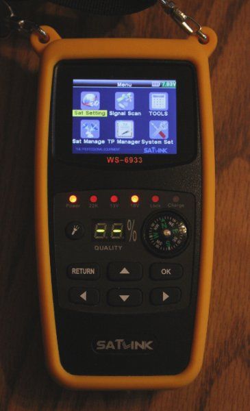

5e. Yes, multi-lnb brackets do work but would not recommend them to a beginner. They are a trade-off as you are aiming at signals off the focal point of the dish. As such they may be weaker and harder to find. Get a little experience first aiming dishes then experiment. As far as a meter, if you ask ten different FTAers you will likely get ten different answers. :rolleyes I use a cheap analog 'squawker' meter Analog Satellite Signal Strengh Dish Meter Finder Directv Dish Compass FTA Level | eBay to locate signals. These are subject to false signals though if you are in an area with a lot of terrestrial interference (power lines, etc) so they work better in the country. I also use a Satlink WS-6933 meter.
Easy to add satellites and transponders and it has worked great for me. :)
