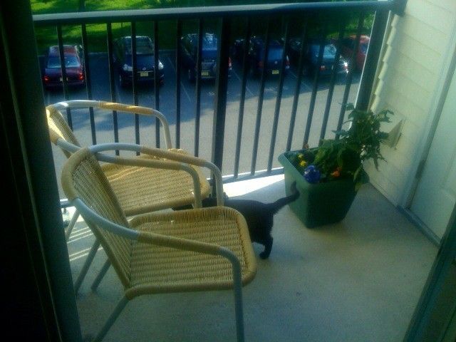

I'm about to place an order from solidsignal for a new HR21 DirecTV HD PVR, and want to get a 5-LNB slimline dish for my apartment's balcony. I want to make sure I'm ordering everything I need. Along with the above to parts ($99.99 and $199.99), and 50' of RG6 F Type Quad Shielded Coax from monoprice.com, I need a mount and - ANYTHING ELSE? (this will be my first install ever)
My balcony is about 6' x 4' (and does face south)...I'm worried about the footprint of the oft-recommended VMP FRM-200 Non-Penetrating Roof Mount - but can't seem to find good specs for the size of it. I'd LIKE to be able to still sit on my balcony in one of the chairs (but need to keep all parts within 'my space' to comply with the apartment's and FCC rules). Any other ideas? concrete bucket (if so, not sure how to do that / what I need), or OTHER smaller, yet sturdy enough, mounts? [PIC OF BALCONY ATTACHED]
I greatly appreciate the help. It'll be enough of a pain getting the Coax inside my apartment - I'd like to avoid the frustration of getting the wrong mounting supplies from the onset! Also, rather than the monoprice round cable I selected, is there any high-quality but easier to run (but not flat, which I read cannot carry HD) wire I can use?

that's really tight, a sled is going to take up most of that room, a Tripod with a cinderblock in the middle is probably the smallest/safest footprint.. but will still have a chance to move in winds. A pole with concrete bucket would have the same issue as a tripod.
They do make a Non penetrating rail mount, but the arm of the dish would be extending past the railing.
You could always make a "wood box" to a size that would work for you, cut a pole down to size and then set the pole in the concrete plumb. this would give you a wider surface than a bucket or tripod and you could make it a size that is not as large as a sled, and give it a dual purpose such as a foot rest/coffee table. But portability would be difficult.

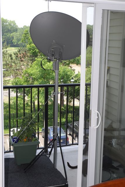

Thanks for the feedback, folks. Well, after a couple of orders from solidsignal and many Home Depot runs for odds and ends, I'm happy to say that my install is complete. Because I improvised many steps, in getting to a working non-permanent mount, I thought I'd share my photos of the build.
Note that I used the NPR6A Mount from Perfect Vision but did not use the mast that comes with it. Rather, I picked up a 6' fence post from Home Depot, cut about 1.5 feet off of it with a large diameter pipe cutter, replicated the original mounting holes with a good drill bit and - hence - got the extra height I needed to clear the balcony railing. I used the infamous 2" mount adapter from eBay to affix the dish on the smaller diameter fence tube. Because of the extra height I wanted to stabilize the structure somewhat, so I rigged up a guy wire from 1/8" steel cord and tensioned it up quite tightly; this also helped in adjusting the pole to get it plumb.
Notably, I had NO problems aiming the dish without an expensive meter. I used a $13 Perfect Vision "Sat Beep" in-line unit (from solidsignal as well) to rough tune the dish (maybe not ideal but it worked for me), then performed the fine tuning per ordinary instructions and using the receiver's signal meter (working off odd transponders on the 101/110 Satellites). My signal levels are very good - most are in the 90s/80s and I believe the lowest is in the high 70s. I get all my channels - HD looks great; finally my LCD is being fed the signal it was designed for. Could it be tuned any closer? Candidly, I think any signal improvement would be marginal at best, and I see no reason as the picture looks great on all channels.
