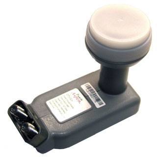

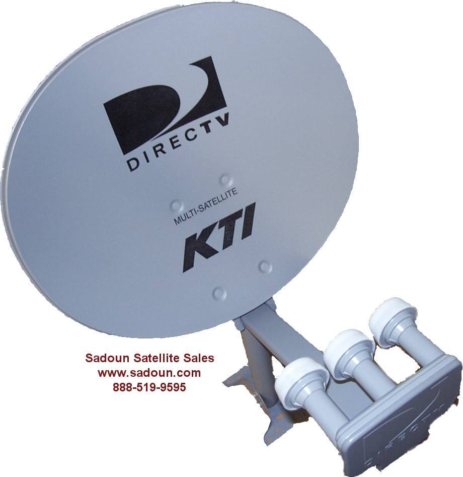

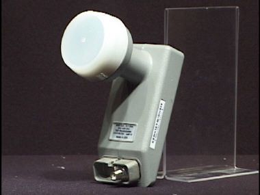

1. Single LNB (one orbital slot) / Single Output (Std 18" Dish)
2. Single LNB (one orbital slot) / Dual Output (Std 18" Dish)
3. Dual LNB (two orbital slot / PhaseII Elliptical Dish)
4. Triple LNB (three orbital slot / PhaseII Elliptical Dish w/ SAT-C kit)
5. Triple LNB (three orbital slot / PhaseIII Elliptical Dish, w/built-in multi-switch)
The newest ones you know all about.
