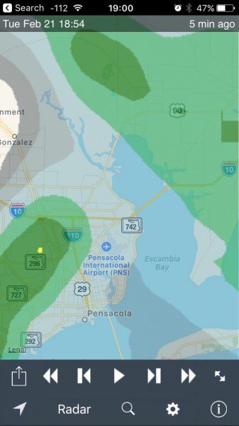

Most of you probably know by now I'm on my first c-band experience. Today is the first rainy day since I hooked it up and man is the rain fade waaaaay worse than I anticipated. I was under the impression that c-band can power through most rain. Granted I am on 7.5' but damn, its hardly raining and I'm on Pursuit on 87 and it is unwatchable. Clear sky S is 91 and Q is 77. Attached is radar view. Yellow to the south west of me, I'm in the clearer area in the middle.

This is what I am thinking also. Must be something else going on. I have never experienced rain-fade on C-Band unless it was a very heavy snow storm...or a transponder that was on the threshold.
This does not seem to be the case with you. Anyway the dish has moved on one axis or the other, water getting in on connections somewhere, or LNB not tightened and moved?
