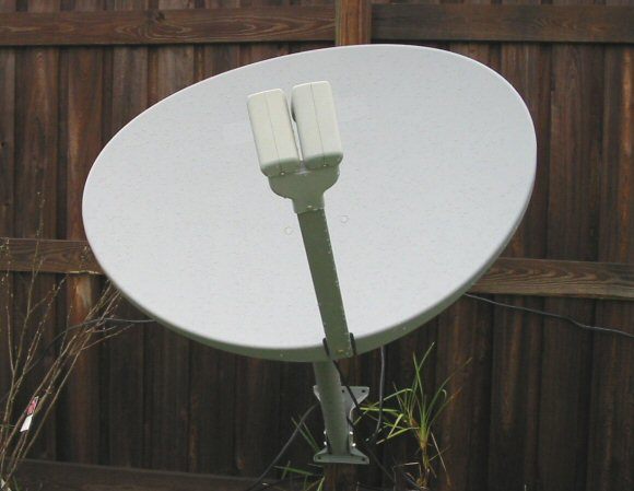

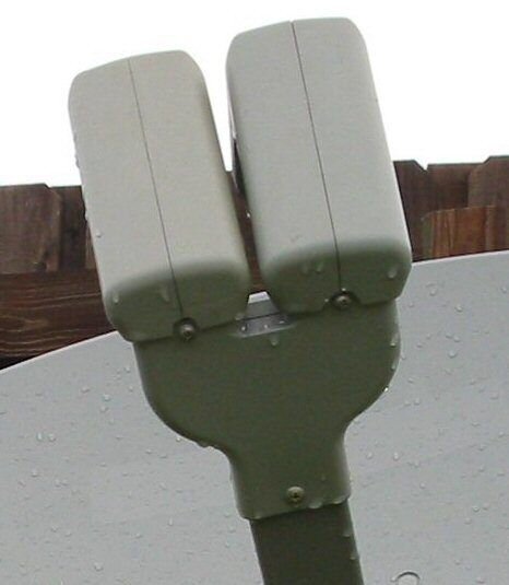

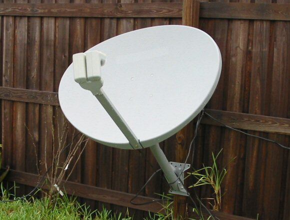

Well, hopefully anyway. Here in Florida we get quite a bit of rain and incliment weather which usually causes LOS on my Dish 500. I was playing around with 40"c-band FTA stuff and discovered the dish dual lnbf holder fits perfectly on my lnb arm of my Primestar 1m.
Well, right now there is a tropical disturbance heading our way and the past few days there has been considerable LOS events. So I mounted the lnbfs from my dish 500 to the new setup.
So far I have not lost one signal with this new setup. :) :) Of course it looks like overkill for dishnetwork but as long as the neighbors don't complain, I should be fine.
Here are some pictures of my setup.
MrM

What are you getting for signal? Pinned?
Just because it fits doesn't mean focal length and 9 deg spacing is correct. :)

But, I've lived in Florida, and either the grass will be up over the LNB within a month, or your dish will be full of lawnmower clippings!

If he chucked the Y adpater and put it directly on, it would be :)
Youd have to hose clamp the other one on, but hey it works....what kind of signals are you getting?
Just a FYI...rain fade still happens...it just will take one heluva storm/cloud cover to knock it out :)

If he's getting all of his channels, and hasn't lost a signal like he said in his post, one would assume the angles are correct.
One also has to assume he aimed the Dish using the "point dish" screen, and the signals showed strong levels.

If someone would do the math (or take direct readings), maybe there's an answer in sawing a couple of inches off the arm that would put the focal point on the LNBs.

Nice deal, looks to be about the same length as a superdish arm so he should be fine though he will still end up with rain fade though not as much as a 500. While I was in Pensacola 2 weeks ago when Rita was hitting west of us we got some incredibly heavy rainfall ( about 6 inchs in 1.5 hours ) that knocked out all the signals on a system I was trying to retune( 105 super dish ). Unfortunately the rain did not let up and the neighborhood I was in was starting to flood and the road in was sand and red dirt so I got out before I got stuck.
