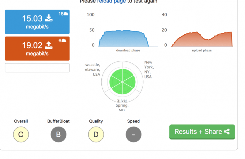

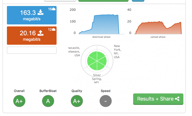

I attached two tests to show good and bad

Looking at your speedtest results it appears your router is not keeping up with the traffic on your network. This will for sure impact your on-demand services as they are realtime traffic. When you see a bufferbloat rating of "D" I can guarantee you will not get quality real time streams (VOD). Some services like Netflix have coded ways in their app to deal with buffering by either lowering resolution or other ways to compensate for these issues. I can't what DTV is doing for sure but I have seen other carriers including DTV not mitigate these issues as it's not the primary delivery of their service. In our case SAT is the primary and VOD is secondary so DTV can easily get away with saying it's best effort since they are not proving the internet to you.
I do suggest upgrading your router which was released in 2014 and has many complaints about issues with streaming etc. Pick one up at BB and if it improves nothing then return it but I am very confident this is your issue.
If you get 1036 pushed to you it will correct that condition -perhaps

When I ran the test I was backing up to both Amazon drive and Dropbox. Retests have resulted in a "B" rating on bloat. But you still recommend a new router? What about installing a new OS like DD-WRT on it? Do you think that would improve it?
Do you have an HR54 or HS-17? (DTV DVR)? need to know in order to answer how to update or have to wait.
B is better but run it about 5 times and see if you dip back down again (whats the average?)
Having clients use up the available bandwidth running things in the background will also cause VOD issues. This is where QOS comes in handy.

FYI, I just did a new speed test through DSLreports and buffer bloat scored an A. The system won't let me post a link to the report but you can just past this after the dot com in dslreports. /speedtest/29639620
Here it is for the rest of the folks since you can't attach it. Results look very good and ideal for streaming but as you noted it didn't fix the actual issue but looks to have cleared other issues. Don't give up now, your'e close :)
Try to directly connect the HR to the router to eliminate any DECA issues, if that doesn't work the issue is beyond the router, could be provider which I doubt after seeing the last test result. Also you are on the older software / GUI, I can't say for sure but maybe upgrading the firmware to 0X1036 will fix it, it's in the stream as of late M-F 3AM to 7 AM ET.
