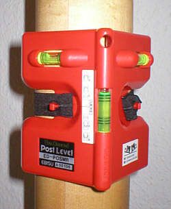

postlevel.jpgThe mast may be plumb, but I wouldn't trust the bubble level in it. Use a post level like the one in the picture instead. Check the adjustment settings for skew and elevation. Then point the dish according to the azimuth numbers. Sweeping is slowly moving the dish, giving time for the changes to register in the menu. The bottom line is this should have been done when your dish was installed. I would call Directv and have them fix it.

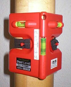

View attachment 75518 The bottom line is this should have been done when your dish was installed. I would call Directv and have them fix it.
