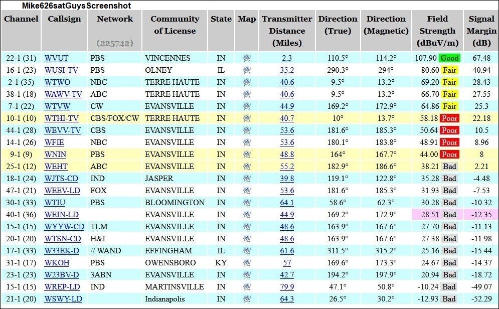

Thanks rabbit73 - Here is the signal report for my location. Shows the same as yours. Could the added cable be giving me loss of signal? I thought since it was a very short added length - It would have little effect? Do you think it would help to install new RG6 coax- without any cuts? Or preamp or amp? This is a problem that I surely thought I would not have. Also when I tested the antenna inside - It was only about 8 ft. from the outside tower. Thanks for your help - Mike626
Thank you for the image of your signal report. I had hoped for the link to the report or its ID number so that I could click on a callsign for additional information, but I think the image will do for now.
I don't think the short added cable is the source of the problem.
If the original coax is damaged or defective, new coax would help.
Or preamp or amp?
No, don't add an amp; WVUT is already strong enough to cause overload.
WVUT is weaker with the antenna inside. But, we still don't know if the cause of the problem is because WVUT is so strong, or if the connection between the outside antenna and the TV is defective. You could try adding an attenuator in the coax.
You have a difficult location for OTA reception. Your signals are in different directions and there is a great difference in signal strength between the weakest and strongest signals. The strong signals make it more difficult to receive the weakest signals.

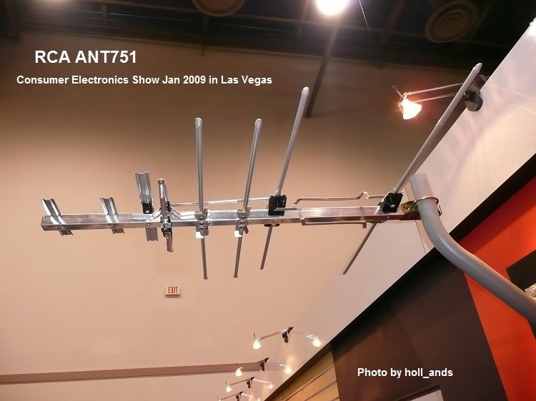

Please tell us which RCA antenna you have and the direction you have it aimed. Here is a photo of the antenna I have. I have it pointed 10 degrees off North going East. Pointed to Terre Haute. It is only the Stations of WTWO, WAWV, and WTHI I want to receive. When I was testing the antenna inside. I was getting all 3 of these stations. Even WTHI which should be the most difficult. But now with the antenna mounted off side of tower. None of the stations come in.

Is that the RCA ANT751-something? What's the present LETTER on the end? I had one of those I installed for my dad. Turns out the flat bars that swing back and connect the two pieces of antenna together, can be connected wrong, even though they look right. IF you connect them wrong, it cuts the received signal way down.
Try taking some real good pics of that connection point, and post them here for us to check.
