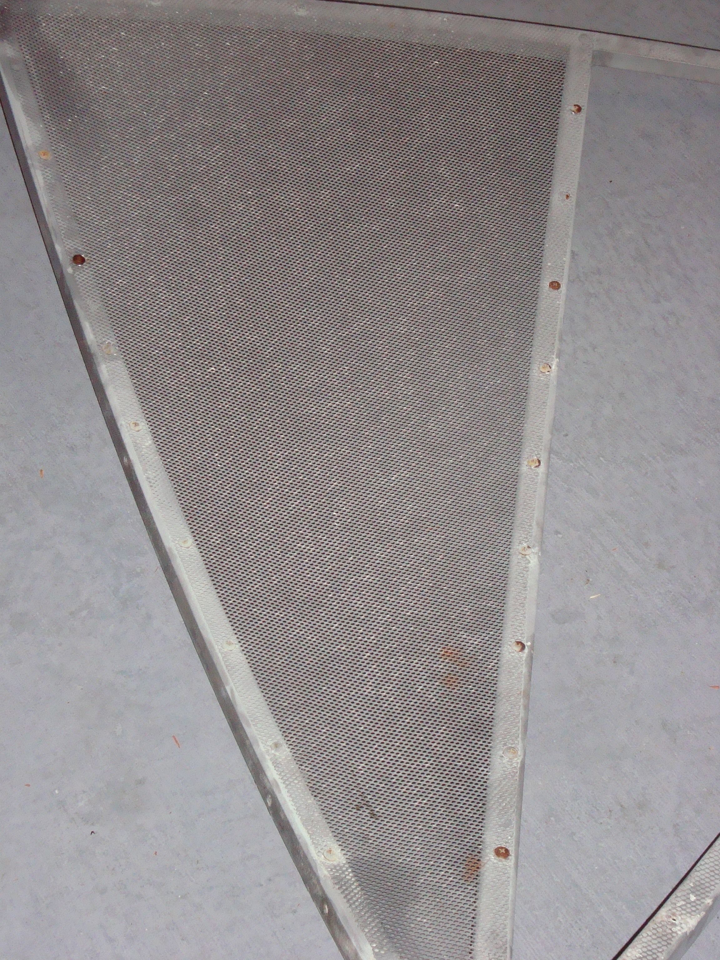

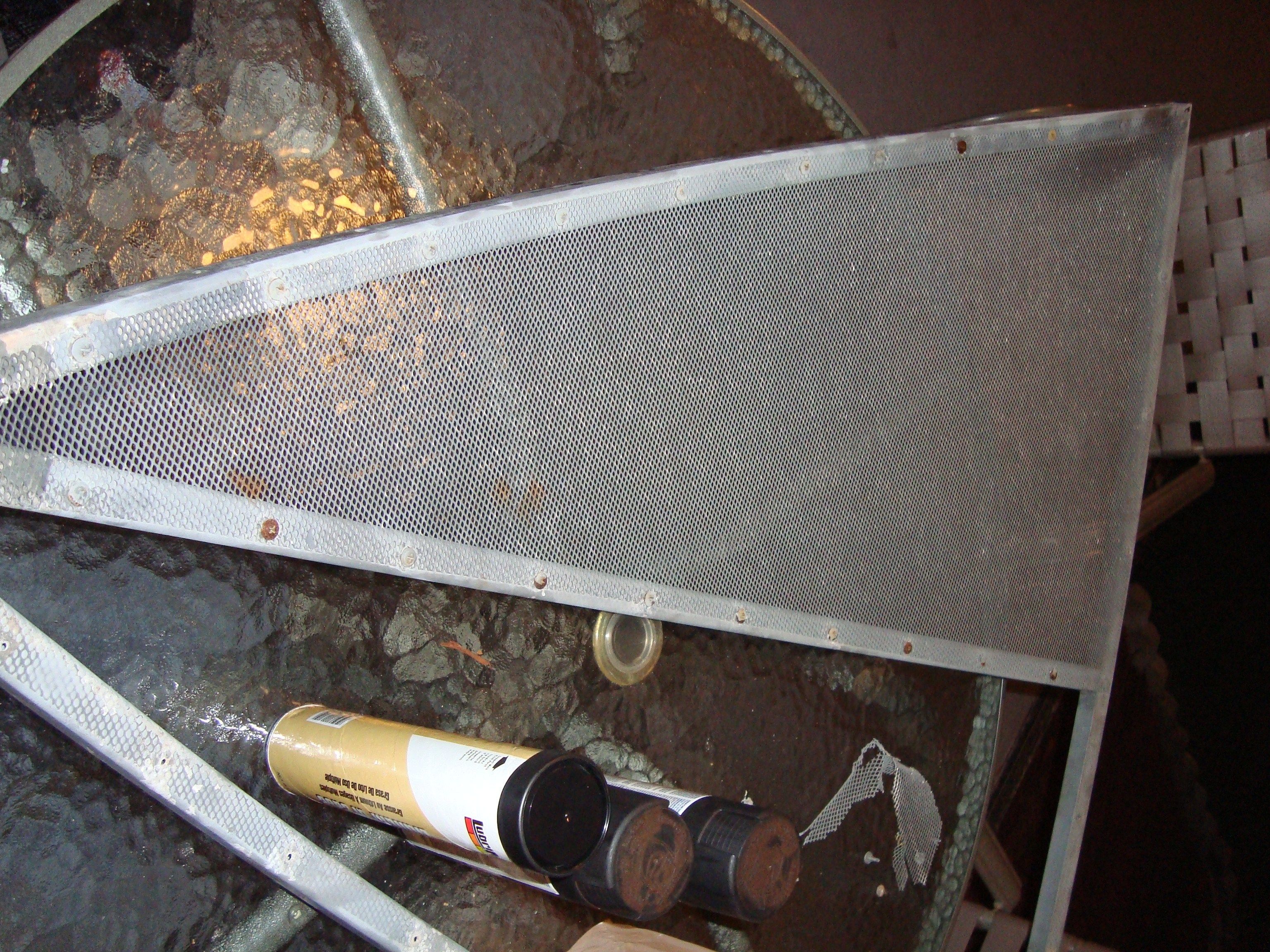

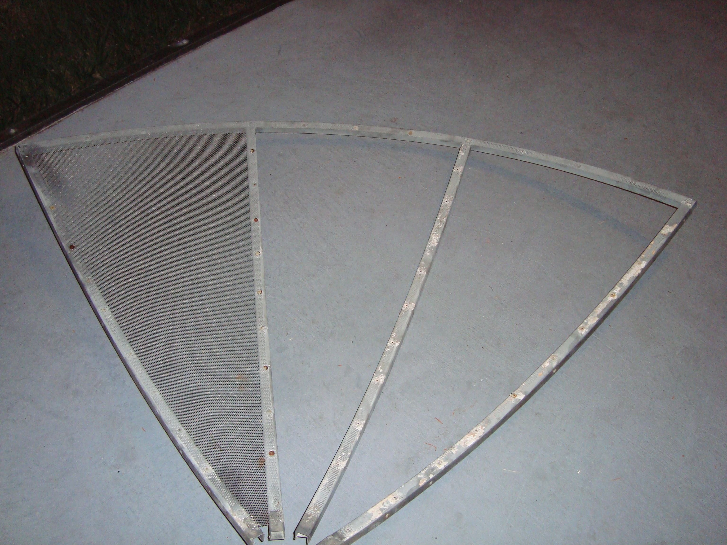

Let me know if these pictures help? Also this is a total newbie question and I am sorry for asking it. Would I still be able to get signal with this dish and the missing mesh? If so about how bad would the signal be?

Unless the dish uses the stressed panels for structural rigidity (which it may), I'd fire it up with a few missing panels!
You will have a little loss of signal (which should be fine), but still have the accurate focus (if it holds shape).
I think a Paraclipse would hold its shape after having its panels blown out by a nuclear blast! - :cool:
Oh, and maybe a bit more ground noise.

When I installed my fourteen foot paraclypse, I raised the dish to the pole without having installed 1/4 th of the mesh. I did it that way so we could lift that monster to the mount. That evening I watched C band even though the mesh was not yet installed.
There will be a significant signal loss, and I would think the smaller the dish, the more noticeable the loss would be because of adjacent satellite interference and lower gain overall.

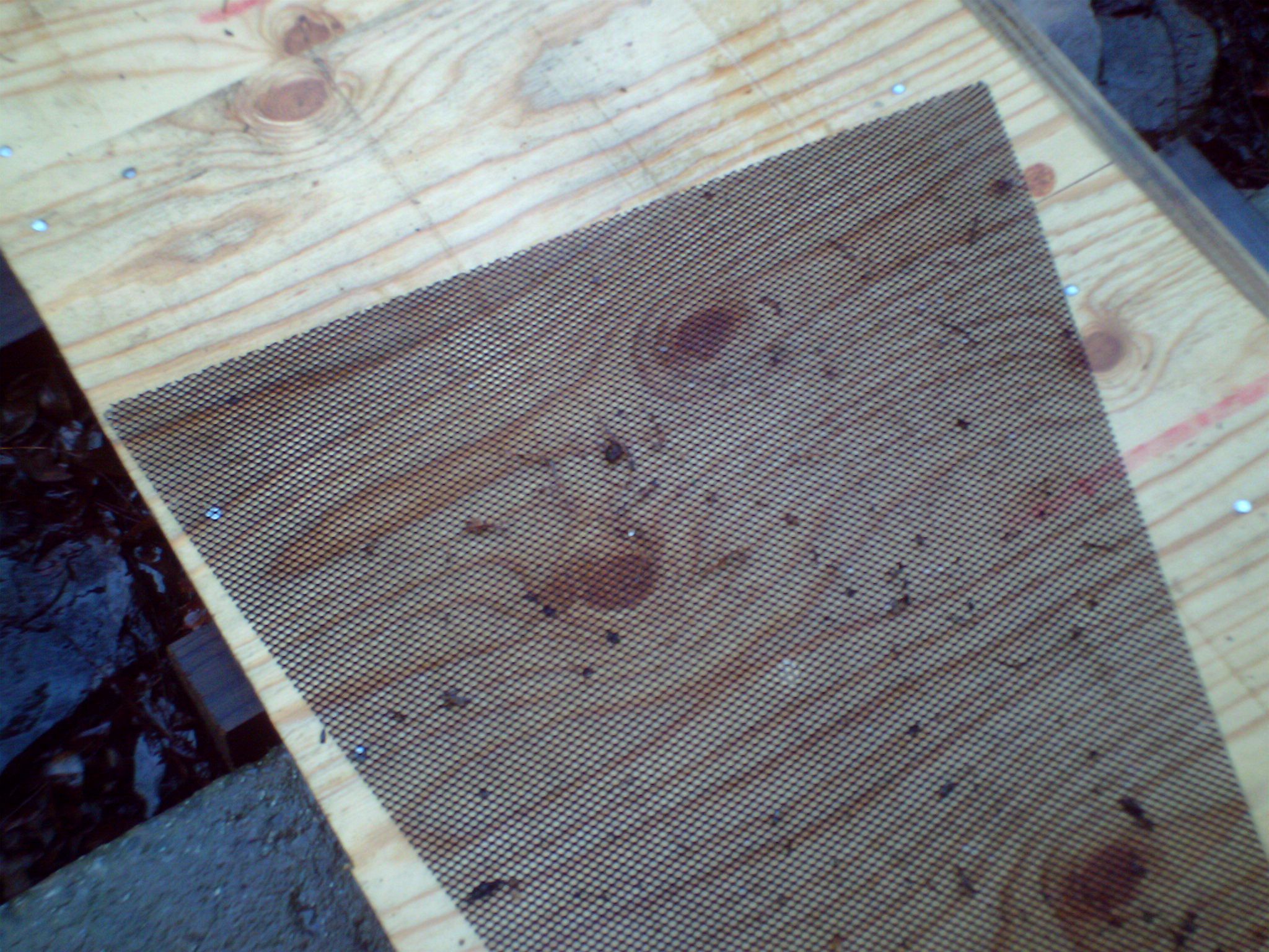

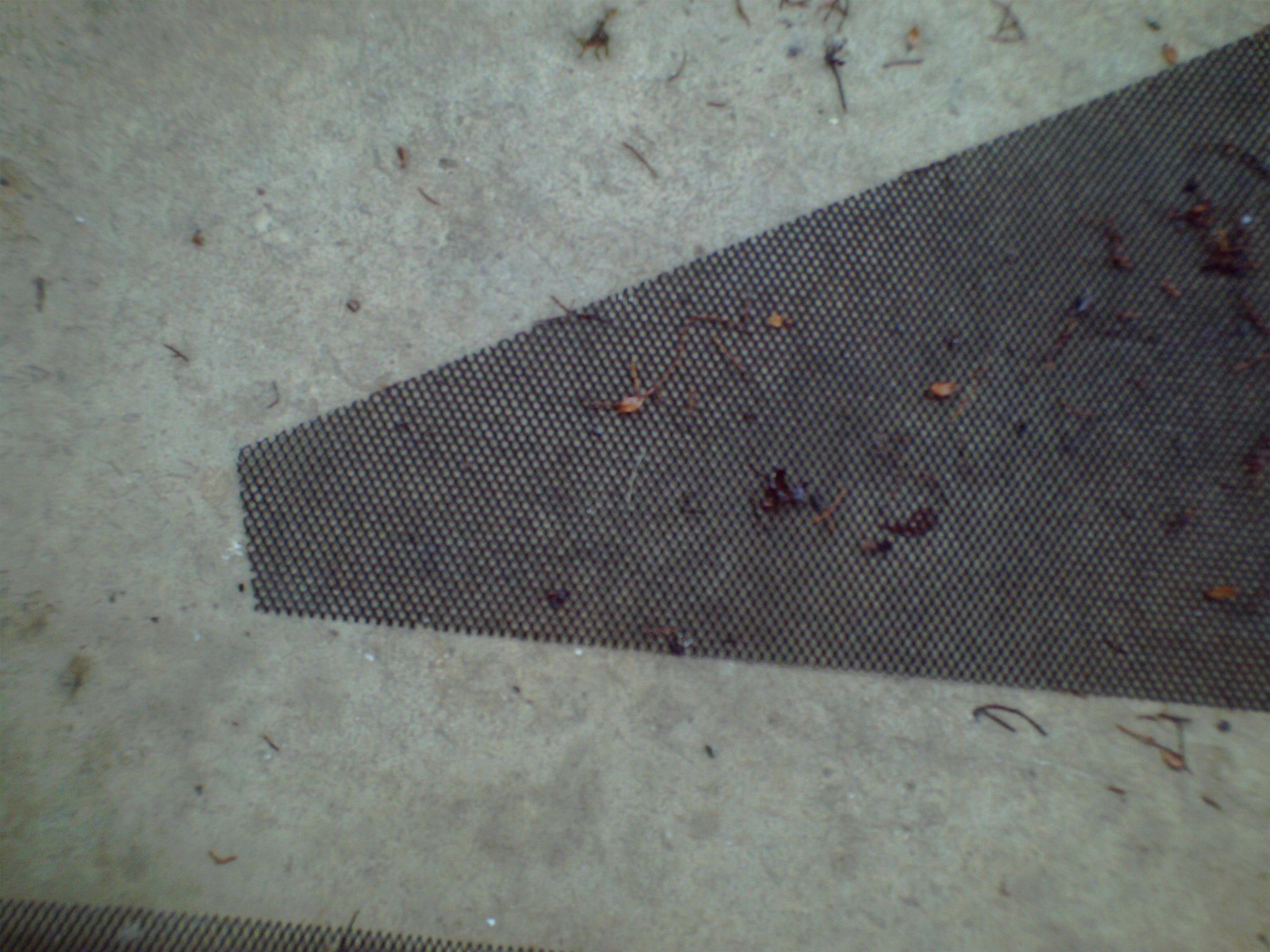

Here's a half-@SS blurry pic or two of this stuff I have:
It's metal, aluminum I presume. Mesh from some old dish's I had, some broken down.etc.
One was a 10' oddball brand, another was a 8' Janeil Dark Star, I also have some from a 12' Dark Star that broke down last year, ribs cracked, etc fell apart mostly but the mesh is good (for c-band only on that one)
You need some mesh? PM me
