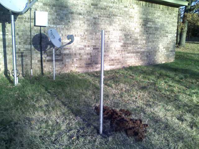

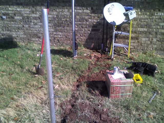

Hello, everyone. I ordered my first free to air set up from Sadoun. It will be here on Thursday. Hopefully I'll be up and running before I know it. Ha ha. I am taking pictures of the install. Here are my first two. :D PIC-0142.jpg
Well I think I put some pics up If not I'll redo it in a bit.
Yes it is a motorized unit. I ordered the 90cm dish, fortec Dynamic, and the upgrade lnb. I can't remember I think it is a dual lnb. As far as the shadows, those trees are way off to the west. My southern view is pretty good. I cant go to far eastward from due south, I can go westward quite a bit. I have got alot of old, (tall) oak trees on my property. I am excited though. I hope everything goes smooth. I'll take some photos of my due south and post.

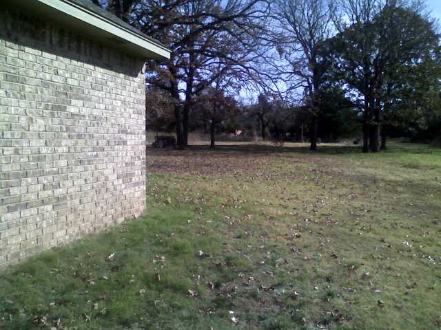

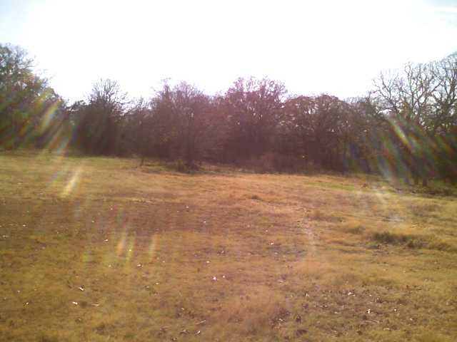

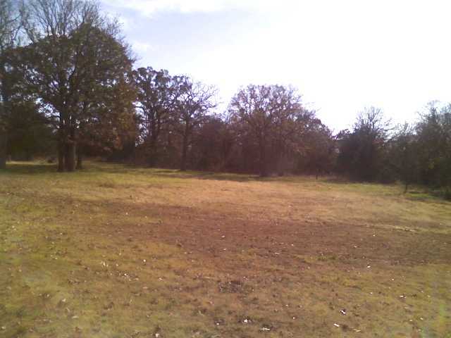

Ok here are my views of the southern sky area. The south and southwest views have trees that are about 300 feet away and probaby 50 feet tall. I think I should be ok The South east view is my worry. I am located in Oklahoma and dont know how many sats are towards the southeast. I guess I'll know in a few days.

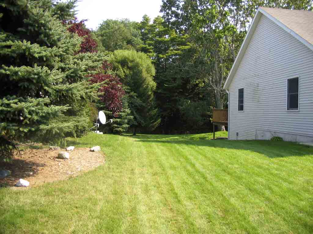

Here's a pic of the south side of my house , and my dishes. You may not have a problem. I don't have any problem clearing the house next door. You, being more south, will have an even better elevation angle .
