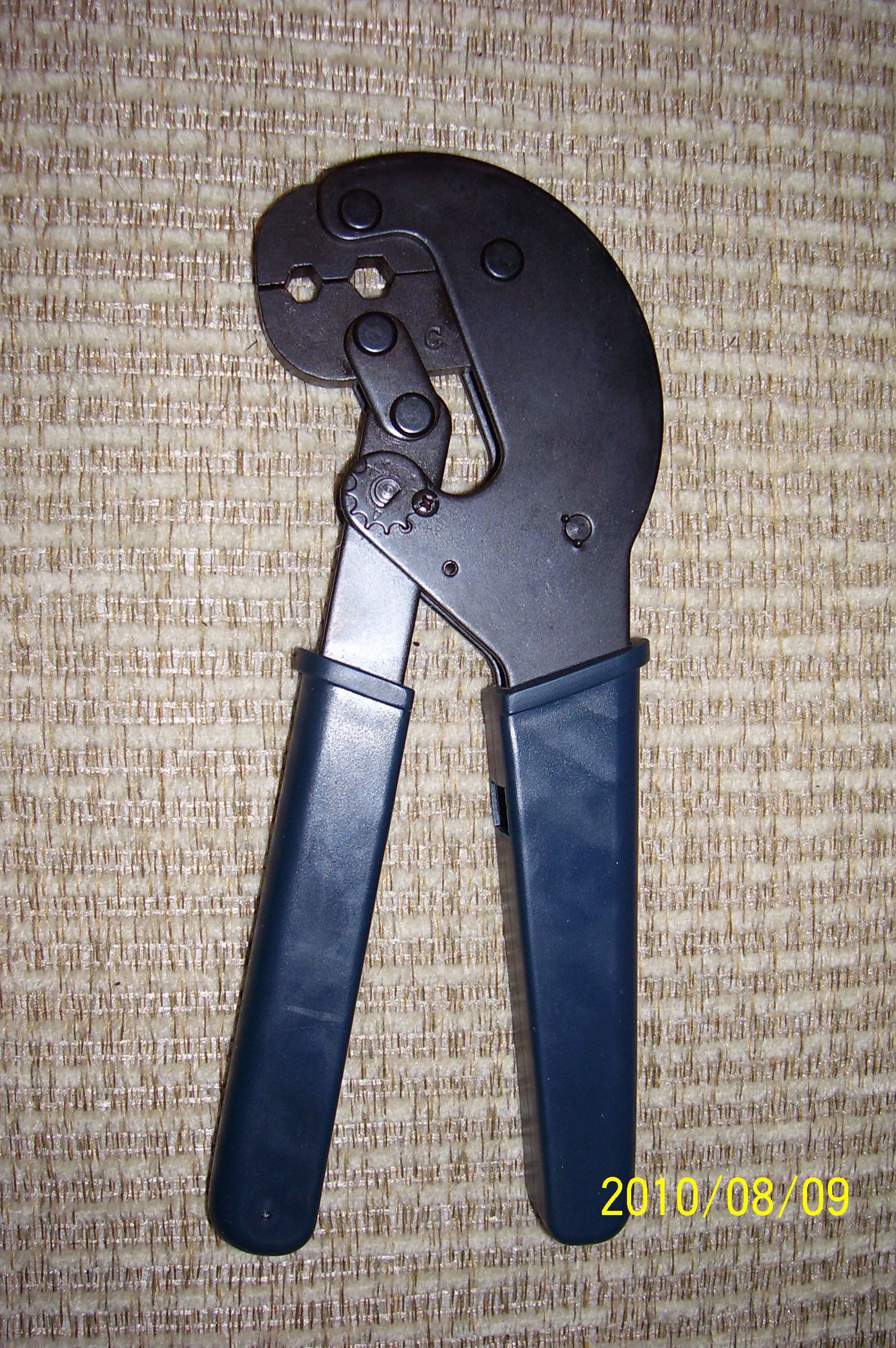

To FaT Air,
Hopefully here is a picture of my crimper.
I gotta break down and buy a new one, Where once was the adjuster to set the tightness, I have welded. I think I've gotten my moneys worth out of it.(Mine's red tho)

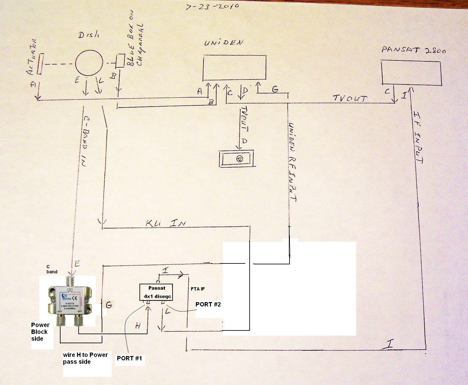

So I connected the wiring for the KU-Band. Nothing came in then. No C-band or Ku-band. Changed the Pansat
diseq switch with the one I got with the new 250sm. Still no C/ku reception. I then unplugged the c-band and
plugged in the KU band. On amc9 (83d) I got stuff from Bloomberg and not Tuff TV which is supposed to be
on Amc9 KU.
Have no idea what's wrong. Think I followed Fat Air diagram correctly.
But being the novice I am who knows.

First check programming of the 250SM-
If you have the disqc switch installed and both the C and Ku coaxs connected to
the disqc switch. You must program the 250Sm to select the proper port, for which band you're after. C band operation may work on port #1 even with improper programming. (it does om my disqc switch,[with a very slight degredation in sensitivity])
Another thing that will cause a no signal condition, is the feed focal legnth being off. It's very sensitive on a BUD operating at Ku frequencies. Much more sensitive than C band. You may have to adjust it to optimize Ku operation.
Another common possaiility is that you may have to bump the dish left or right, with the actuator, a click or two. to get Ku.
Then, when you get Ku working as best you can, another go-round of elevation and azimuth alignment, on Ku band, is in order. This is because the BUD has a narrower beam width at Ku, than on C band. Usually about 1/4 the beam width of C band.

I am following Fat Airs latest diagram in post #94.
This has both C and KU plugged in. This way I get no signals whatsoever.
I can find no setting on the Pansat 250sm to make it go one way or the other.
I assumed that by programming KU or C made it go to the proper place.
I do get signal from either one when connected separately.
What KU I have gotten so far seems to be pretty good.
