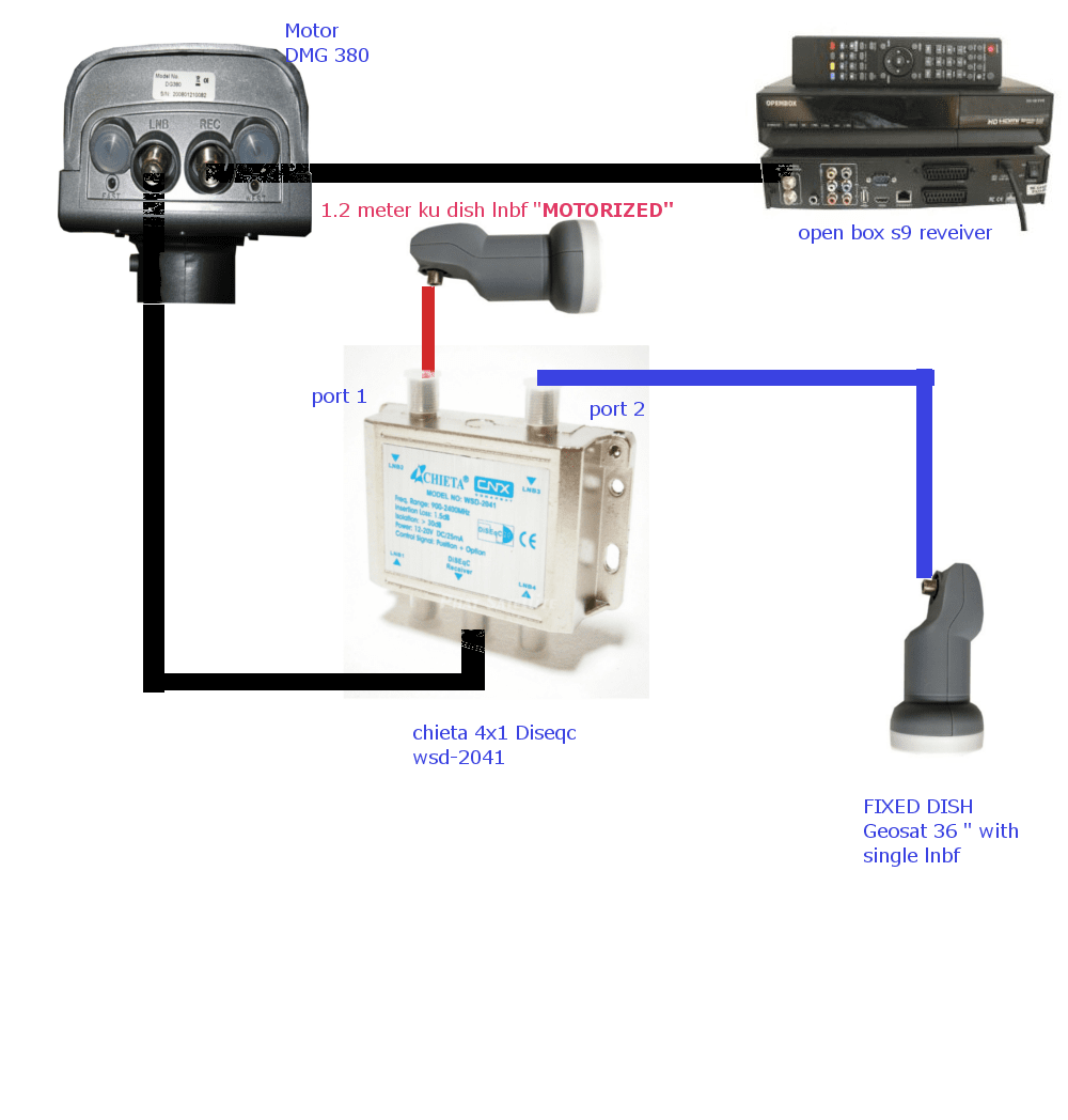

Give us a drawing of your wiring setup exactly as your system is laid out. I'd have to say with the little you've given us that it's a wiring issue, or something in that part of the system. NOT a receiver. A wiring diagram should help in diagnosis
I'm with primestar, something suspicious there in the wiring or switch, perhaps. First thing I would try, take the tv/receiver out to the dish and wire it direct to the lnbf and see how it plays those channels. Or try another diseqc switch if you have one, if that's easier to do first. I've gotten low signal on those RTV channels before but never had a receiver lock up because of it.
This is the picture I made for you from another post different topic/question. This is my current set up now. My tv is plasma and 1080 . On the receiver it is set for 1080i_60, No auto setting. I know that my switch is fine. By the way this problem of freezing existed long before having the addition of a diseqc switch or my fixed dish "both new". It also existed before using the motor I have now. Receivers hooked directly to dish It still happened.

You can try temporarily bypassing the switch and connecting your motorized dish directly to your LNBF to see if you are still getting this issue as the switch could also be going bad.
OK. the rca cable thing and lowering to 480i did not work. It still froze. As far as wiring its awsome. All new and good continuity. The cable length is around 90ft not including inside. I am not going to temporarily bypass the switch and connect the motorized dish directly to the LNBF because I know for a fact that it will still freeze "because it was".
As I mentioned earlier this problem existed Prior to having a second dish and switch. So bypassing the switch and connecting the motorized dish directly to the LNBF opposed to having the lnbf connected to the switch was my original set up. It froze then. I have just dealt with the problem. I just don't want to anymore.
