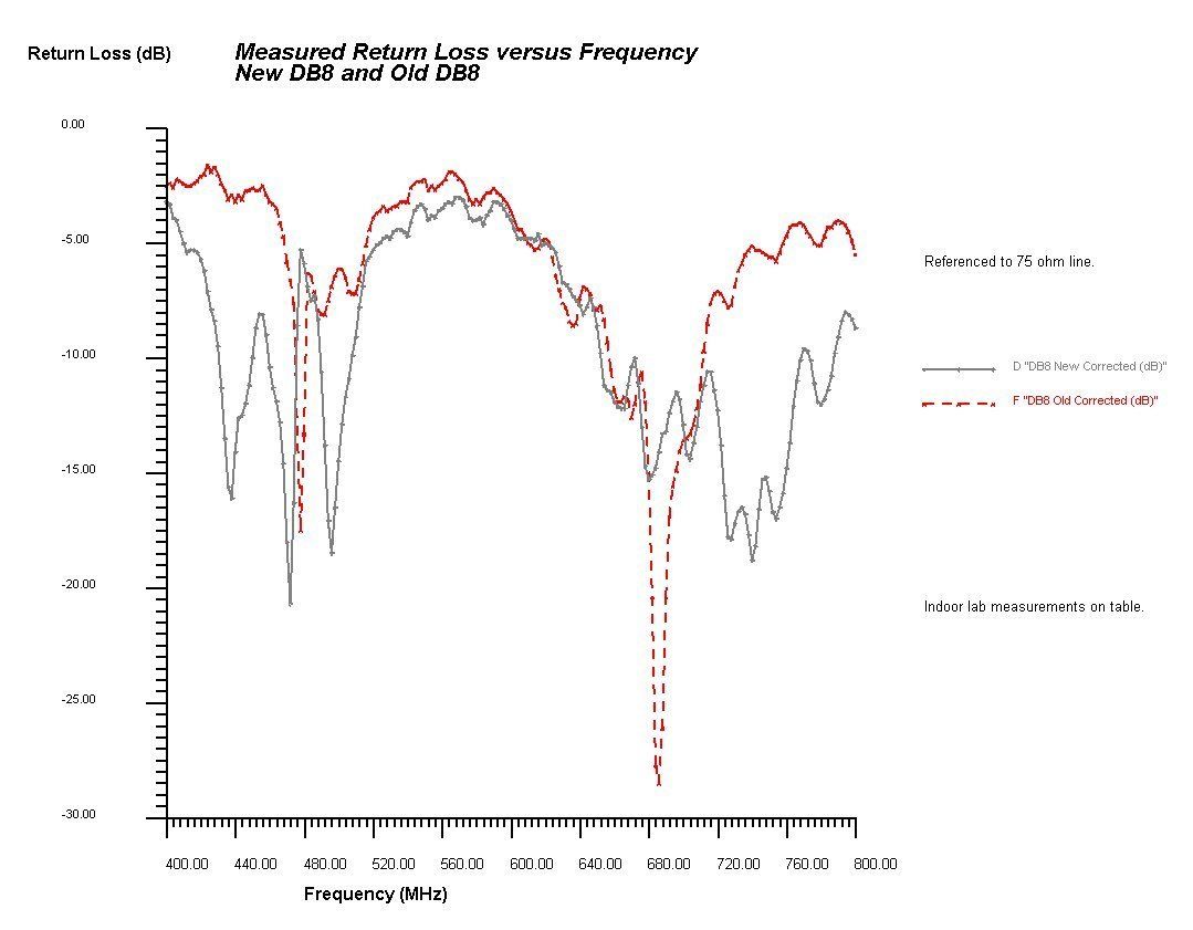

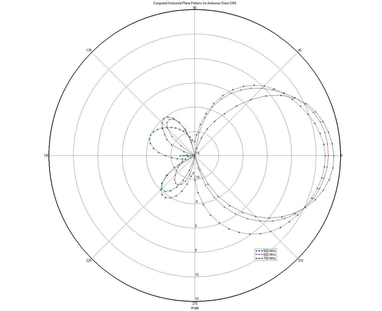

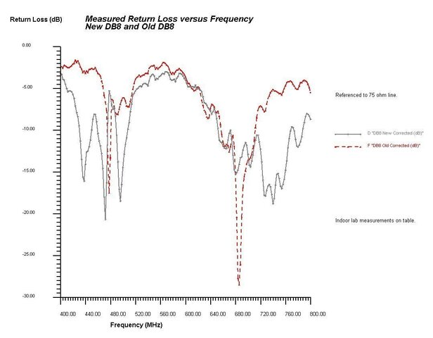

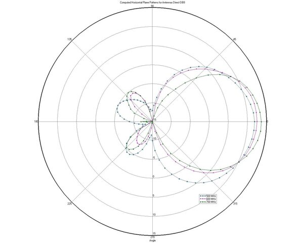

I received specs from Antennas Direct on their DB8 UHF antenna (attached) and they look impressive according to the RF engineers here at work. Due to it's size, appearance and being able to mount onto a "J" mount for easy installation I'm now leaning towards purchasing this antenna instead of the 91XG. I'll probably purchase the 91XG for myself at some point, but for my mom it would be too big and unsightly.

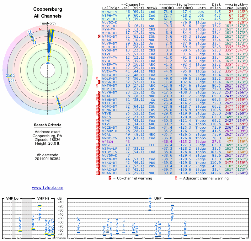

Attached is a TV Fool's report for my mom's location. Thank you guys for the help and advice.

A DB8 is a decent choice for the fringes, but it won't be any good at all for VHF stations such as the NBC and CBS affiliates out of Scranton and the ABC and PBS broadcasts out of Philly: Its balun (located where the cable connects to the antenna) filters out anything that's not a UHF (channel 14 and up) signal. You may be able to make the DB8 capable of receiving the UHF stations in both directions by putting it up without its reflector screen, but this will weaken gain somewhat.
As for the VHF broadcasts: If you're sold on a DB8, you'll need a big, separate VHF antenna such as an AntennaCraft Y10-7-13 and a UVSJ for combining signals from the two antennas onto one downlead. Even this approach has issues: You'll need to get a rotor for aiming the big VHF in both directions, or you'll need to choose one direction over the other, and this antenna won't likely pick up WPVI (ABC) out of Philly. To get that one, too, you'd need to get an even bigger, channel 2-13 model.
In short, that valley makes your mom's place a rather tough spot for terrestrial reception.
A UHF antenna on a j-pole is not going to get her much TV. You can try it and see if signal is stable in the daytime.
Another problem is ABC WPVI is on channel 6 and even the Y10-7-13 will not pull that in.
I recommend a Winegard HD8200U for VHF and your DB8 for UHF is OK. Combine them with a UVSJ.
Getting the antenna up 40-50 ft will more than double the signal received at the antenna, maybe multiples of 4 or 8 times the signal at 20 ft.
A preamp might be problematic because you have 3 full power stations less than 5 miles from you - maybe a Winegard HDP-269.
