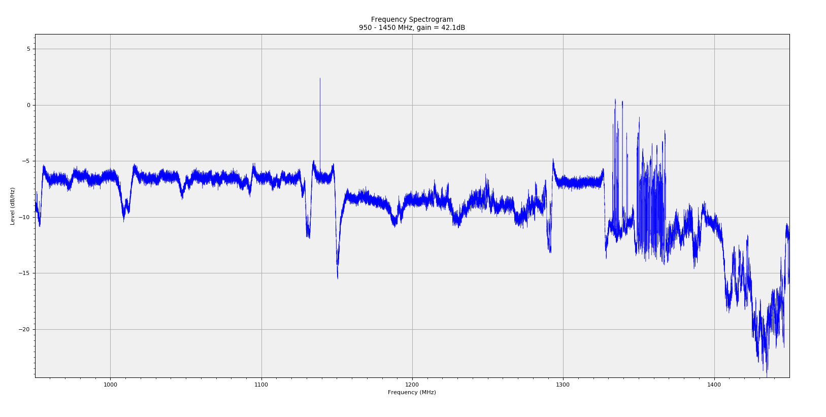

I used my SDR with RTLSDR Scanner to get a spectrum scan (understanding that the RTL SDR has its own limitation and can be easily overwhelmed by interferences). This is what we saw:

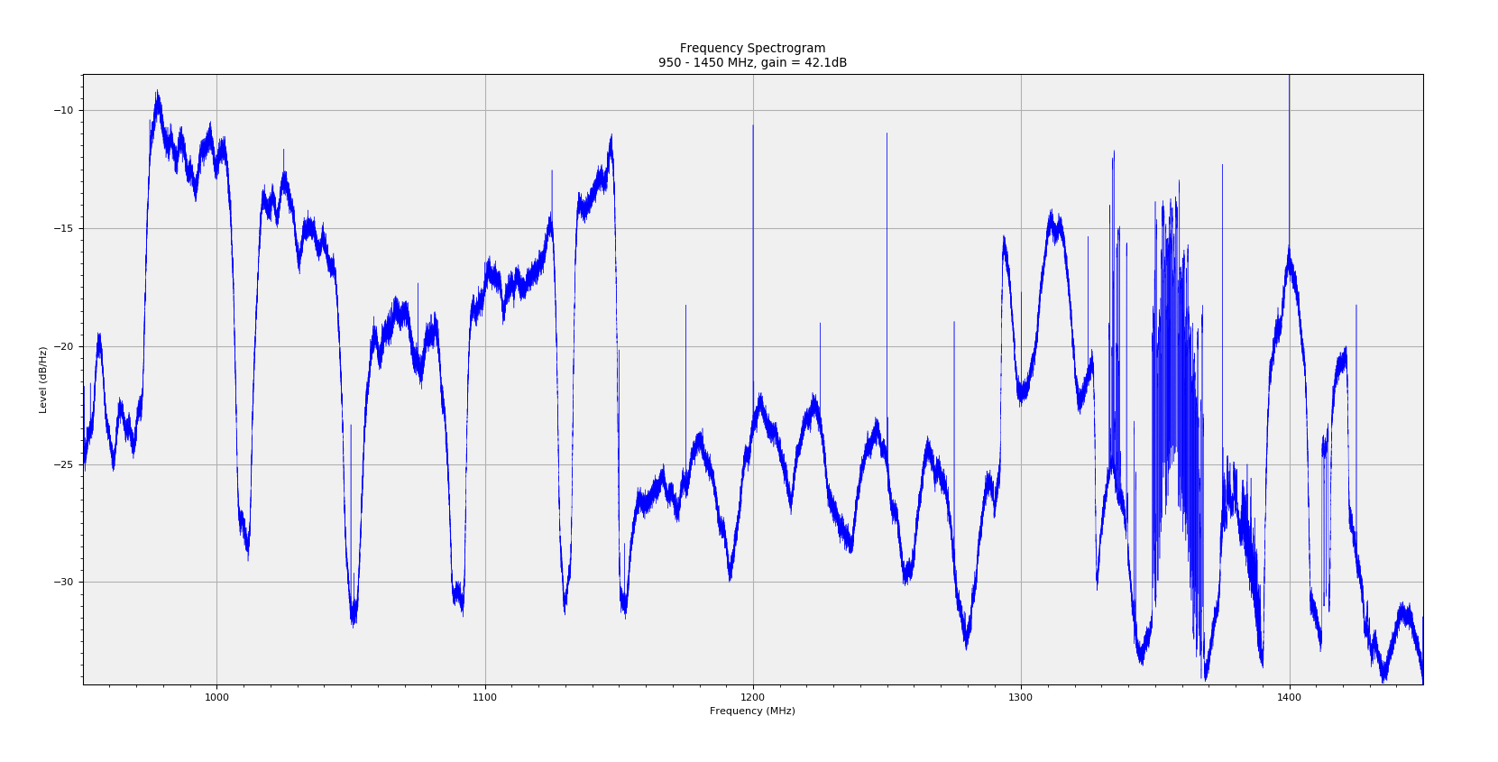

for comparison, when scanning from my own location, about 20 miles from there, this is what I get (with C2-PLL LNBF, a Diseqc switch and a lot more cable length, and aiming trough tree branches). My location is more rural.
My suspicion is on 5G interference but I'm not seeing any outrageous signal in the 1350-1450 part of the L-Band spectrum...
thoughts? Any suggestions on what to try next?
