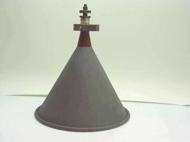

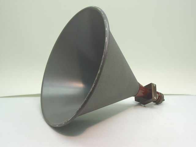

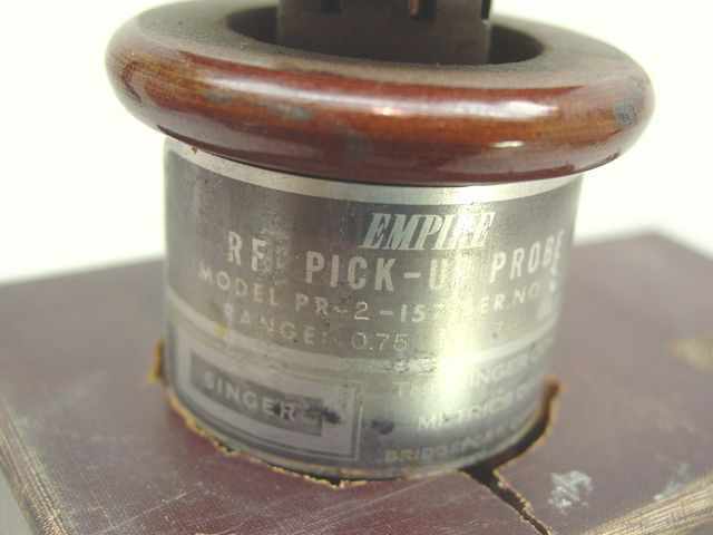

And yet another way.......

There is a program for designing Cone Feedhorns that Casser used. Google Paul Wade and download a copy of hdl_ant. It does the design and creates a pattern to cut from.
More on Cones...... and spheres of sugar, Adam;-)
