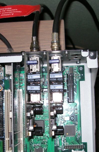

I like the Reelbox multi-tuner capability and with two DVB-2S tuners and a dual orthogonal feed x 2 lnb(s) connected, one H and one V bring down HD on C-band transponders. For cable, I asked them why not support the US standard, but that was not to be. I went as far as removing the DVB-C tuner from it's circuit card and replaced it with a pin compatible annex b tuner to receive ITC cable [without success]. The original designer thought it should have worked. There is still support out there, in German and some English. I got mine from a UK distributer who helped me set it up.

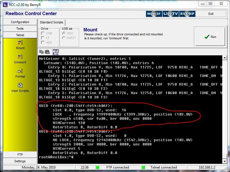

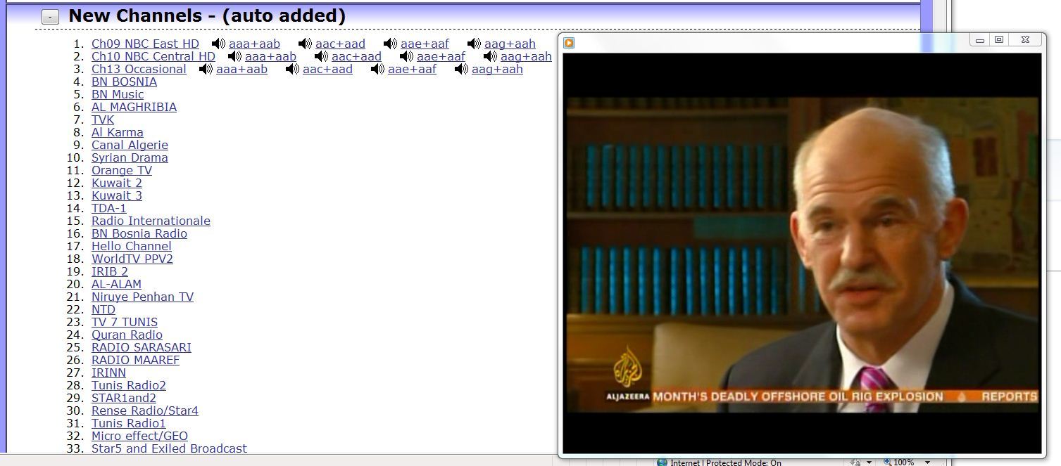

Posting some pictures for those who might be interested. It's a cool box; streaming video server from the tuners, shared hard drives, a lot of 3rd party tools support. As mentioned, I soldered an ATSC annex b clear QAM tuner, the (North America) version of a cable tuner to a Reel board. But Even though the AVG, aka Reelbox are open source--the integrated Netceiver design and sw is proprietary. If I had a ATSC annex b QAM signal generator I might have figured a way to get my clear cable on it too. DVB-2S_97W.JPGDVB-2S_lock.JPGh_v_cvr.jpg
These are screen shots of the network interface, a tool created to talk to the box and tuner slots of the Netceiver.
FYI.
